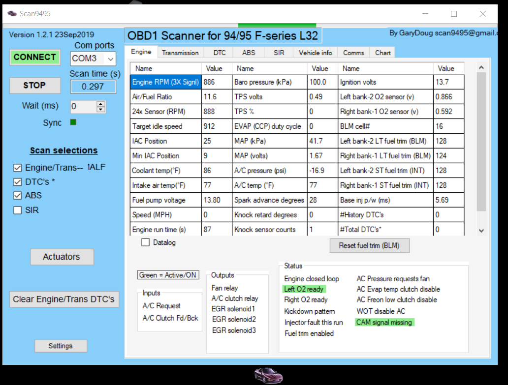

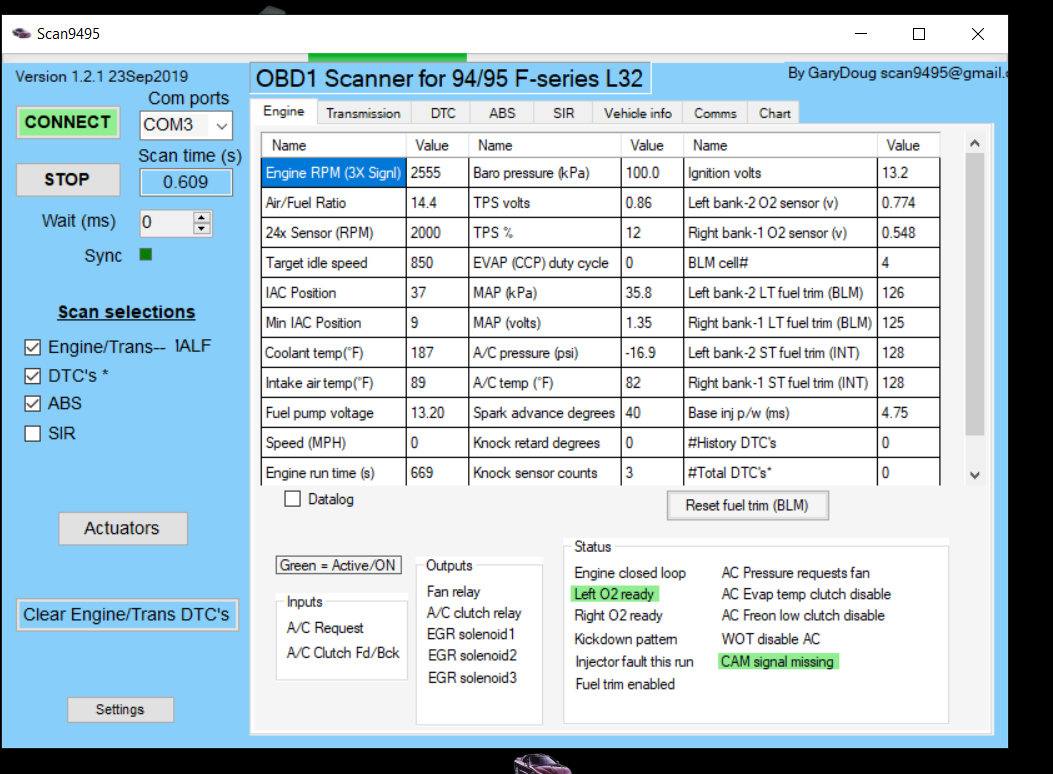

No, I wish there was a code. Then, I would know what to do. I've got some sluggish behavior when accelerating at higher speeds which just feels fuel-related. I just grabbed these app pics below yesterday and I'm slowly interpreting data in Gary's app this morning. The data log below that just looks like old school machine code :/. I don't see where log data shows fuel parameters. I'm guessing, given the obvious redundancy, that just a few "paragraphs" of log data is all that's needed for a quick assessment instead of dozens, no?
Re: trim values (according to Fred):
"The fact that the "lt fuel trm r: = 124 " would indicate that at idle (as indicated by "lt fuel tr cl = 16", the correct fuel trim cell for idle) the right bank O2 sensor is not indicating a lean A/F ratio. but actually showing a slightly "rich" condition, which the PCM is addressing by reducing the amount of fuel it would normally deliver by 3.1%. "
So, evidently, 4 points matters. Why the PCM needs to do this may be a clue.
Obviously, both scans below are from different rpm's while non-mobile. I'm going to go mobile later to get different and, hopefully, better data.

Non-mobile data:
  • MAP (36-42) - normal
  • Spark adv (28 idle/40 at 2500 rpm) - normal
  • O2 voltage (.55 to.87) - normal
  • The "target" A/F ratio of 14.4 after warming up looks good (at idle) - normal
  • IAC is between 20 & 40 (25 at idle and 37 at 2500 rpm) - normal
  • Fuel trim on BLM LT behavior questionable on both banks (124-126) & injector open for 4.75 & 5.69 ms idle & at 2500 rpm's. Short term both normal at 128. ***I don't know how many milliseconds the fuel injector pulse should be open for just yet-just started researching. TBD.***
Mobile data:
TBD.
I don't know how dynamic each variable of data becomes when going mobile. It will be interesting to see which bits mattered for diagnosis.
