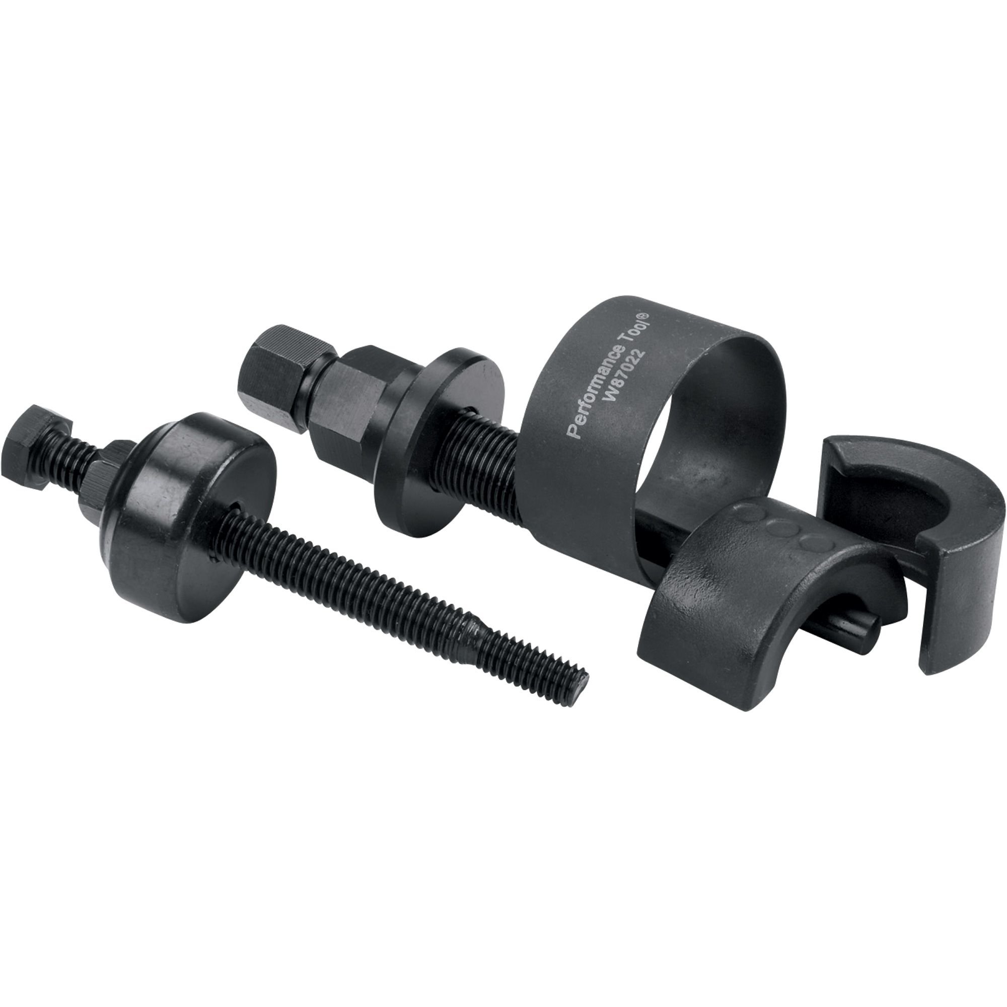

got new problem. manual says use puller to get pulley off power steering pump. i put so much pressure on that puller and it wasn't even thinking about coming off. then i noticed puller was bending outer edges of pulley. any ideas on how i can get that off. puller doesn't seem to be working. thanks...
Old Sep 5, 2019 | 10:37 PM
Sounds like you're using a gear puller, which will bend or ruin the pulley. You need a p.s. puller that grabs the hub...

Autozone has the puller in their tool loaner program
