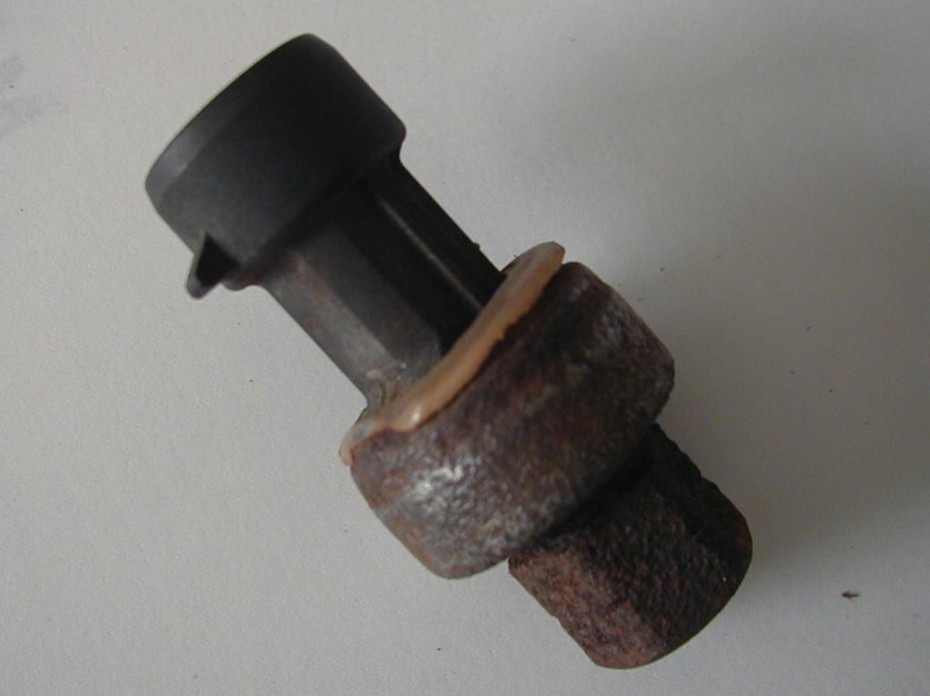

Worst case, as far as I'm concerned, would be a leaking evaporator due to the labor involved in replacing it. Ugly, ugly job. A bad compressor would be an expensive part to replace but a leaking front seal isn't the usual failure. A leaking condenser is also a nasty labor job since the cooling system has to be drained and the radiator removed.
Craby is right, though, the AC system contains several ounces of oil and when the refrigerant leaks out, so does the oil. The oil is visible and attracts dirt so follow the pipes and hoses, looking for that. Hopefully you'll find a simple problem.
My 94 was losing refrigerant due to a failed high-side pressure sensor. The design changed a bunch of times and now there's an improved part.
