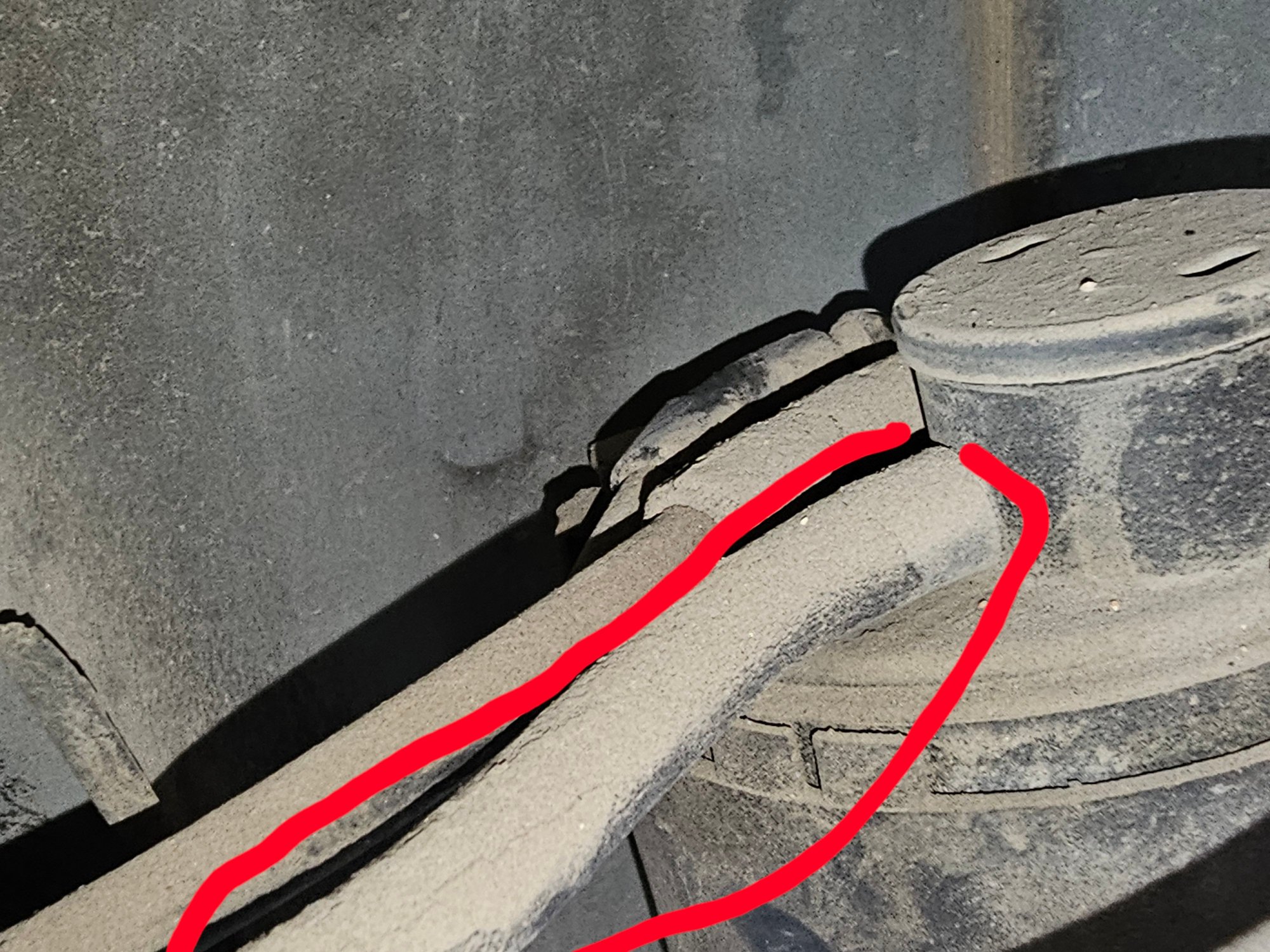

Hello everyone I need help. I have a 95 camaro and I was replacing the Charcoal canister on the rear driver side and I disconnected the hoses on the Charcoal canister to replace the Charcoal canister because it went bad on me and the first hose that connects to the canister I noticed that it was lose and felt lose so I followed the line underneath the car and it dose not connect to anything is that normal or dose it connect to something because I spent like an hour or 2 seeing where it connects to but I am not seeing anything that would connect to it so can anyone help me if that hose is supposed to connect to something other than the vapor canister.
See this first hose that i circled in red where dose it connect to other than the vapor canister?

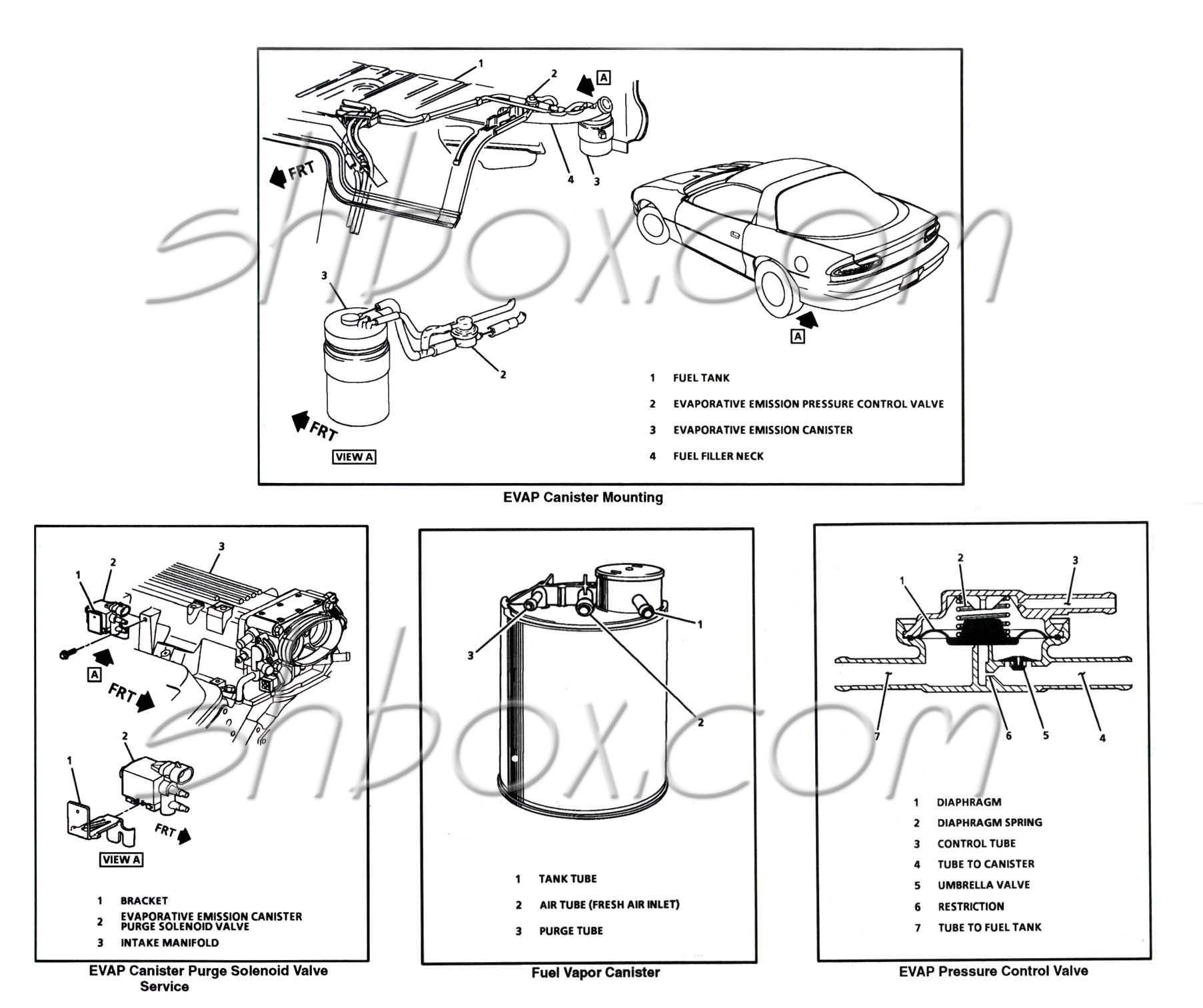

this may help. one hose is air inlet
