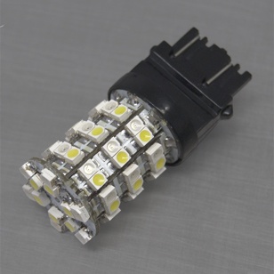

Anyone tried these?

Old Mar 31, 2012 | 07:51 PM
Posts: 22,027
i think bc has
Old Mar 31, 2012 | 08:25 PM
BasicConcepts's Avatar
Joined: Oct 2009
Posts: 4,597
Technical User
ya i put them in the tail lights on my sisters grand prix there nice alot brighter than the filament bulbs and last forever
edit: actually ive never used the switchback bulbs just led bulbs chaotic94 just got some for his markers there pretty sweet clear running lights and amber turns but you need clear lenses
