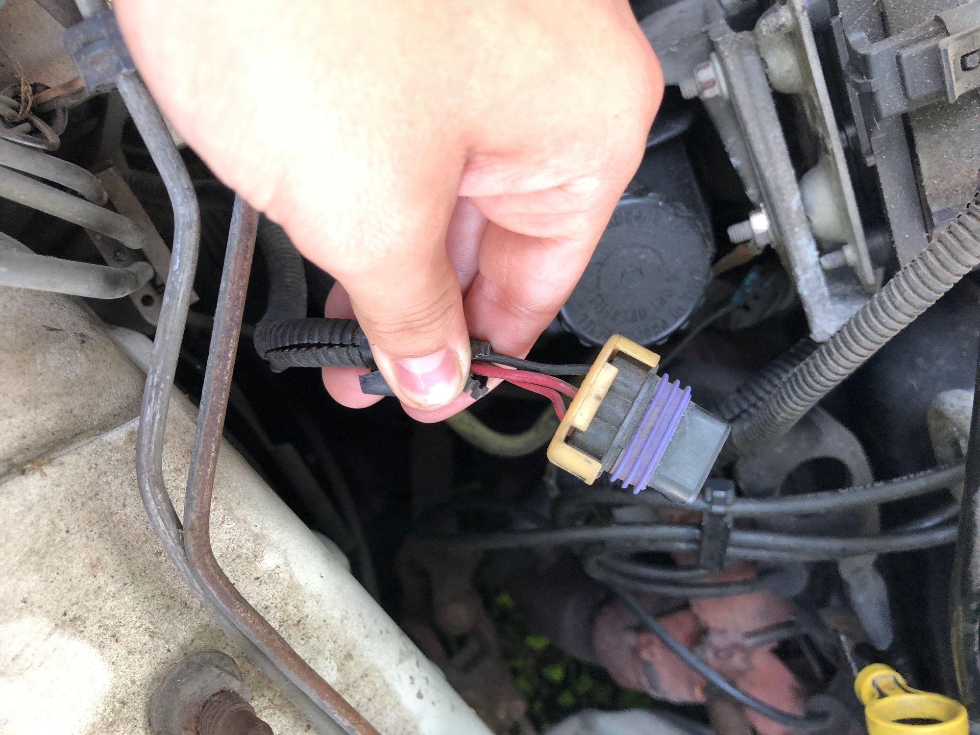

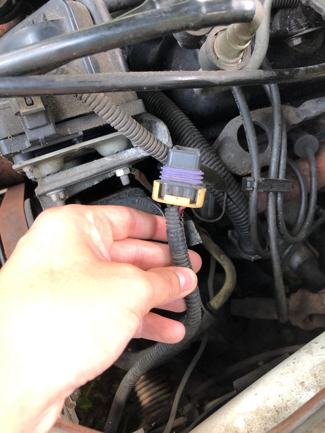

Found a wire near front drivers side engine not sure where it goes or if it could hve anything to do with problem.I’m attaching pics

Any idea what this goes to? Driver front just under abs coming from wiring harness
