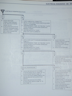

ok so see if there is juice getting to the underhood electical center or fuse box in the engine compartment. if there is then the fusable link is not the problem. next heres what i found in the book, see if my photo skills are improving. theres a starter enabler relay that it could be. my pics suck
Attached Thumbnails 92 rs wont start-starter-ele-dia-3.jpg   92 rs wont start-starter-ele-dia-2.jpg   92 rs wont start-starting-ele-dia.jpg

this is a different way. just trying to get them bigger. we ll see how it goes.
that didnt work. if u cant read pm me your email and ill send em that way and then u can blow them up to read.
Attached Thumbnails 92 rs wont start-p6130033.jpg   92 rs wont start-p6130032.jpg   92 rs wont start-p6130030.jpg

no cant see them but i found the problem. well u knoe the orange covered white wires that come from the key...well after the connector it turns into a purple and brown wires.. the purple one was cut about 2inches from the connector but was still being held on by the plastic insulator....rewired and runs fine now.. thanx every1 for ur hard work.
