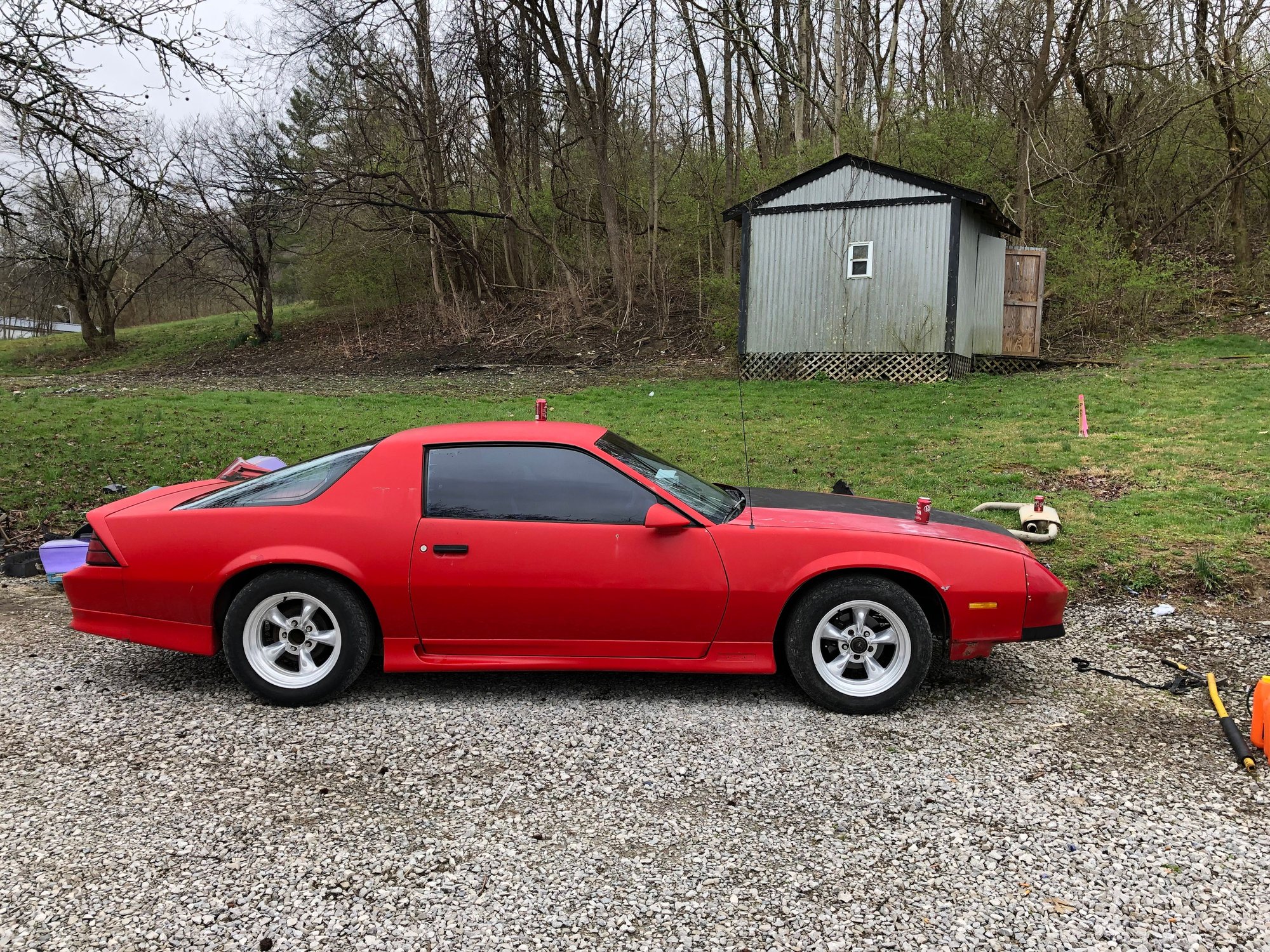

Hi guys new here. Restoring a 91 Camaro RS 5.0L 5 speed. I have replaced the ignition lock cylinder twice now. Both times the key struggles to turn off. I have the correct VATS key as my car will start. Is my steering column messed up? I have tired to lube both locks. I have installed. And nothing seems to help turn off the vehicle. The first one I broke trying to turn off my car. Second one I can get out after several minutes if wiggling the key. Any suggestions would help. I am thinking of changing the column. If I do. Could a column from a automatic car work for a manual 5 speed car? Please help guys. Also when the ignition lock is not in the car. It operates normally as it should. But once installed inhave
