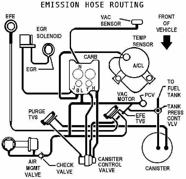

Originally Posted by sycopath2316@yahoo.com
just checked those vacuum lines to the emissions vacuum canister and it is the one on the left--for the gas tank.
Then that explains why the engine ran funky when you plugged that hose with your finger. The gas tank needs to vent, and plugging that hose vapor locked it.

  #35
A couple more things...is the hose you capped with your finger connected to the canister in front, or was it the one that goes to the gas tank? If it was the tank vent hose, then that supports what I just said above. If the hose is on the canister and disconnected, then your engine is running with an open vacuum line. That will speed up your idle (and lower it when you plug the hose), and can also cause runnability issues.
Also, did you ever get the fuel pump issue resolved? Which one are you running off of?
the hose that i capped is connected to the canister... the other end that is supposed to be plugged in was where i was capping it off...
OK, after rereading your previous post, that's what I was gathering you were saying.
Is any of that other stuff, as shown in the diagram, still there and connected?
An open vacuum hose will raise the engine idle speed, and plugging it lowered it back down. Sounds like whoever removed that hose may have slowed the idle down at the carb. Try temporarily plugging that hose with a screw, and adjust the idle up at the carb. Then you can work on your scavenger hunt.
