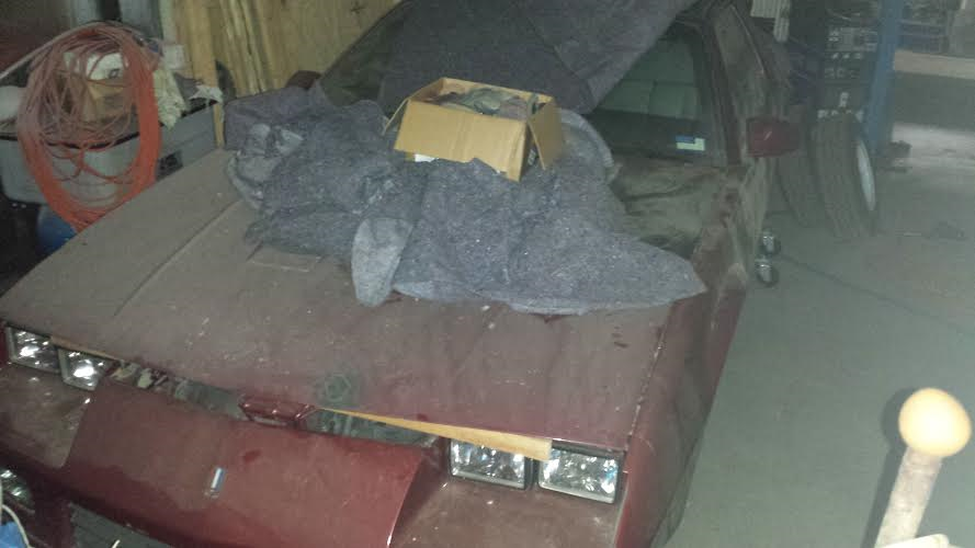

So heres the start of a long and slow rebuild of my 89 RS. Currently Sitting in a shed 3 hrs west of where I live. It will be home the weekend after easter. ill be taking photos as I go just for my own sake of having it documented as to what it was to what the finished product will be.
Details are 1989 GEN 3 RS Camaro. fuel injected 305CUin. 5 speed manual. 50,000 miles on the clock.

well well well I was finally able to drag the car out of the shed yesterday and bring it home. theres heaps of photos that I have to upload but Ill try something else first. paint is fair for the age of the car. some work needs to be done as I was aware but all in all a very solid platform to work from. Im one very happy camper
