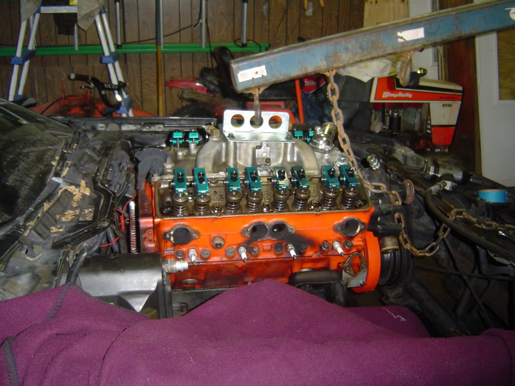

You will hook a chain, via two bolts, into the intake bolt holes on the heads. One in each opposite corner.
Uploaded with ImageShack.us
Tranny bolts: re read my statement about the uber long extension. You wont need to lower your transmission at all. It doesnt matter what order you take them out. Yes the engine will be supported by the mounts with the bolts out. Now dont forget, your transmission has two mounting dowels that poke into the block. When you yank the engine, your going to have to pull forward and up. Dont let it scare you, it will almost pop out of place, after that its just a matter of hoisting it up and over the bumper.

If you wanna make it really easy, buy a lift plate that attaches to the intake manifold. Almost makes it too easy:
