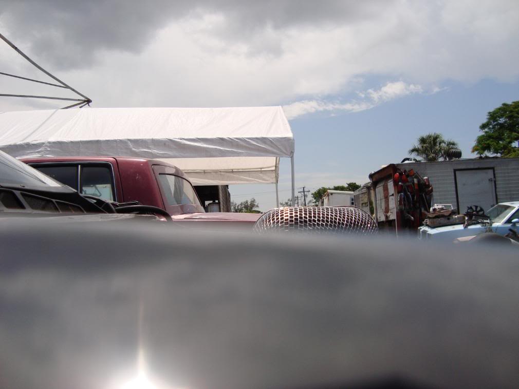

Huh. I originally bought one of these filters. As you can see in this picture, it didn't even come close to giving me enough hood clearance:

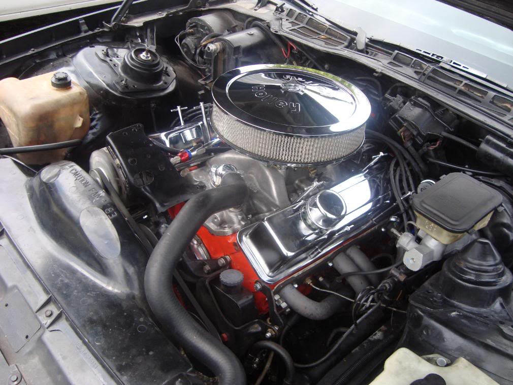

So I went to Advance and they had a 14x3" Holley chrome air cleaner assembly for like $40 bucks. Pretty sure it's a 2.5" drop base, and it fits PERFECT with a performer intake and street avenger carb:
