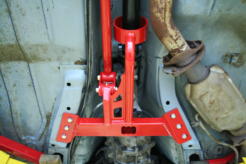

pictures would be good. umi has a tunnel mout torque bar setup http://www.umiperformance.com/catalo...roducts_id=132

Old Mar 7, 2016 | 03:14 PM
^ That's a perty one, almost makes one want to get run over just to be able to see it up close! lol
Does anybody make a frame bracket only, that you can attach a stock arm to? The guy did hint that his budget is tight.
Old Mar 7, 2016 | 03:57 PM
Looks like both BMR and UMI make one ($260 ish). Seems like it would be easy to fab up with even amateur welding skillz. Course who ever made the first on failed.
