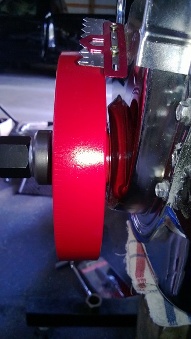

I need to get a picture up here, not sure if the balancer is on all the way or not? When I installed the balancer, it went on like butter after having it in the oven. Didn't even need to disable the crank until the very end. I had no problems tightening the installer tool to press it on and then it just stopped spinning, which I assumed was when it was on and seated. It just looks to me like it's not on all the way? I don't know. Would be kinda strange to have it go on so easily and then suddenly bind up on something?

I'm still not positive about this but it's gotta be on there! Just seems like it's out farther than others I've seen. I tried again with the installer to see if I could get it to go on any further and it just won't. After looking at the pics of the engine before I tore it down, the balancer appears to be in the same spot in comparison to the timing tab. Any other ways to check to verify?

Looks about right to me, but the only way to know for sure involves removing it again. When I install a balancer I measure depth from the seal to the stop ridge on the crank. Then I put a mark on the balancer that will line up at the measured depth. When pushing the balancer on I can see when the balancer bottoms out as the mark lines up.
I'd guess your's is fine if it came to a solid stop, and I wouldn't worry about it. You'll have a large washer and bolt holding it also.
Old May 7, 2013 | 10:42 AM
  #349
If it's not in all the way, you'll know when you try to line up the pulleys.

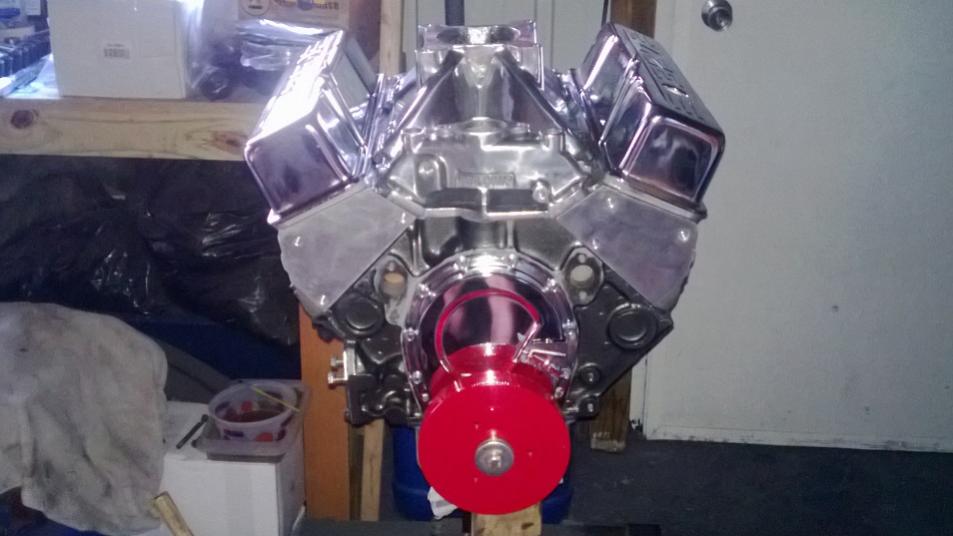

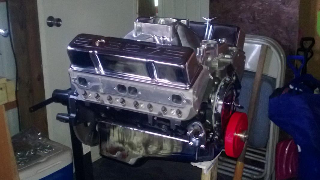

Good point Vall, I definitely should've done something like that before installing it. You make a good point as well '69 but my intentions of course are to not have to learn the hard way/after the fact many more times during this build. When I took this balancer out of the oven last night and put it on the crank it went on so easily (like I mentioned) that the crank didn't even need to be disabled until the last 2 turns. Hate the uncertainty but with the way it went on, there's a fair amount of confidence that it's on all the way. ANYWAY, here's a pic of the almost finished product. Sad to me that the least new looking parts on this engine are indeed the parts that ARE new! Almost half tempted to paint the heads the same color as the block but I don't know. Knowing most of the head(s) will be covered up by the ceramic headers makes me feel a little better. Yes, there is a method to my madness with the red balancer also. I need to detail paint the lettering on the valve covers and air cleaner with the red/black paint pens I got, just haven't done it yet. It'll make more sense as I get more of the accessories installed, but for now, it's progress! Thanks for the insight again gentlemen.
