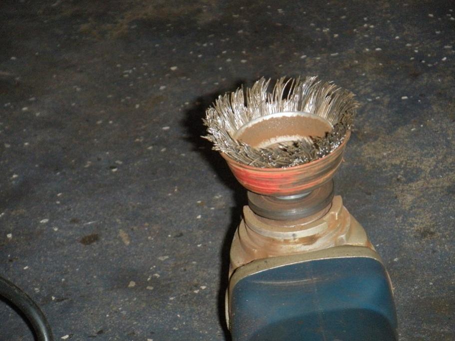

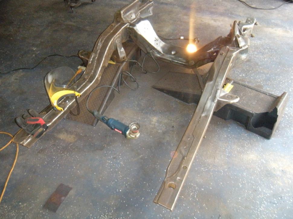

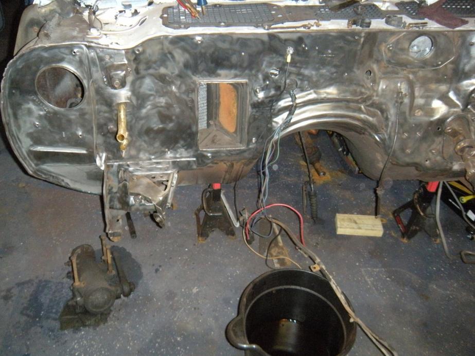

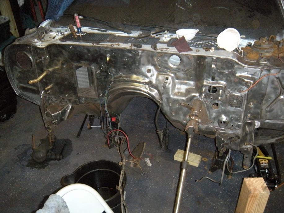

Frame is cleaned up (for the most part) and just about ready to get some paint! Firewall is ready too. As you can see from the pics, I still have to go south from the firewall and get the whole bottom done but that firewall was a PITA with all the various things in the way. Ordered some Fast Etch and PRE painting prep from Eastwood today and just waiting on that stuff and the first 60 degree day to come. I got the spindles in the Molasses and just about have the control arms apart so they can be dipped and ready for paint too. Good day today! Can't wait to see this stuff painted and ready to go back together. Funny pic of what's left of one of those big knotted wire wheels after doing the frame lol!

I wish I could have gotten mine that clean. the POR 15 that was on mine wouldnt budge with a wire cup like that. It was my plan too. Looks good though.
