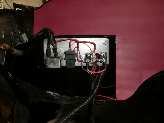

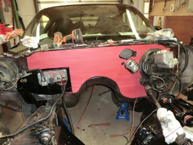

I guess my big concern would be if the wiper motor ever failed. I'd want to leaave enough clearance to aloow for a wiper motor change in the future. It looks like the motor and transmission for the wipers are trapped under the new sheetmetal.

This panel is removable. It's not welded in. It will be screwed on. The heater box is also removable, but the core is reached from in the car. The box is attached to the fan motor, still in it's original plastic. I'll never replace that once the fender is back on. I have no interest in doing this over and over.

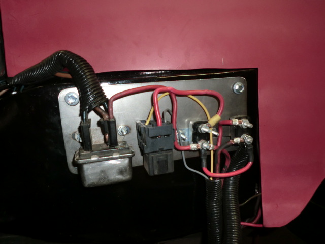

I splashed some temp color on the cover, just to see if I like the effect. I also powdered the heater box.
Next I started on the wiring. I have a relay for the blower, A relay for the elec rad fan. a circuit brkr for the rad fan and a circuit brkr for the elec door openers.
I'll probably build a box to cover this panel

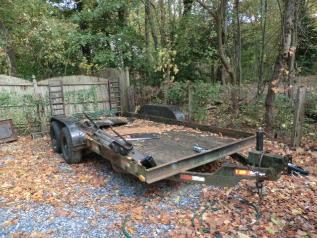

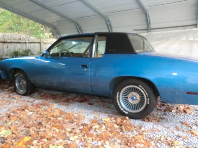

Took some pics of my other toys.
08 dodge ram
motorcycle trailer
car trailer
79 cutlass(Bessy)
Attached Thumbnails New Build Thread?-007.jpg   New Build Thread?-008.jpg   New Build Thread?-009.jpg   New Build Thread?-006.jpg

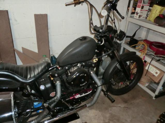

more toys
1974 sportster (My old Black *****)
2007 custom (Wildcard)
1974 shovelhead, heavily modified(The Rocker)
1997 Superglide (my girls bike)
2006 Roadking
Attached Thumbnails New Build Thread?-004.jpg   New Build Thread?-005.jpg   New Build Thread?-010.jpg   New Build Thread?-011.jpg   New Build Thread?-012.jpg

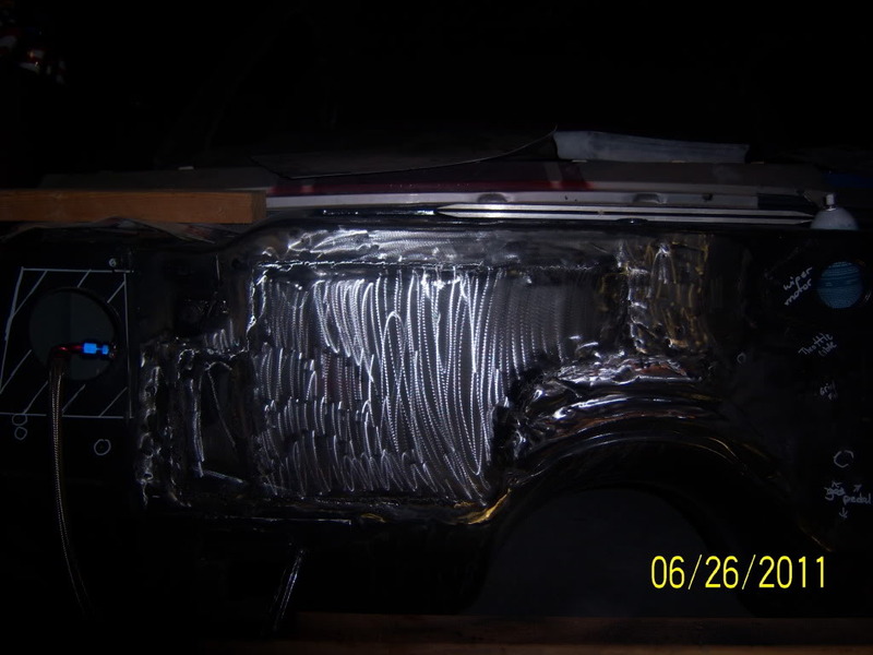

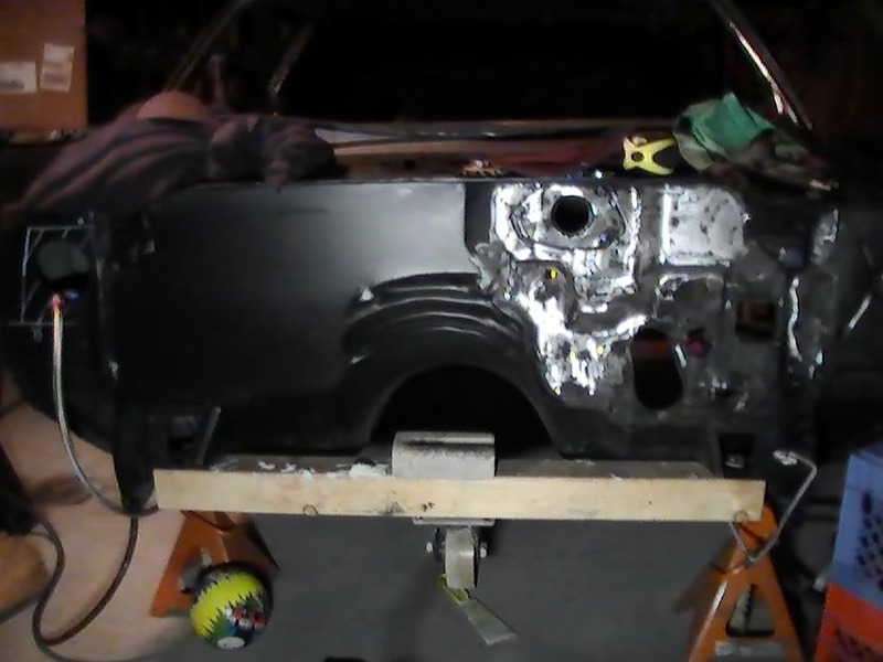

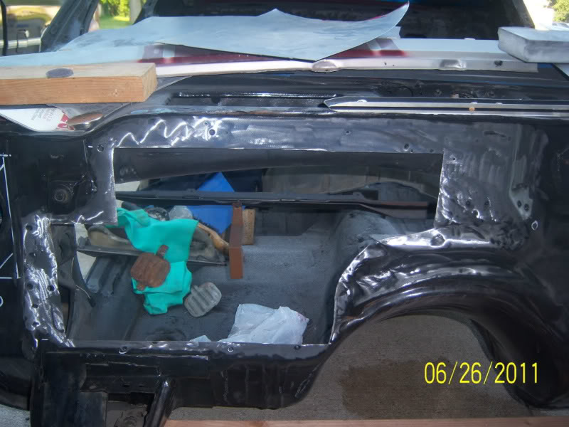

Your fire wall is different. Does it have a gap between the flat one and the original? I just cut out around the box and tack welded in some sheet metal.

Yes the block off plate that I built is 1" off. I wanted to keep wipers and heat/defrost.
