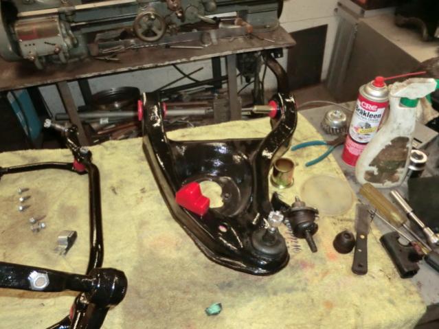

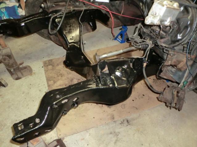

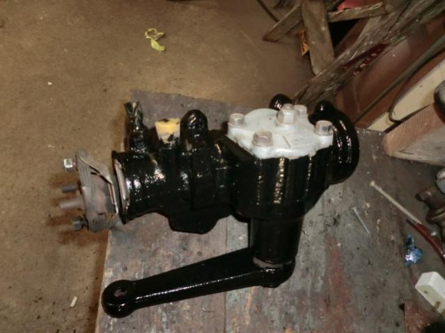

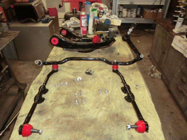

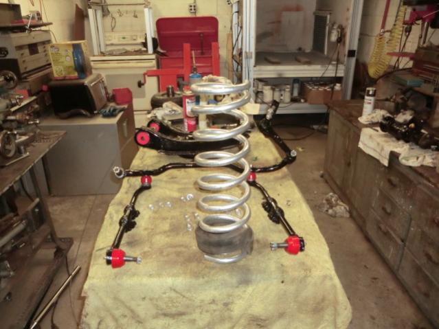

OK Some new stuff today.... Doesn't seem like much unless you spent hours sandblasting and powdercoating screws and nuts and misc brkts...
I also got covered in POR 15. Check out the steering gear and steering box!
I put the rubber spacer back in the spring. I have also PORed the driver side.
