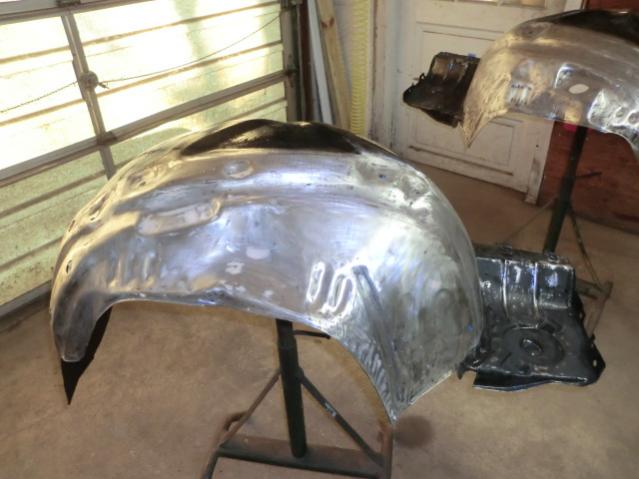

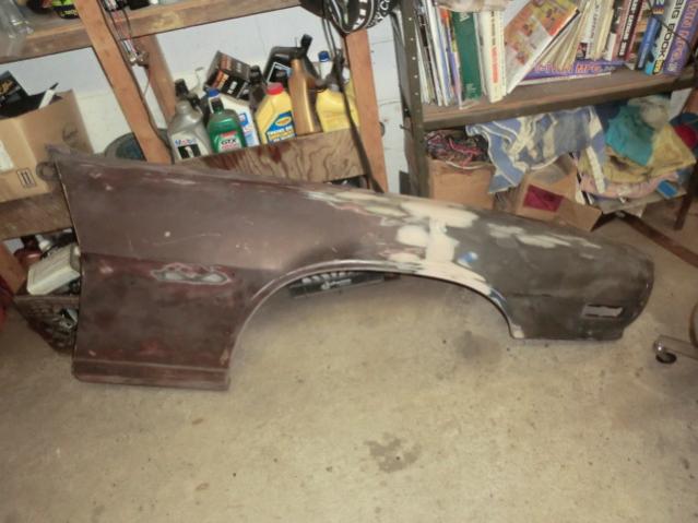

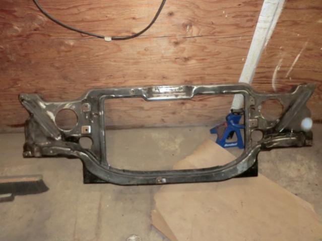

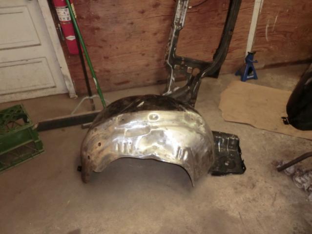

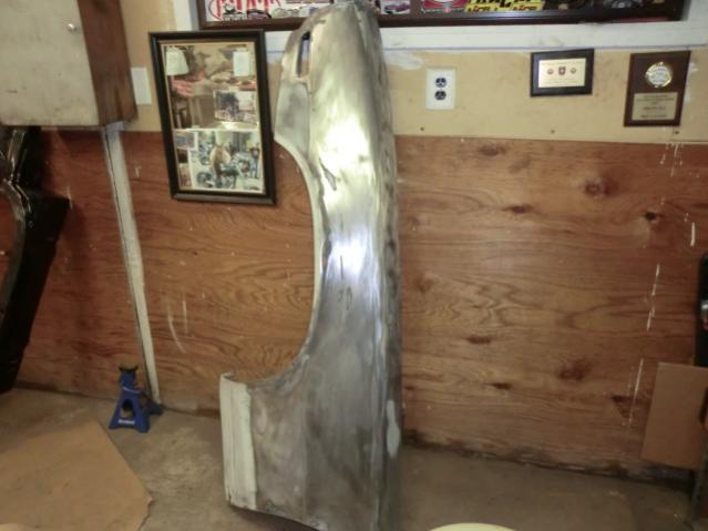

Thanks for the encouragement Bad. I havn't posted much as I'm sanding and stripping paint. I'm waiting for the etching primer to arrive right now.
Wished they hadn't moved my thread!!

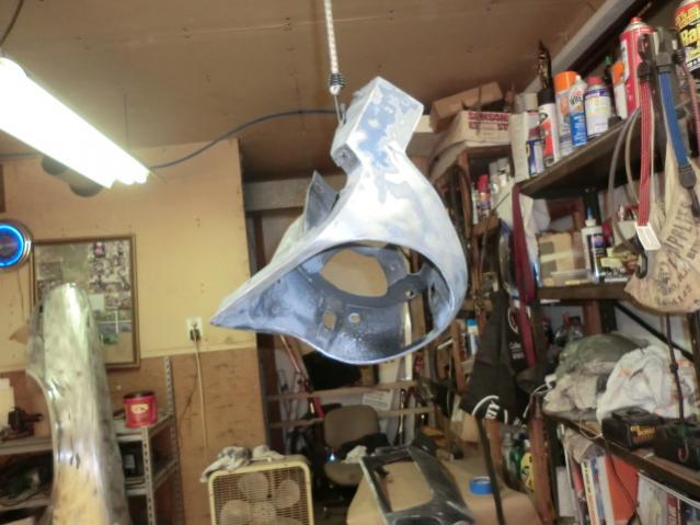

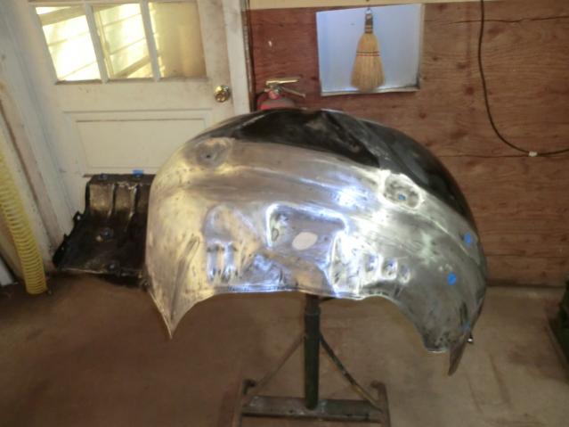

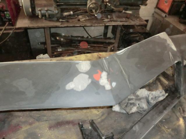

Still waiting for paint from Eastwood. It is a shame as it was 65 deg. for the past week now it's in the 40's when I need to spray.

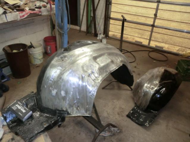

I repaired the cracked nose piece, I drilled a small hole at the end of each crack and then I goughed out to fill. I used an epoxy from locktite. I checked the link that BB sent me to on the Vette forum. That was mainly for the flexible bumper covers on vetts.
I stripped the headlite buckets so they are ready for primer. The wheelwells I pored the backside that is under the fenders and filled the Xtra holes in them.

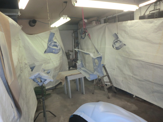

Default Red neck paint booth

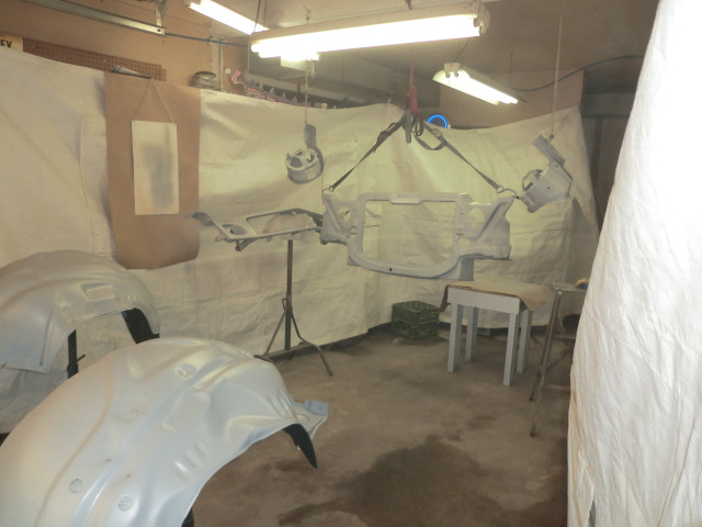

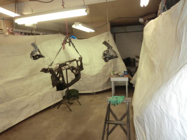

Finally got the self etch in. In a couple hours I can go and spray 2K primer on it. I used the siphon gun on the self etch...I had forgotten what a cloud it puts out...Cough,cough

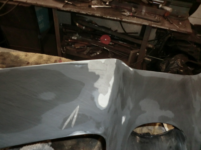

The fun begins....block sanding and bondo!! YAY
