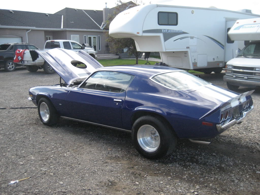

Well I made it home from work and decided to have a look at the car that I have been thinking about all day every day for the last 30 days… It was looking a little sad so I decided to give it a quick bath. Nothing crazy just gave it a quick spray to take off the mud and the melted rubber from the rear fenders. I did a quick engine cleaning as well but after it dried I noticed I could have put a bit more effort into it.

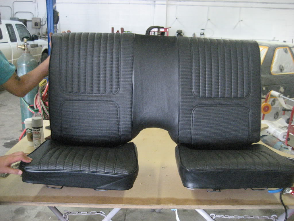

Then yesterday and today I decided to tackle the rear seats. The covers came from Year One several years ago and sat in the shop until a couple days ago. I have never done a re covering before but I am not 100% satisfied with the fitment of the covers. (yes I am blaming the covers, not the installer ) The two bottom seat covers have a different cut then the original covers. There was not enough material on the back sides of the seats and therefore I could not pull out the some of the wrinkles. The back rest cover had the opposite problem. There was a little too much material and I couldn’t pull the cover as tight as I would have liked. All in all the covers will do. This is not, nor ever will be a show car so I will leave the covers how they are now. Besides my fingertips are burnt from using the heat gun.
