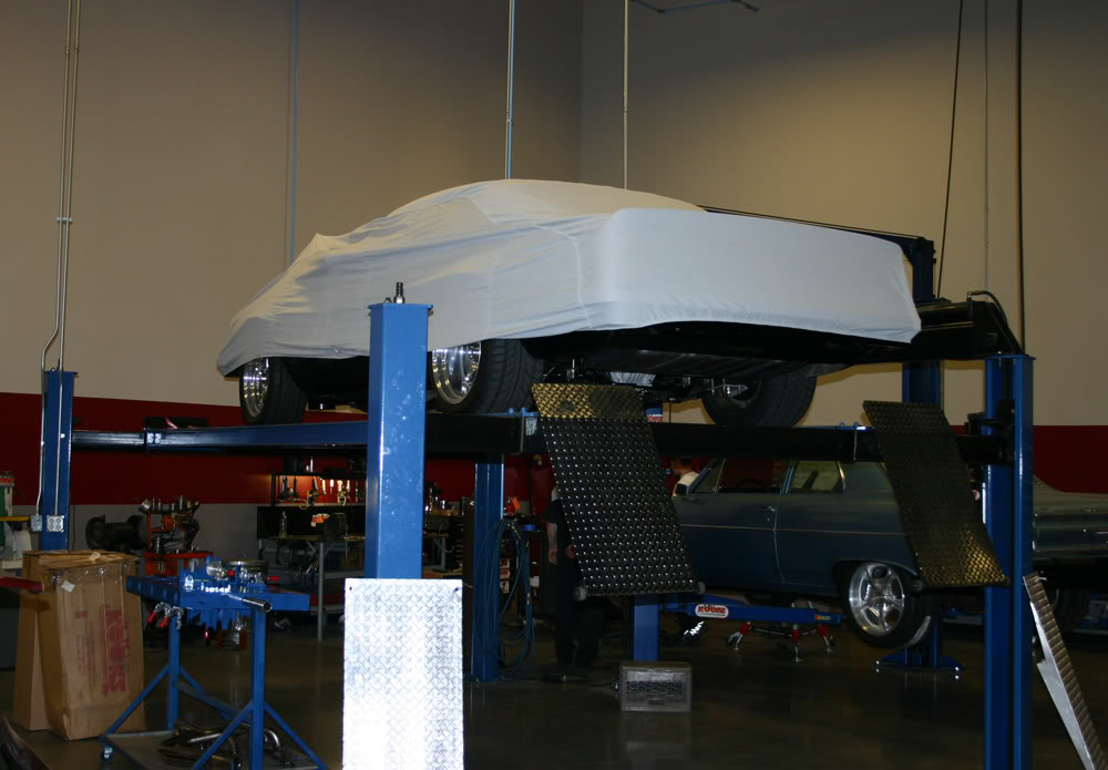

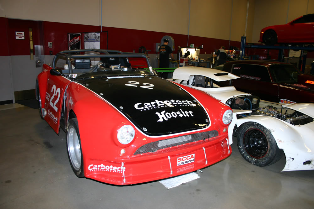

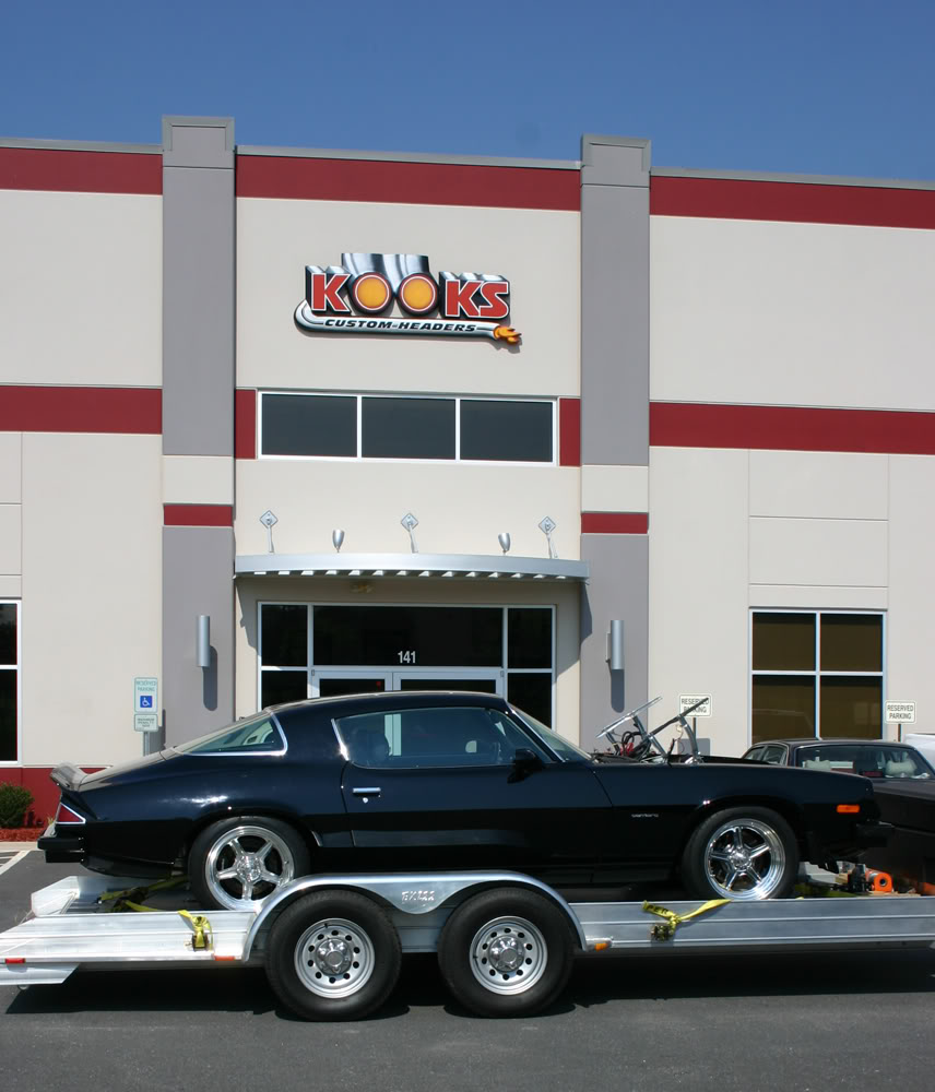

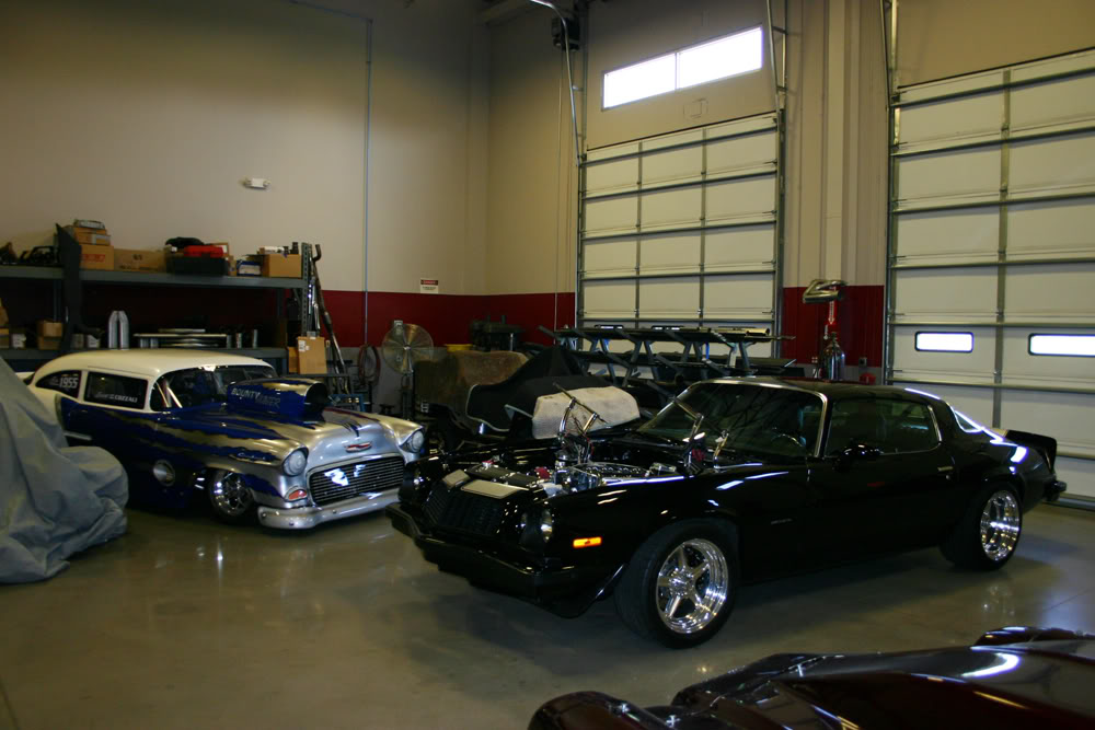

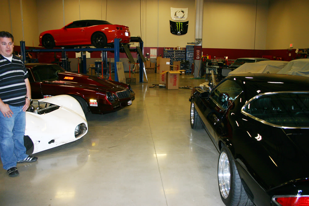

Took the car to Kooks Custom Headers today. They had me meet with some of the techs to go over how the exhaust system was to be installed. Very nice people. They had a number of interesting cars in their work bay. Everything from drag cars to street rods to SCCA race cars. Clint Boyer's '69 Camaro was there for an exhaust.

They asked if I had brought a car cover. Hadn't thought of that so, after driving home and helping my buddy unhook his trailer, I drove back with the car cover. I ended up in the sales manager's office talking about the car. We were discussing the exit for the exhaust and I told him I wanted it like my old exhaust where it exited straight down inside the rear fender areas. We went to my blog so he could see what the rear end looked like with my old exhaust.
I was also telling him about my thread on Nasty Z28 about the LS1 install. As he was scrolling down the photos, he came to the picture of the K & N intake in one of the posts above. "That's ugly" he said and I told him I felt the same but was having a difficult time coming up with something that will work. "Hell, let's build one for you!!" was his next comment. We then went out to the car, he grabbed some 3 1/2" pipe and we talked about how it should fit. He had one of his fabricators come over, talked to him a bit, and we had a plan. I am riding my motorcycle over there in the morning to take him the cone filter and the connectors. It will be polished stainless steel!! Should be pretty cool!!

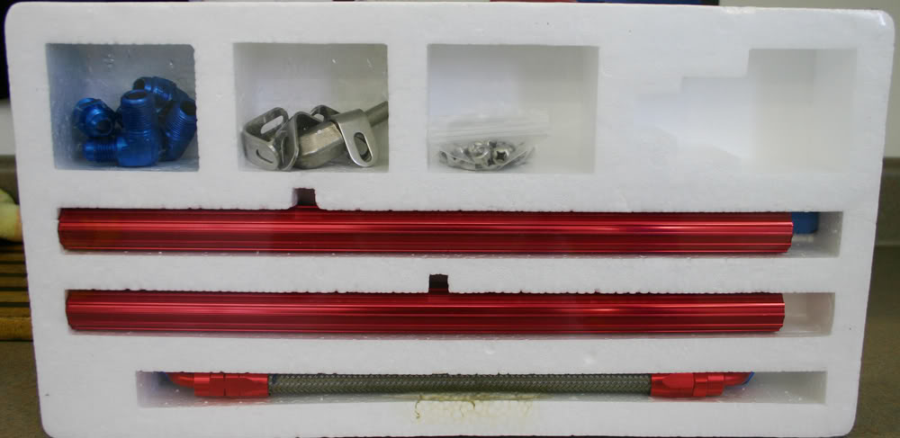

Recently I received the billet fuel rails from Professional Products. The price was reasonable, but, unfortunately, they only come in red with red and blue fittings. I am considering using my buddy's bead blaster to take them back to their natural aluminum finish.
My buddy also mentioned powdercoating them black.
Any opinions?

If you blast them then coat them some how. The anodizing also hardens the surface. Powercoating could be cool. Maybe find a place that can black anodize them. Could blast and then have them polished.

Too many colors make it look too busy under the hood. I'd blast them and either leave them bare, coat them clear, or match them to the other black stuff. Very nice looking parts though!
I agree. I am leaning towards painting everything satin black.

I drove over to Kooks Custom Headers today. Not a whole lot to report there as their digitizer had been down. They have it repaired, but it has put them behind. I watched their guy entering data on another car. Pretty interesting to watch how they can plot all of the hard points and then design the header around those. It will be another couple weeks before my car is finished.
It was good that I stopped as they did have a question for me. They wanted to know if I was OK with their changing the motor mount adapters. They want to sell a complete swap kit including the motor mount adapters so they are sure their headers will work. They showed me a typical mount in another car. I told them as long as the motor uses the factory mounts, I was OK with this. I also asked them to, if possible, move the tranny towards the rear about 1/2" which would place it in exactly the same location as when it was behind the SBC.
