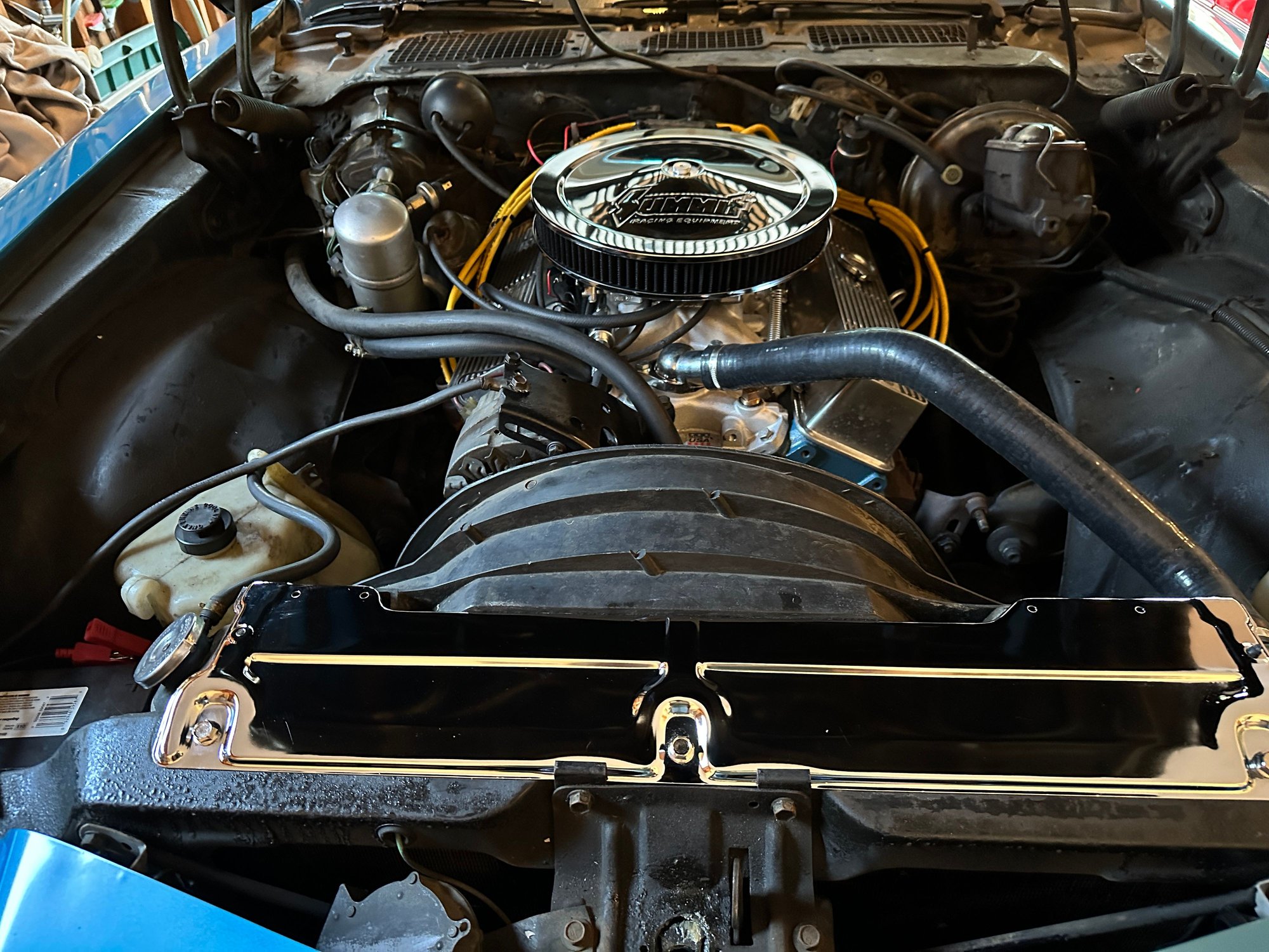

I went ahead and installed the JEG’s X pipe SS exhaust and it really woke up the engine!
I removed the CAT and installed an Edelbrock 600CFM Carb and intake, de-smogged the engine and lost about 125 lbs with the AC.
It’s no 350 but fun to drive and sounds great!
I also picked up a vintage pair of M/T valve covers which really finished the engine bling.
