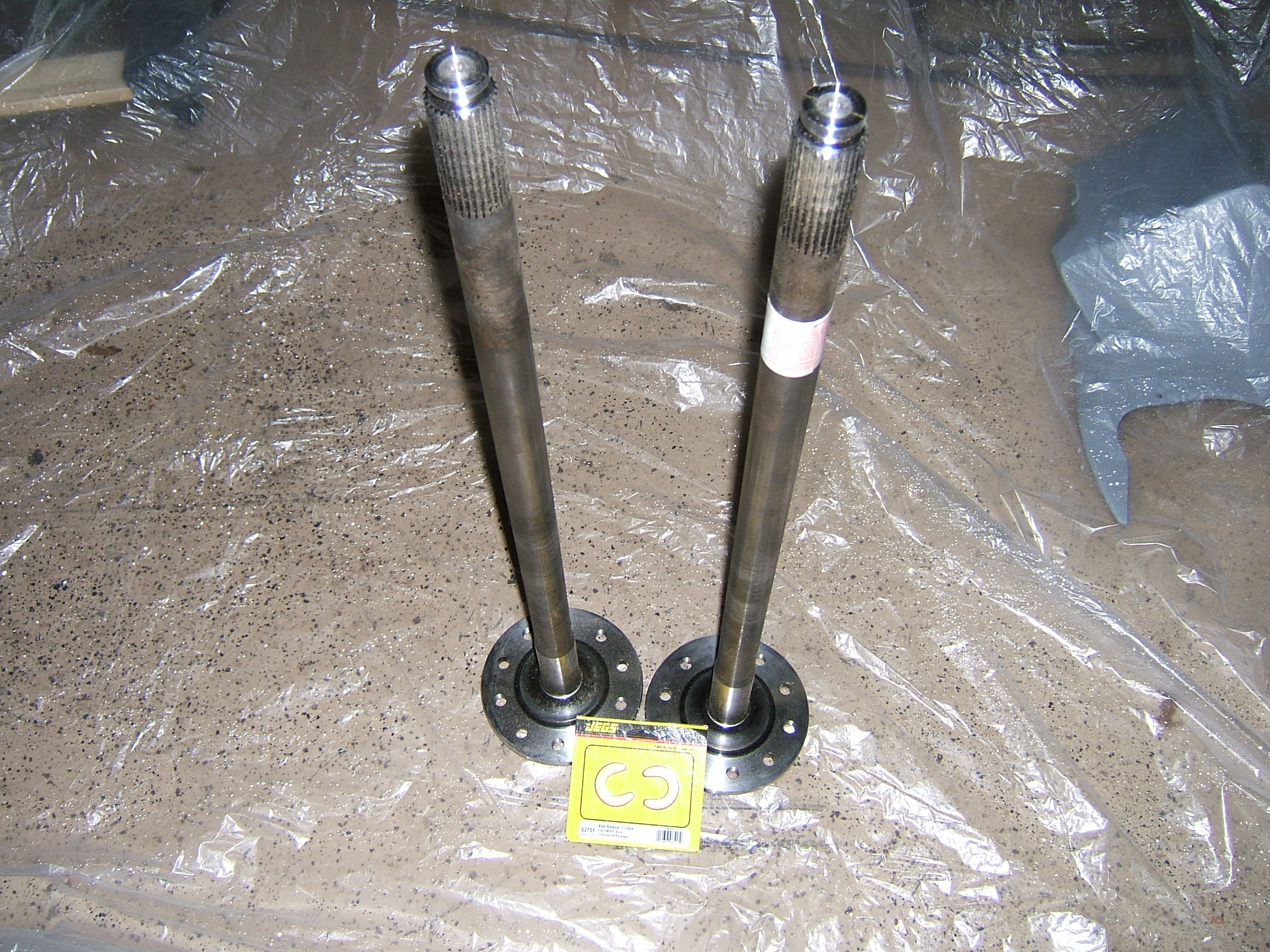

Wife's out of town, so I am catching up on some house projects now that she ain't looking over my shoulder, but I got some stuff in....
Moser 30 spline axles for the rear end.

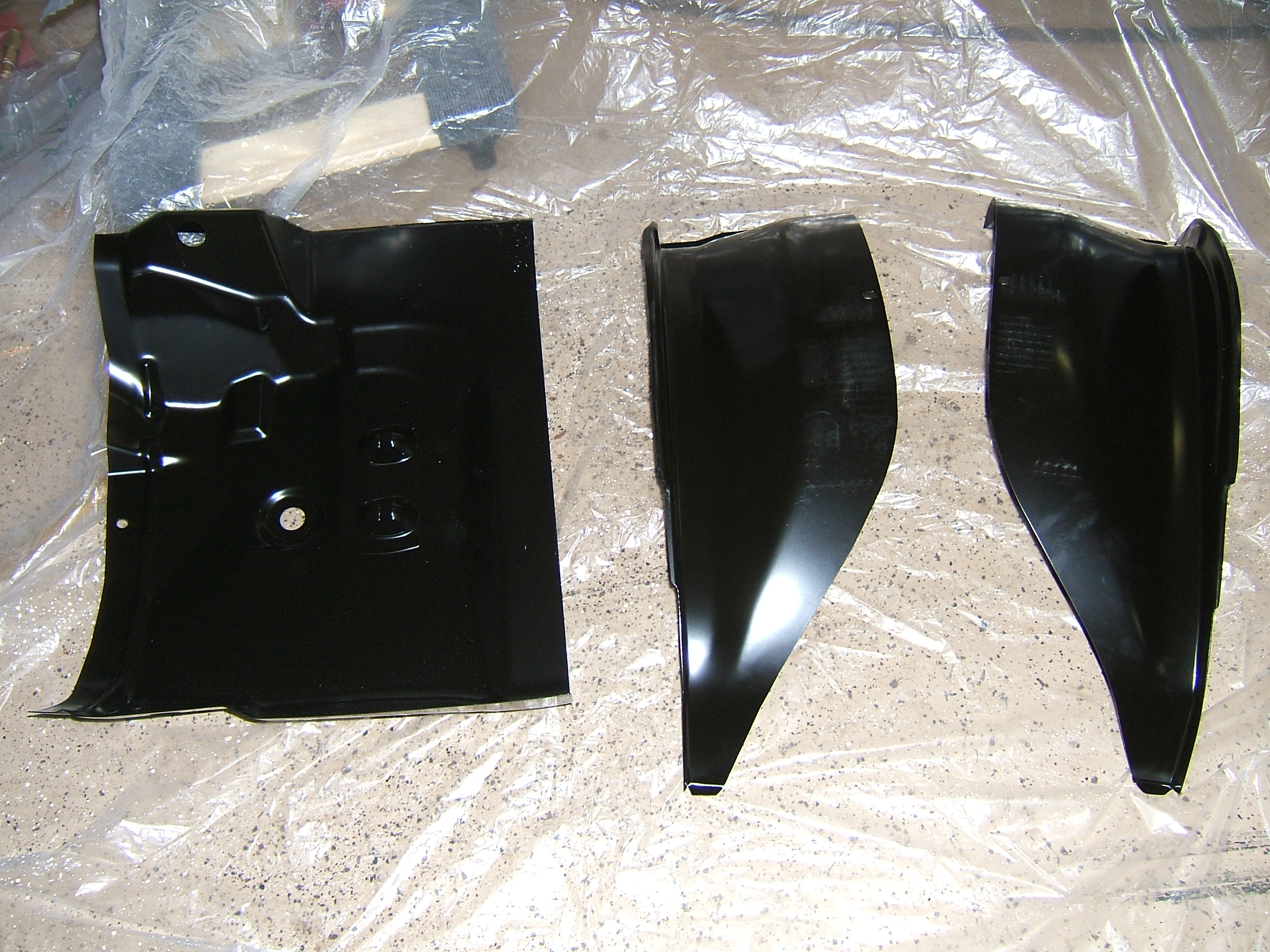

Cowl panels and floorboard panel.

Nice! Looks like the Moser axles have dual bolt pattern also?

Apparently so. I need to get studs for them still too and got those put in.

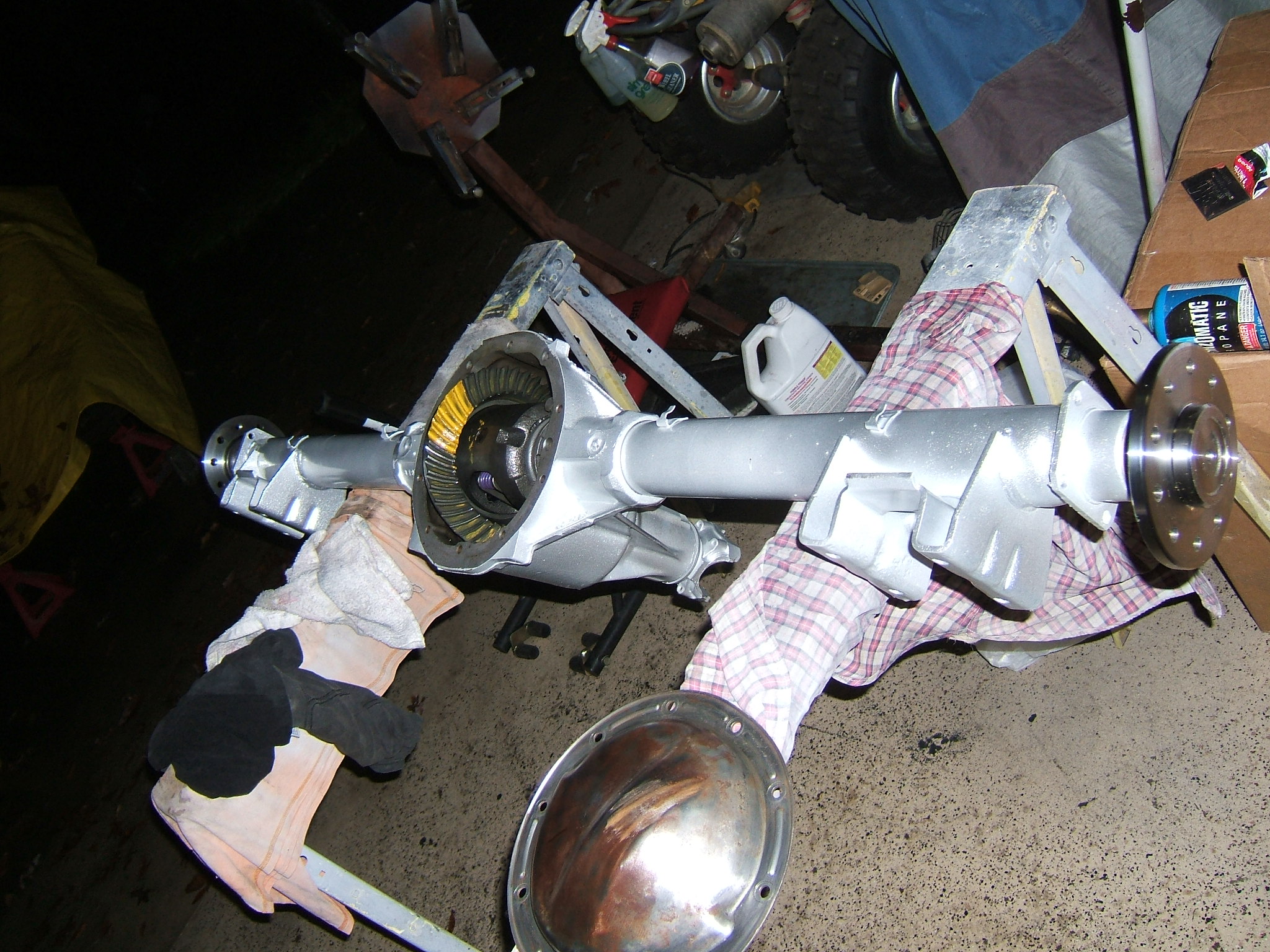

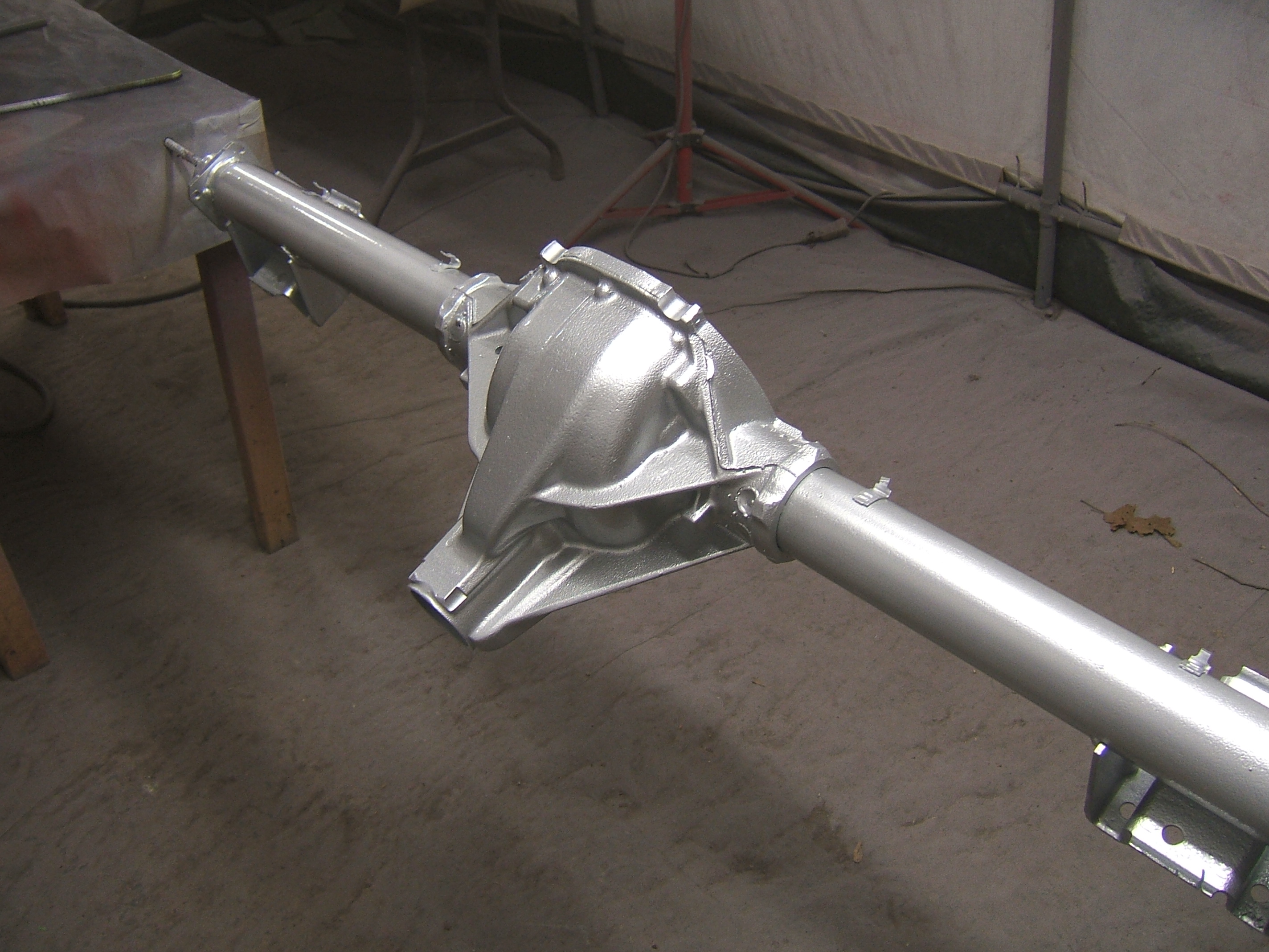

I got the rear end housing back from the sand blaster yesterday and got it painted today in House of Kolors silver. I will not get anything else done until next weekend at the earliest since I have to go out of town on Monday. I should get the rear end assembled next weekend though. Once that is done, I can get some measurements for the rear brakes and get those ordered.

Moser most likely has studs, and can ensure the studs have the correct shoulder size for their axles. I've sure had trouble buying aftermarket studs for axles. Seems they are almost never the right size. Either too large, or too small/loose.

The specs call for a .480 knurl, so that's what I ordered.

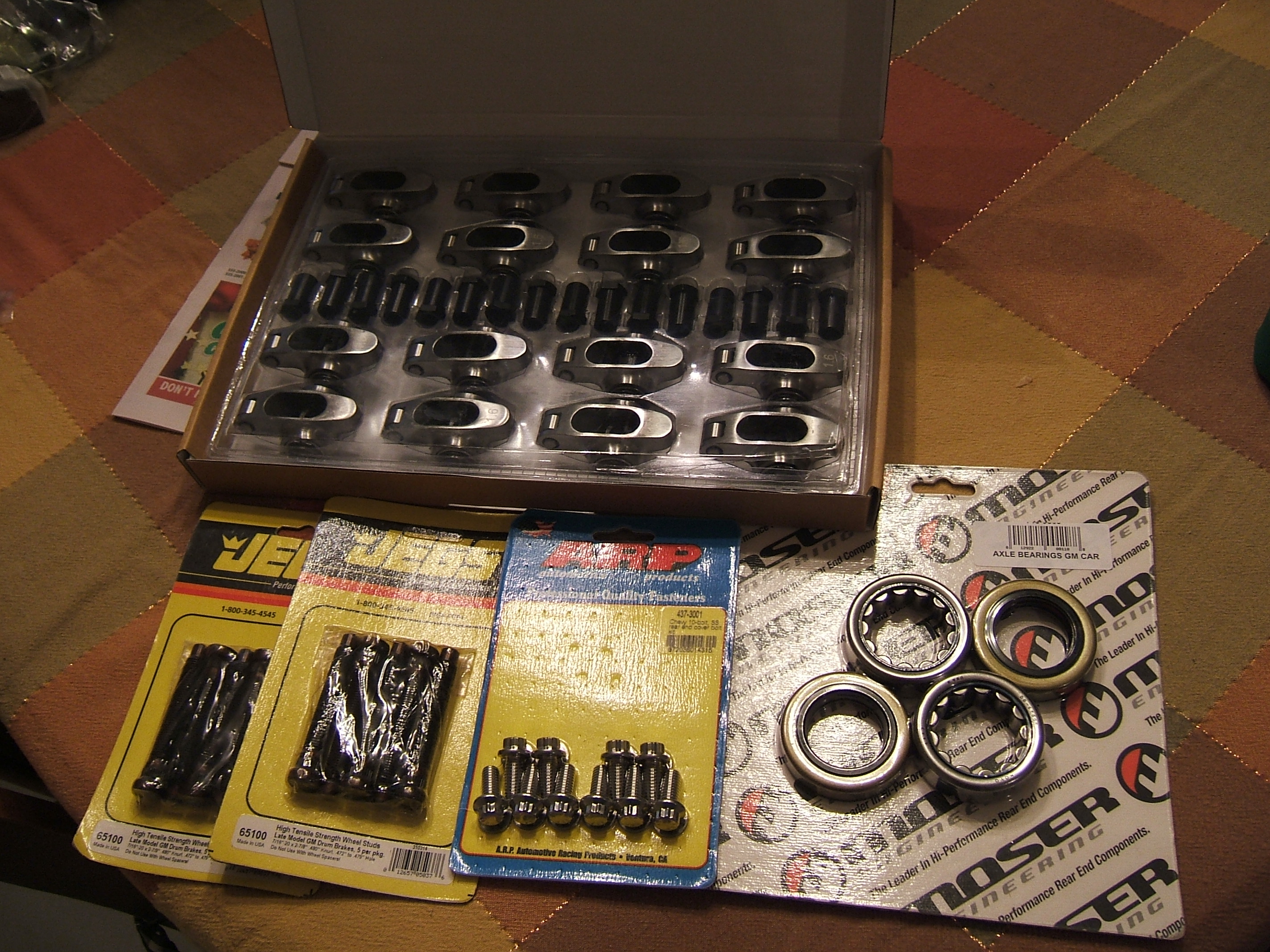

Got back in town and these goodies were waiting for me. Axle bearings, studs, cover bolts.... Also got the replacement roller rockers in stainless with 1.6 ratio.
Should be getting the rear assembled tomorrow, but still have to clean and paint the cover as well as measure for the disc brake kit.

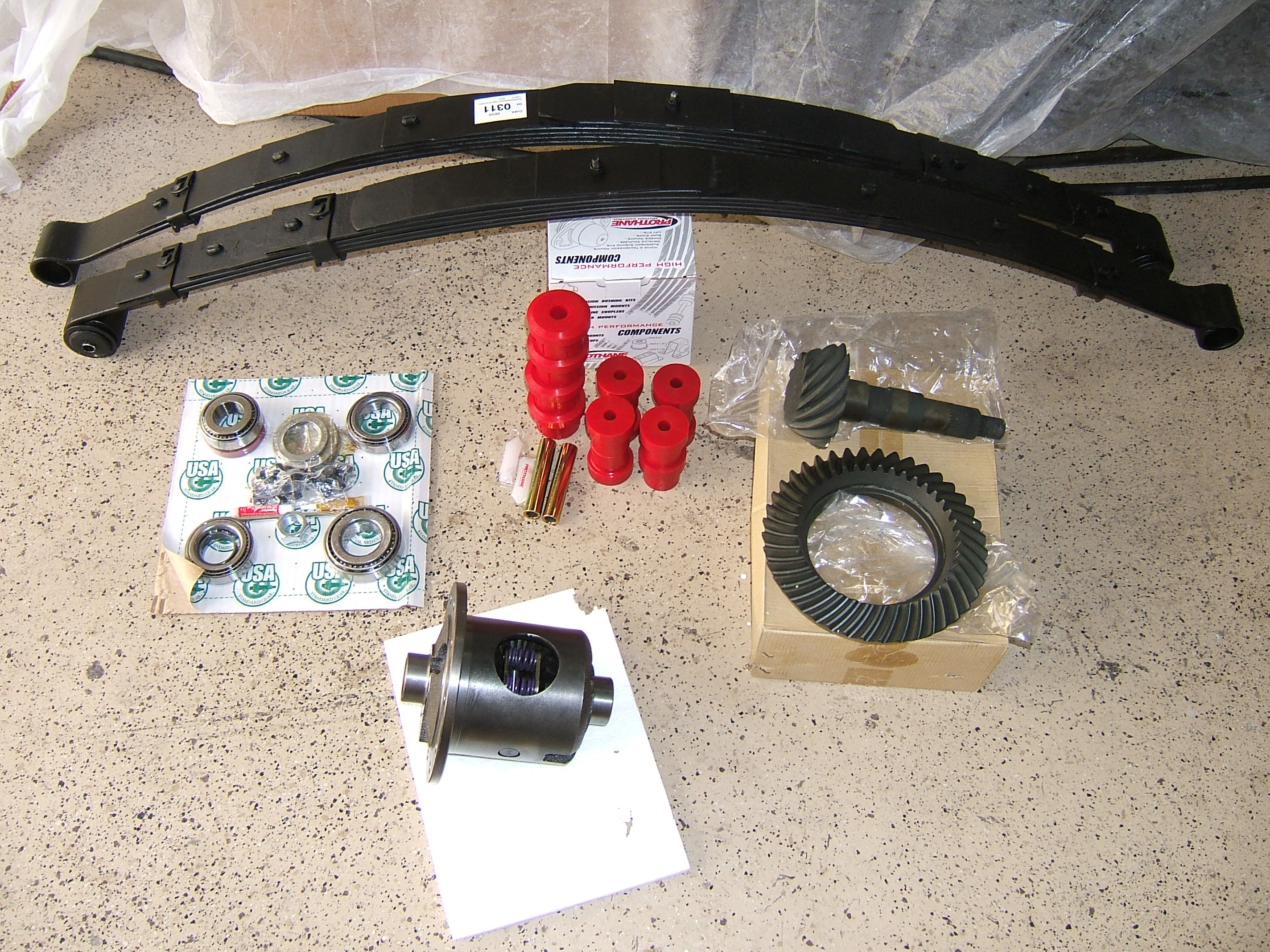

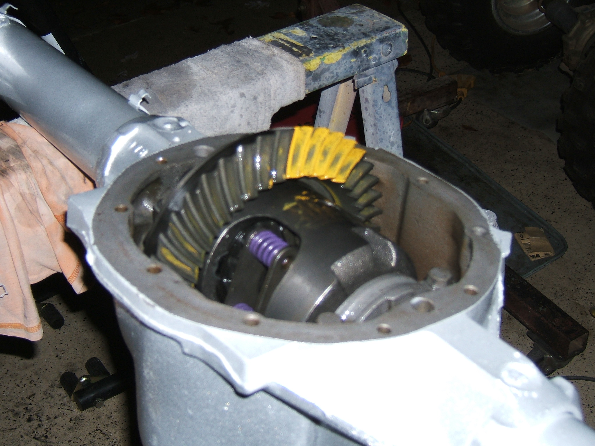

Got my rear end picked up today. Cost me a bottle of Anejo tequila to get it put together and set up properly. I'll consider that $$ well spent. I can order the brakes for the set up now since I know what the measurements are.

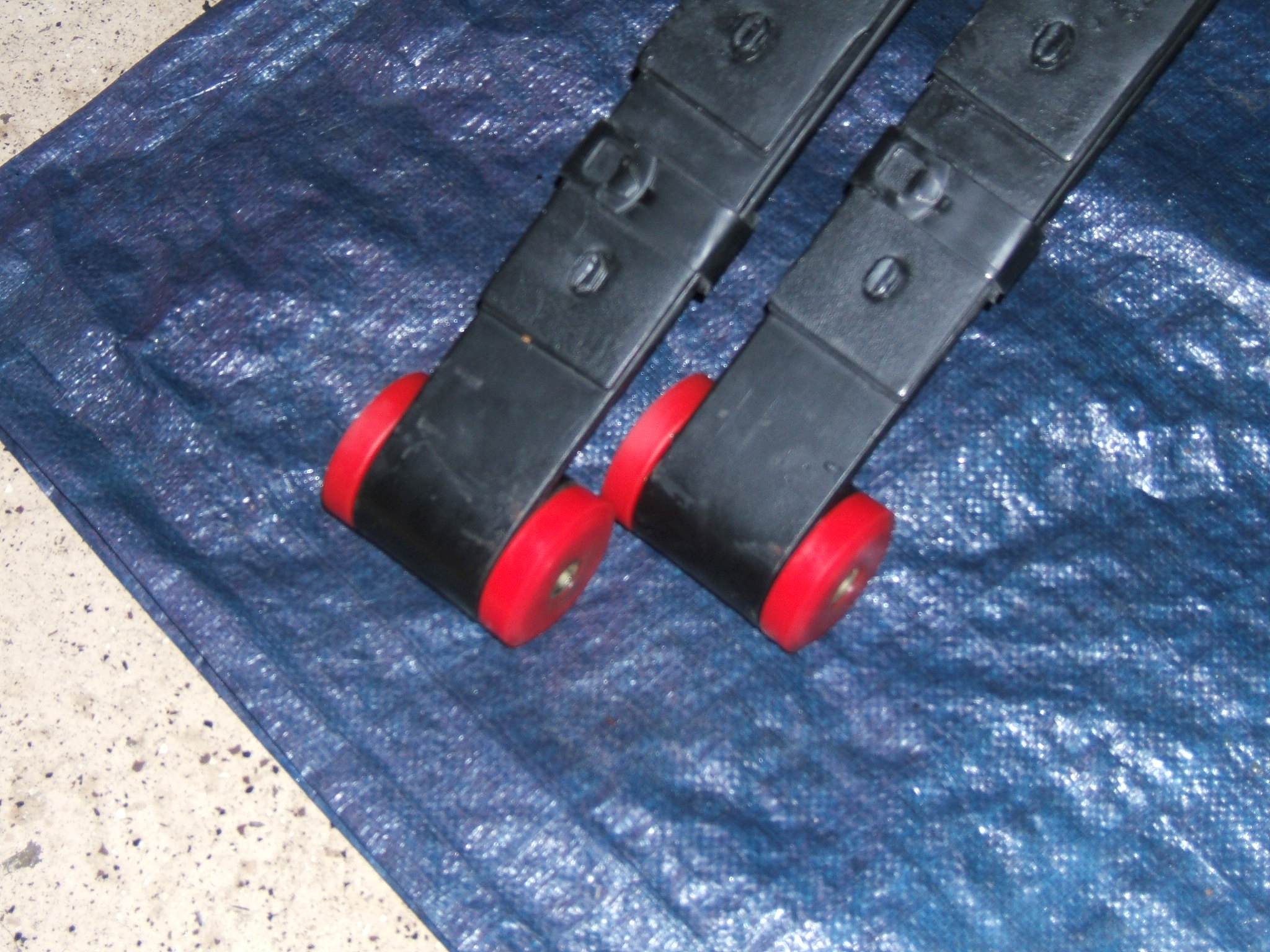

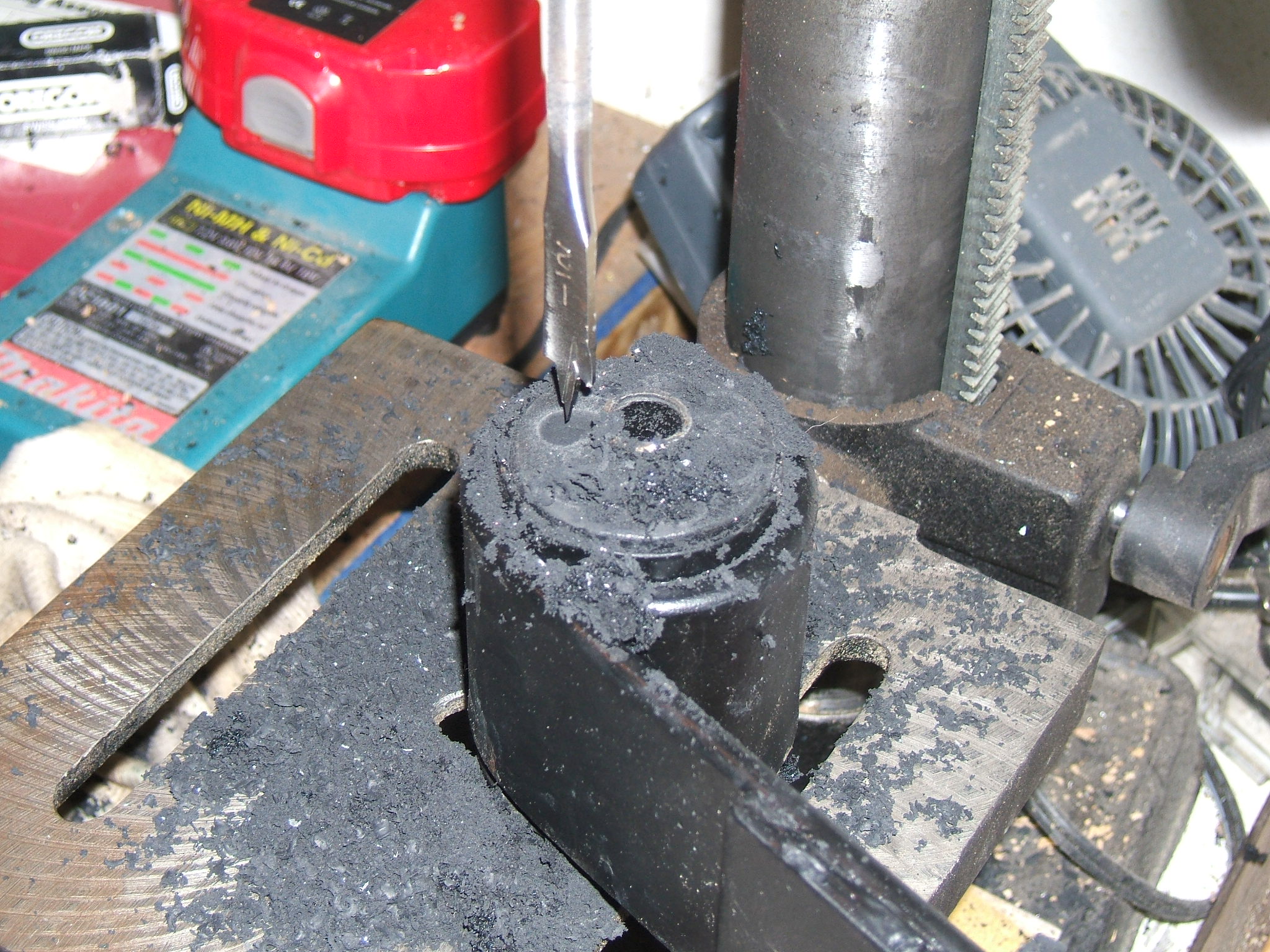

Also managed to pull the rubber bushings from the new leaf springs and install the new poly bushings..... I never knew how much of a PITA it was to remove the rubber stuff. I ended up drilling the rubber to relieve pressure, then punch the center out, remove the rubber, and then the sleeve before putting the poly bushings in place.
