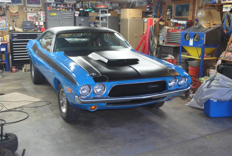

Petty Blue, SWEET!
Old Oct 28, 2014 | 06:07 PM
  #65
meanstrk's Avatar
Posts: 73
That one yours? Lovely!
