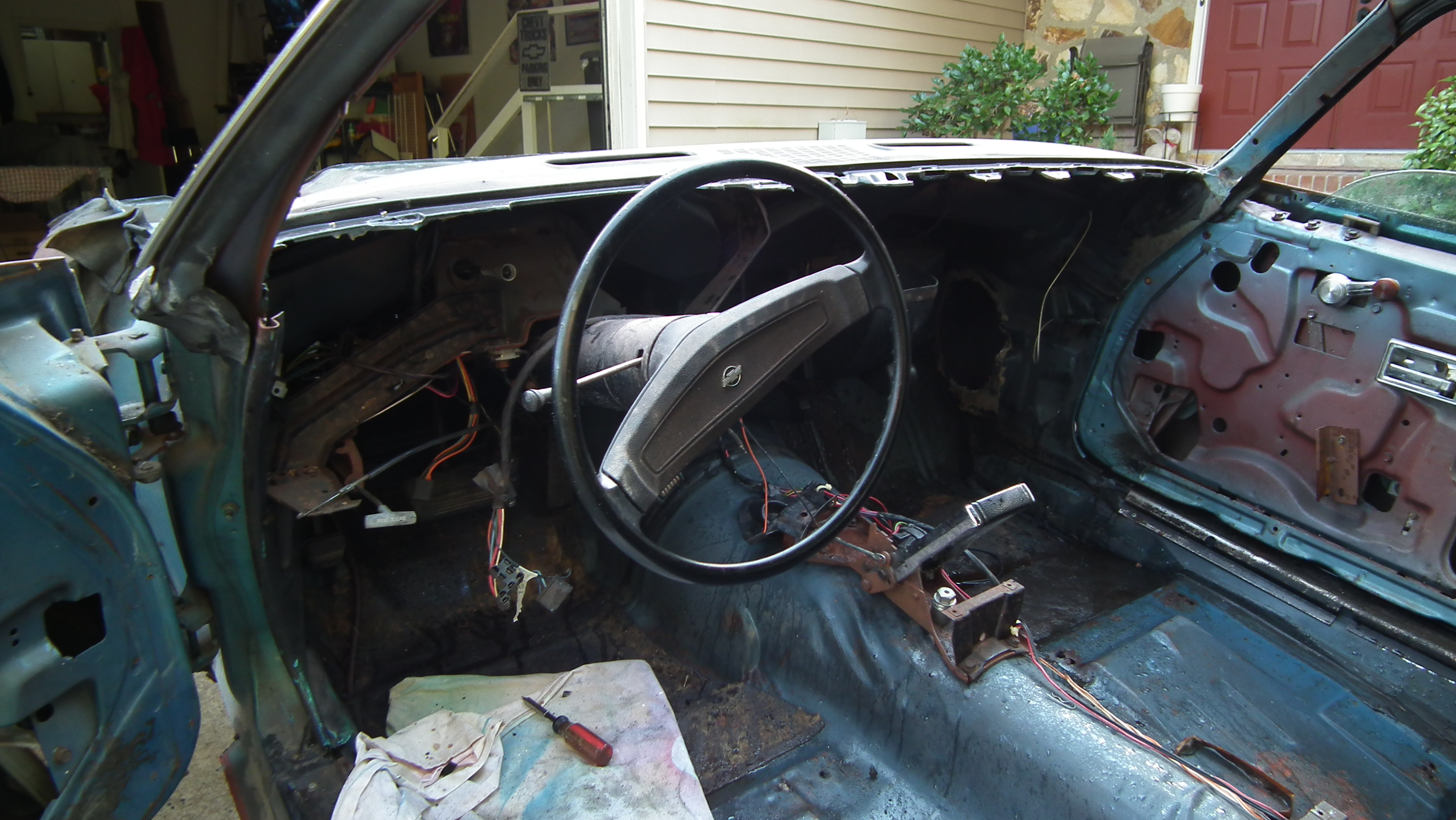

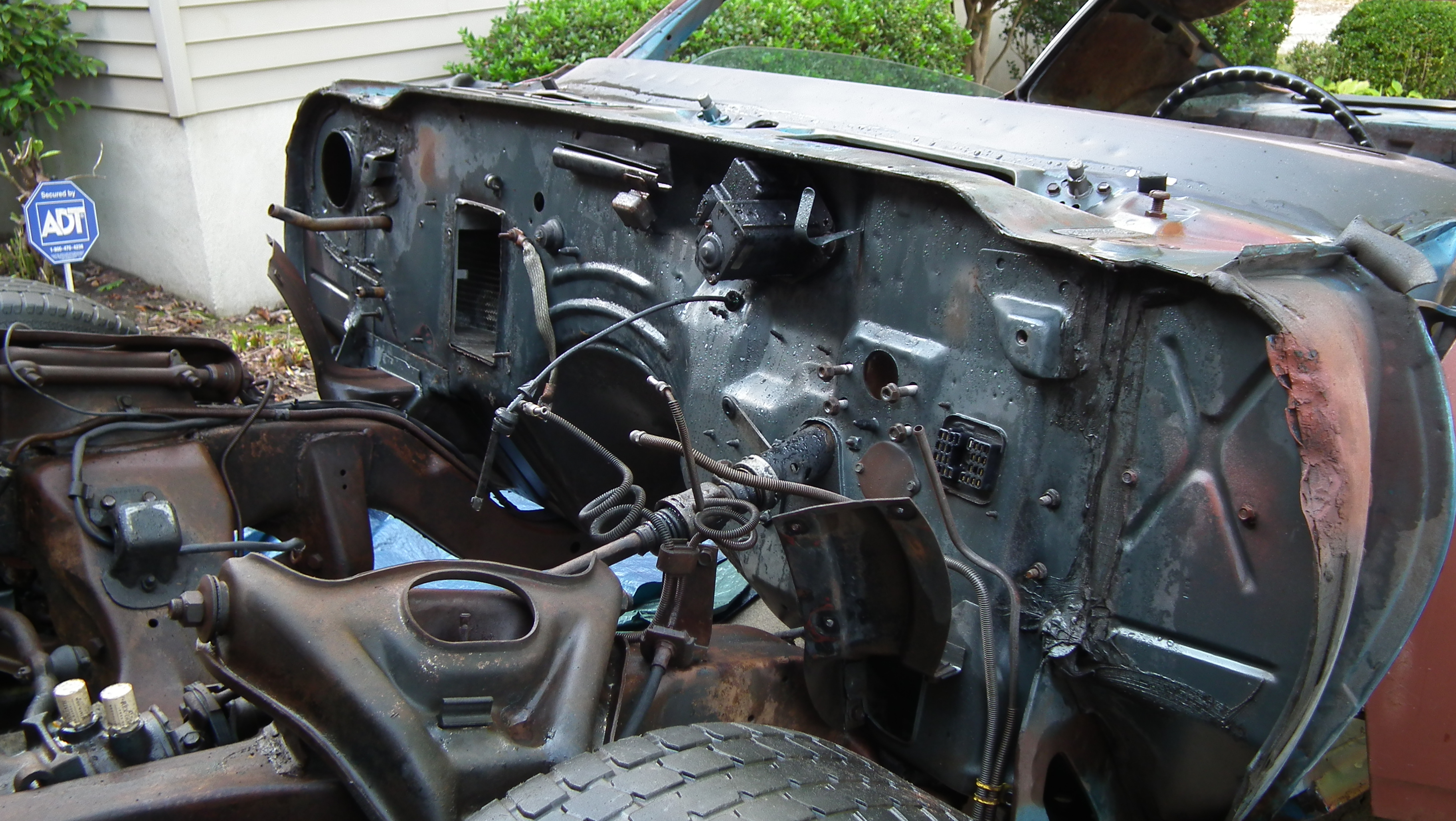

Dash pulled..

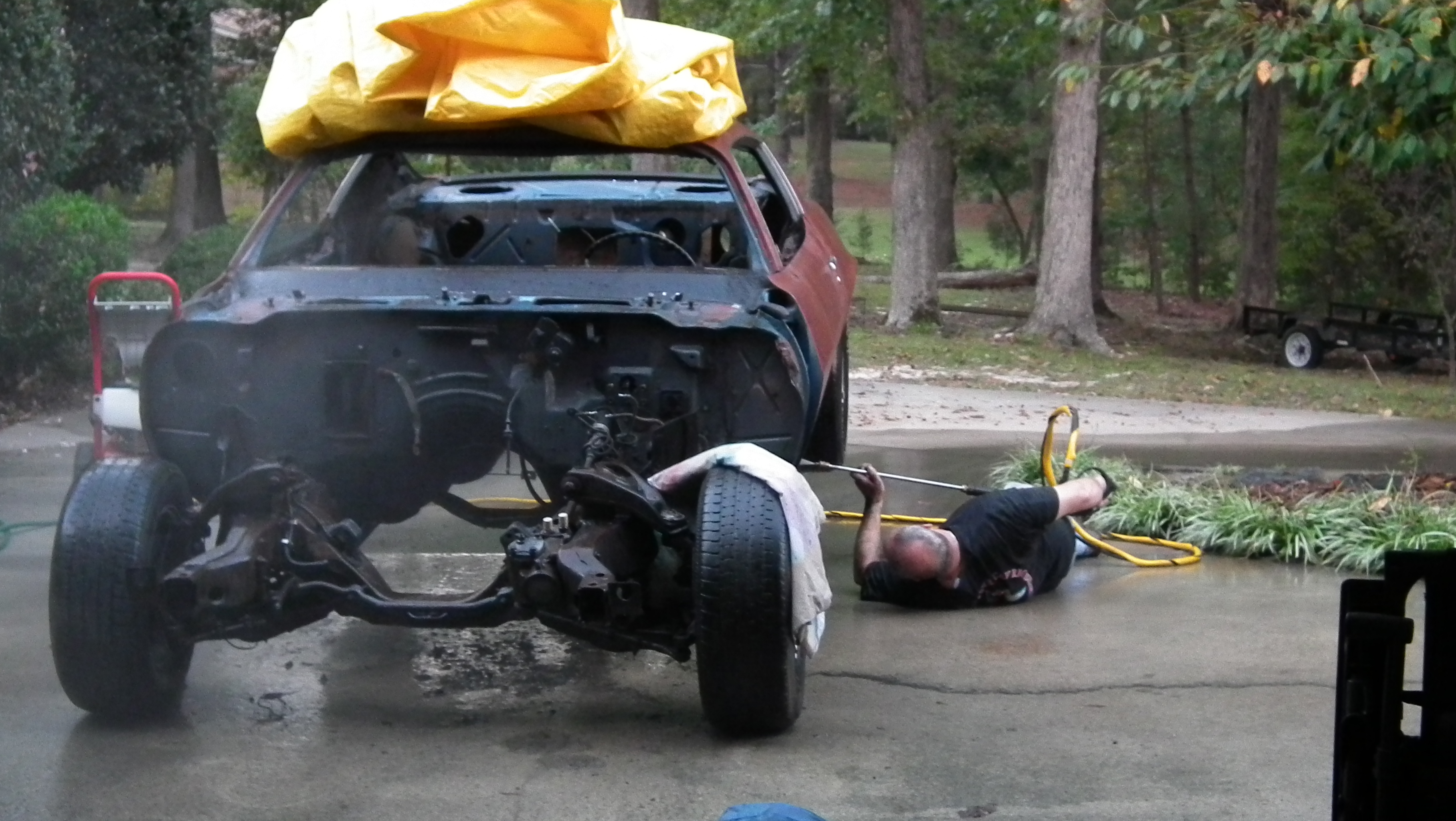

Pressure washing over 40 years of grime from under.....

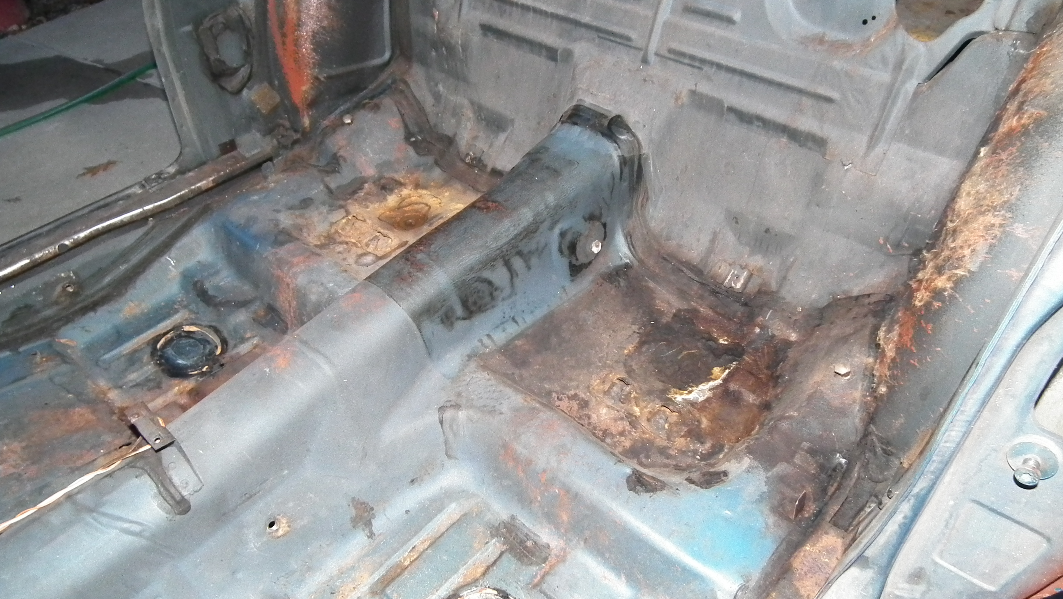

Some more progress this afternoon. Pulled the sound deadeners from the floorboards and was fairly happy with what I see. There is very little rust to deal with on these. I also got the fuel tank pulled and the hanger hardware for it. I will be pulling all the hose hangers from under the car in order to pull all the fuel lines and brake lines out from under it next. I was also very happy with how the inside of the fuel tank looked, so I will be able to reuse this tank.

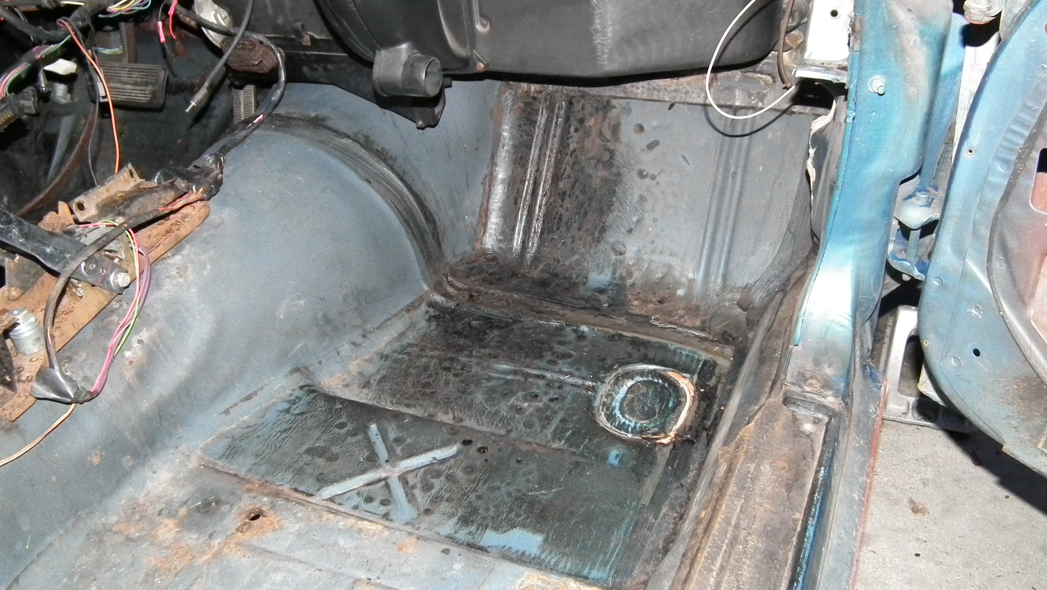

Passenger front floorboar is about as pristine as I could hope.
The floorboard are on the right in this pic had some rust years ago and I ground it out then and fiberglassed the area to keep it from spreading. It appears that this repair did a decent job, but I will pull it all out and weld some sheet metal in for a permanent repair. The other side has some surface rust, but nothing major at all.

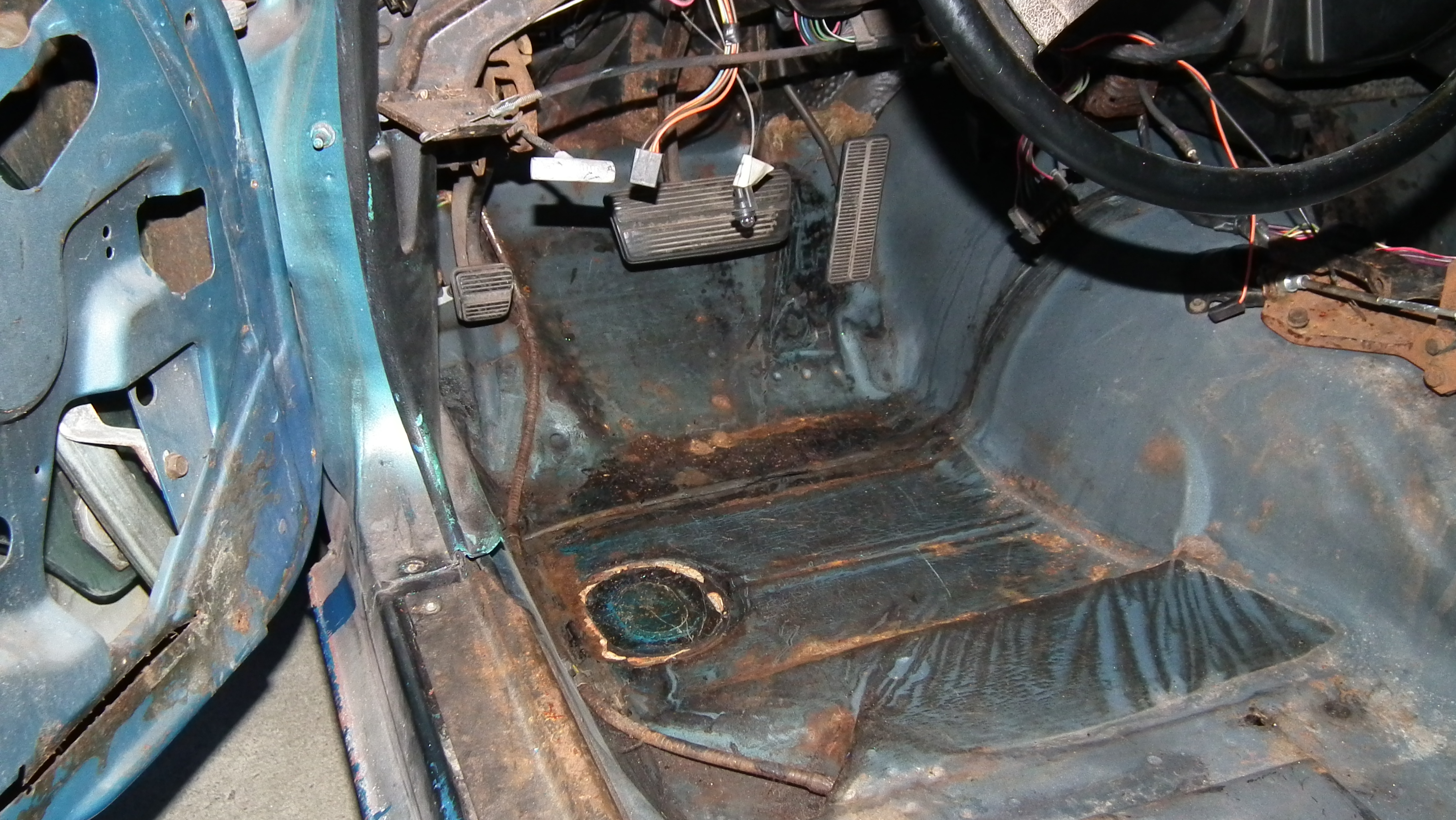

Driver front floorboard is not bad either...

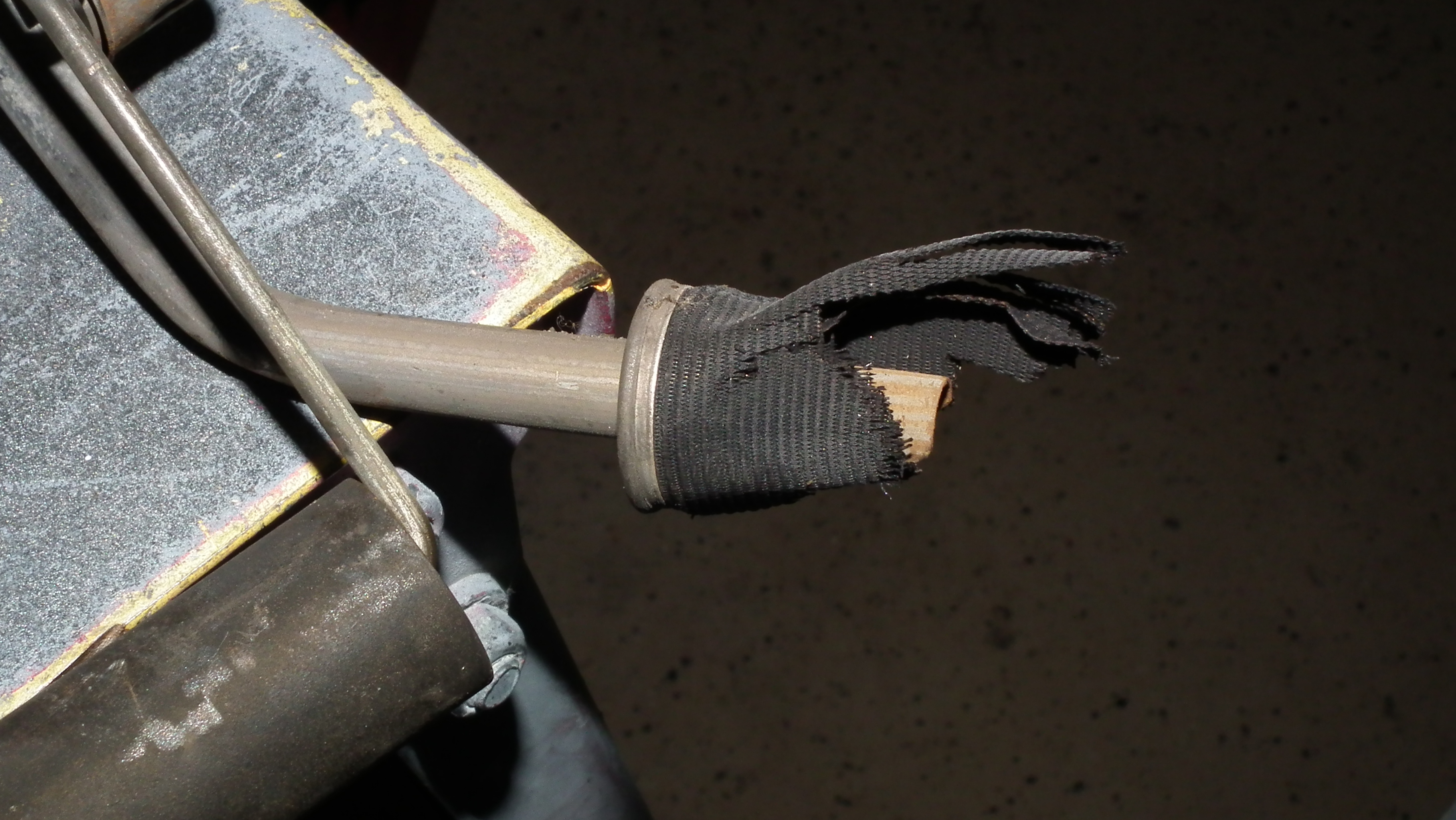

I am not sure if I can replace this filter on the fuel pick up or not... If not, I may just run an in line filter that is easily accessible..

I have no idea if the sending unit is still good. I can put the multimeter on it later to see what it reads. I will also plan on just running an external filter since this one seems to be non replaceable,

I think an external filter is a great idea anyway. I always wonder what the condition is of a filter sock on a pickup when I can't see it, or easily service it.

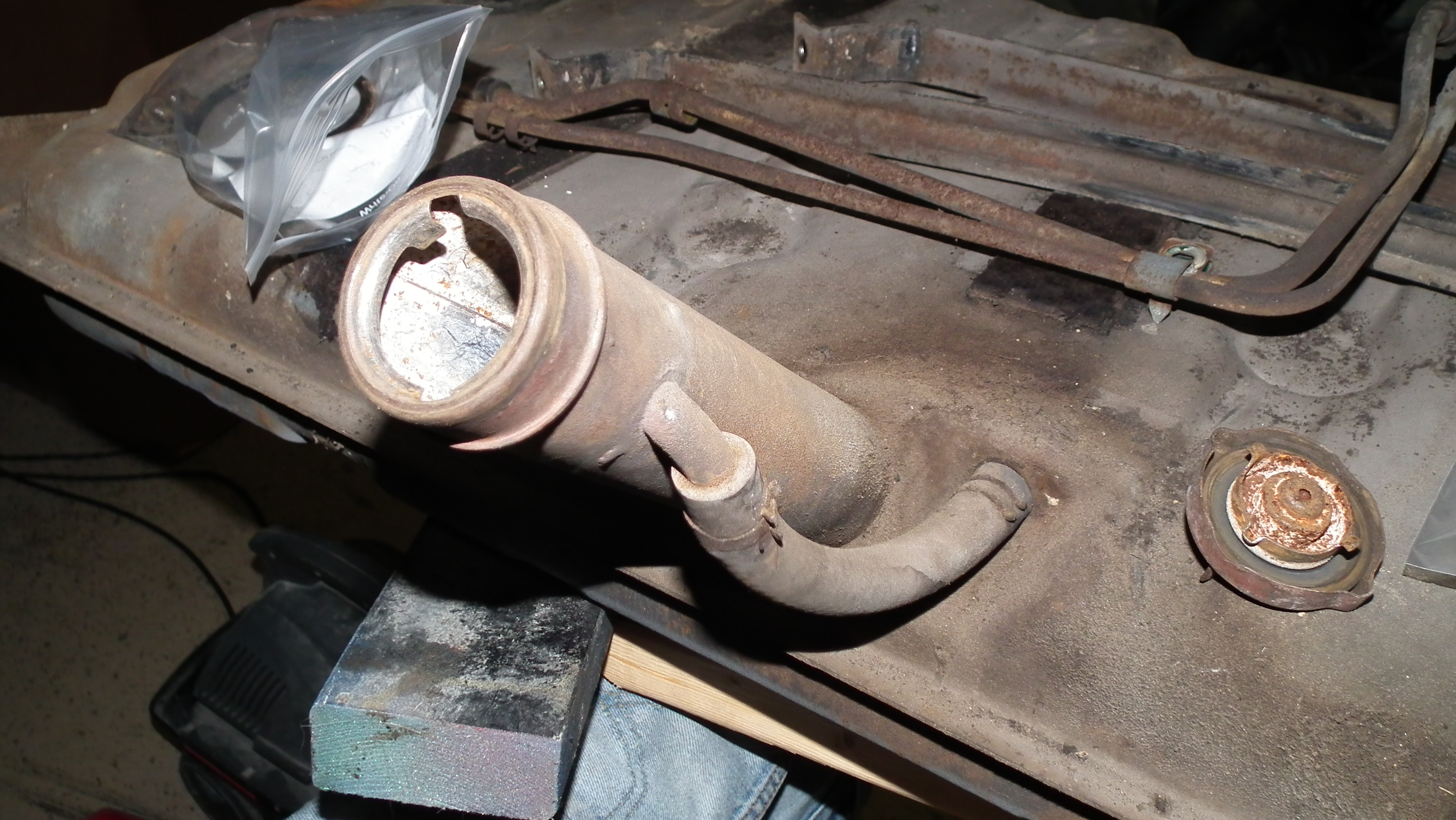

You asked for a few tank pics....
Filler...

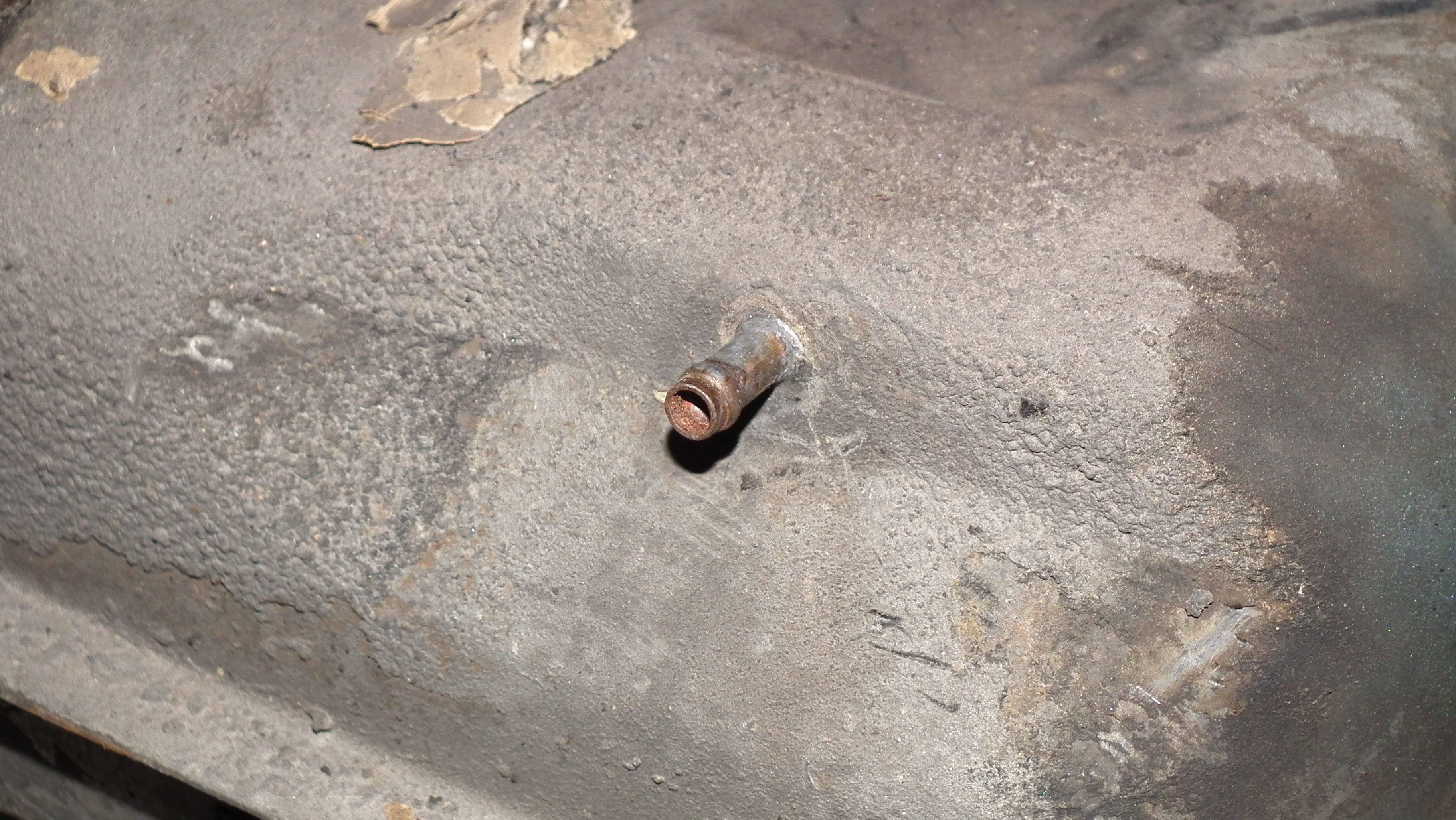

Passenger side leading edge. Two vent nipples on this side. I have not tried to look inside to see if these are straight through or not..My wife reminded me that we smelled fuel when the tank was fuel years ago. Both rubber lines were dry rotted here and I am hoping that is where it was leaking..

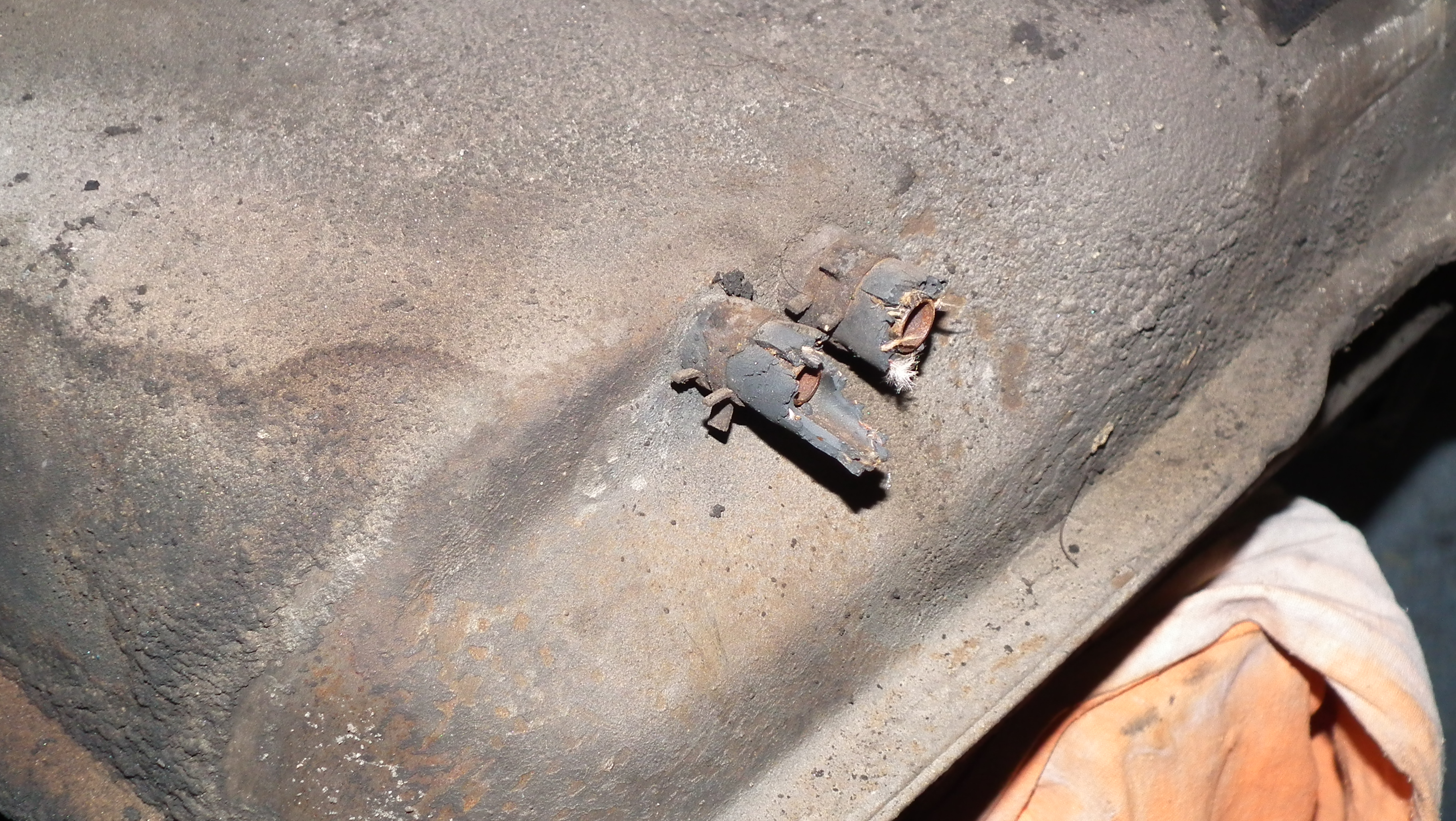

Drivers side leading edge. One nipple on this side. This one and the other two went directly upwards to some kind of evap system that I am guessing I need to keep since I cannot plug all these or I will get a vapor lock situation from vacuum as the tank drains...
Filler...
