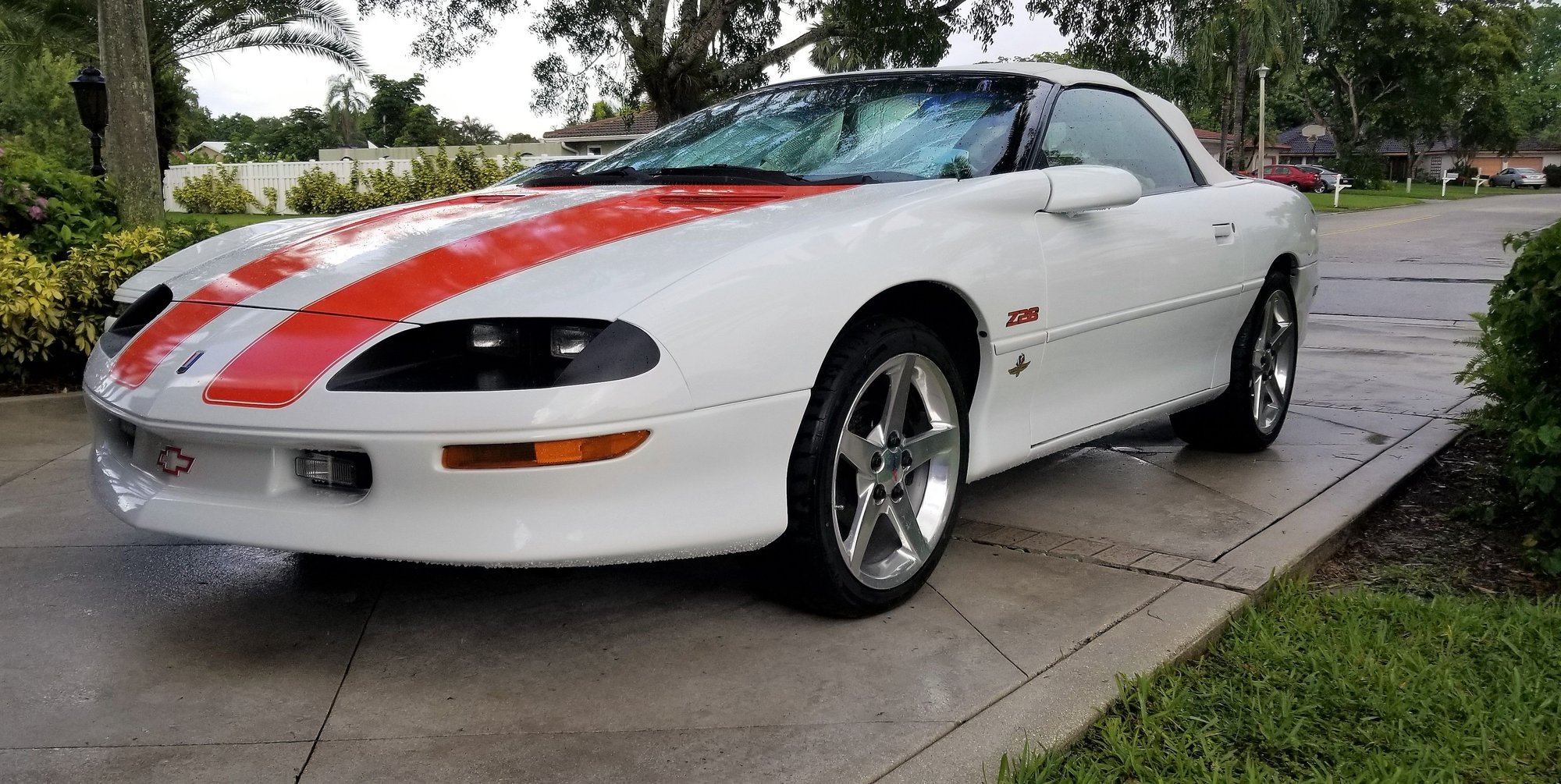

Changed to another tire / rim. felt the others were to big.

I like it

Really like this color scheme. What was your rear tire width before and after?
