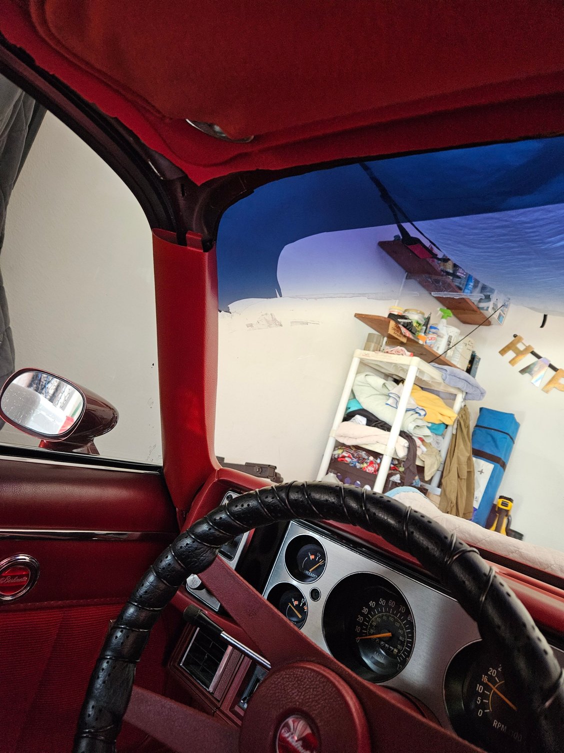

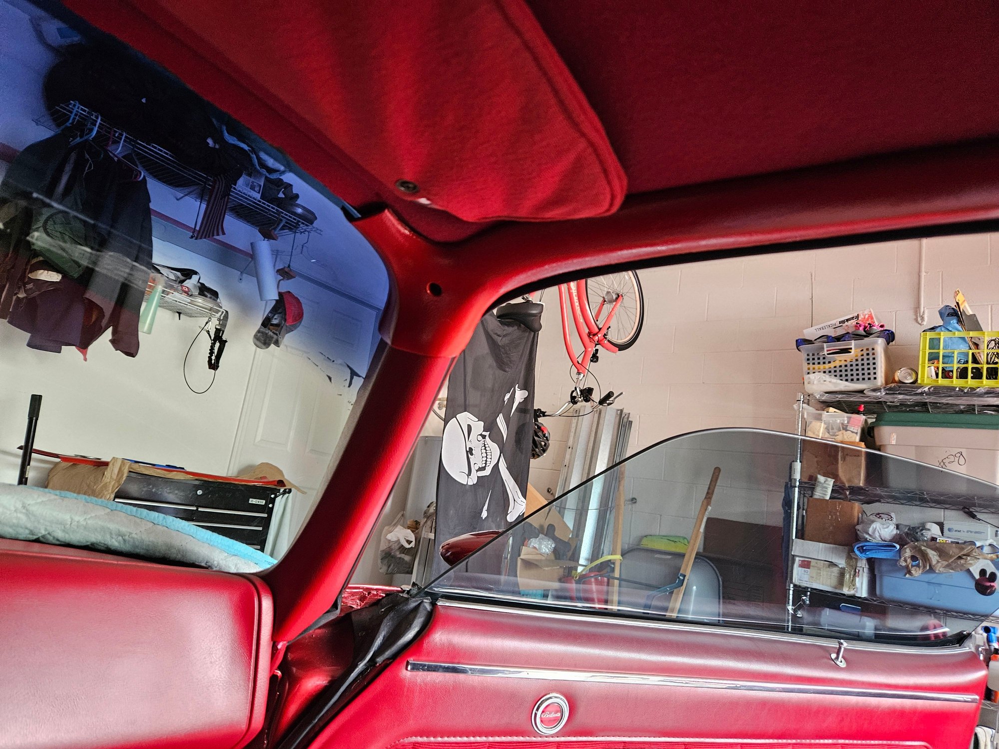

My 79 Berlinetta came off (and went back on) with just the 4 screws. My front molding is metal, which secures against the driver's and passenger trim pieces which are plastic. It did take quite a bit of finageling to get it all to line up so I could screw it on.
Old Dec 31, 2023 | 07:59 PM
OnesAndZeros's Avatar
Joined: Nov 2023
Posts: 34
From: Florida
Passenger side pillar and trim
Headliner front trim with pillar
Driver side pillar, no trim.
Driver side pillar and trim
