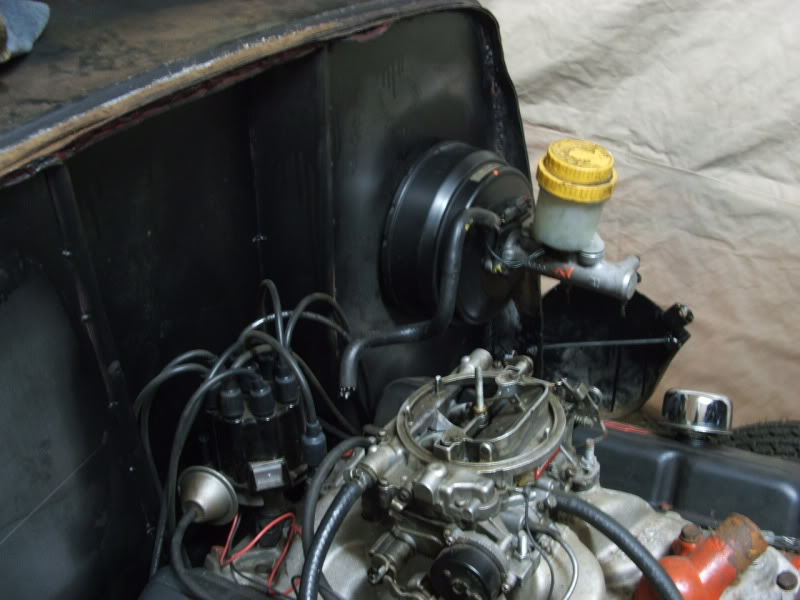

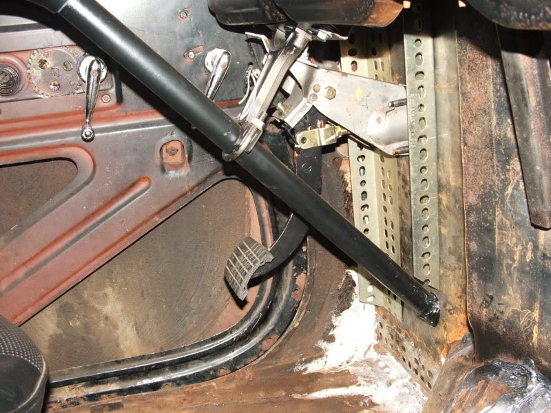

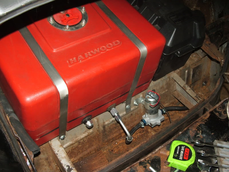

Bought the steel fuel line and AN fittings today to do my fuel supply lines. Installed the Harwood fuel cell and plumbed the lines with my new Pro Comp fuel pump. Got it all plumbed and finished the final bracket to brace my brake pedal assembly to the dashboard. Also got my plug wires and new plugs so it will be ready when I get the wiring harness done.
'92 Subaru Legacy brake master and pedal assembly:

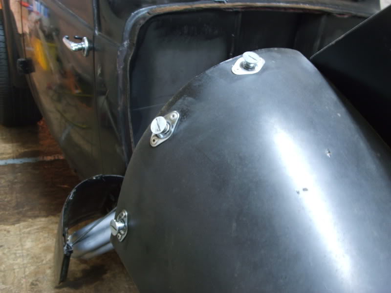

Dzus fastener system to hold the tilt frontend closed:

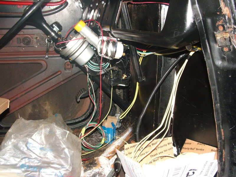

But this wiring is kicking my rear! You'd think an old electrician could just wire it blindfolded, not make it look like he wired it blindfolded!
