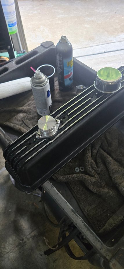

Old Mar 6, 2026 | 12:10 PM
AdamS79's Avatar
Joined: Nov 2025
Posts: 6
Thanks everyone for the help. The original Vortec engine block had an oil fill tube straight into the block.
I ended up with this:
Thanks again for the help!
A
Old Mar 9, 2026 | 07:14 PM
ishayne's Avatar
Joined: Mar 2024
Posts: 5
Looks good to me.
