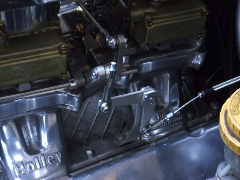

I had a problem with my throttle being stiff too. Mine was partially because the turns in the throttle cable, but your's looks straight. I also had too stiff a return spring. The Holleys have a coil return spring on the primary shaft, so with duals that spring pressure doubles. I went to NAPA and got a double return spring, then took them apart and used one on each carb. Really lightened up my throttle pedal feel.
You might also improve the feel by ditching the hard rod that ties the two carbs together and using a hard rod with heim jont ends. The heim joints are much smoother and will allow free movement of the linkage. I found them at my local Ace Hardware store for $7 ea. and they also had the 10-32 threaded rod in 12" or 36" lengths. Just get two RH thread heims, a couple nuts, and a couple heims. Then you can cut the threaded rod and adj. the joints to fit between the carbs.
Mine are sitting sideways, but you can see the heim joint setup to the carbs in this pic. I've got so many pivot points I had to do something to help it:

I used 10-32 screws with locking nuts and attached to the smaller hole just below that huge hole. You can see it in this pic a little better:
I put a nut on either side of the carb connection, so I could lock it down tight and not bind on the heim joint.
