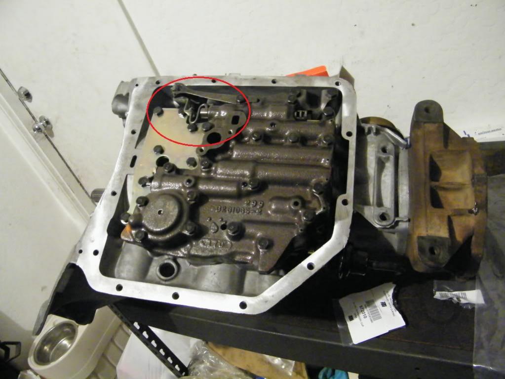

The S clip is what connects you manual valve body to the shift linkage.
I did not have a pic of my trans, but I found one similar on a jeep website.
Hope you get it working.
