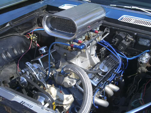

How many accessories are you turning? Mine is bare-bones, only turning a water pump and alternator. I like the serpentine better, as I can't zing the belt off at high rpm's any more like the v-belt used to. I just bought the (March) pulleys I needed and measured for the right length belt. And a little clarification to what 71 was saying about the water pump. A pump for a "factory" style serpentine setup is a reverse rotation, not reverse flow. It still flows through the engine the same, as long as it's turning the right direction. Turn it the wrong direction, and the impellers won't move the water (think water wheel). If the factory pump came with a smooth pulley on it, riding on the back side of the belt, it's reverse rotation. But all the factory serpentine setups I've ever seen have big, clunky, ugly looking bracketry. That's ok I spose as long as you're not going for good looks, and as long as your block/heads have mounting provisions for it.

thanks guys, I guess I will do alittle more research and soul searching on doing this. Camaro69, I like your setup, all I am turning is alt, water pump, and pwr streering. where is your tensioner, I don't see one in the pic, are you just adjusting the alt for the tension. with me having pwr string I don't know if that would work. But I do say what you guys are saying about the bulky brackets, decisions decisions.
Old Apr 1, 2011 | 11:33 AM
Yeah, I set the tension just like if it was a v-belt, at the alternator.
