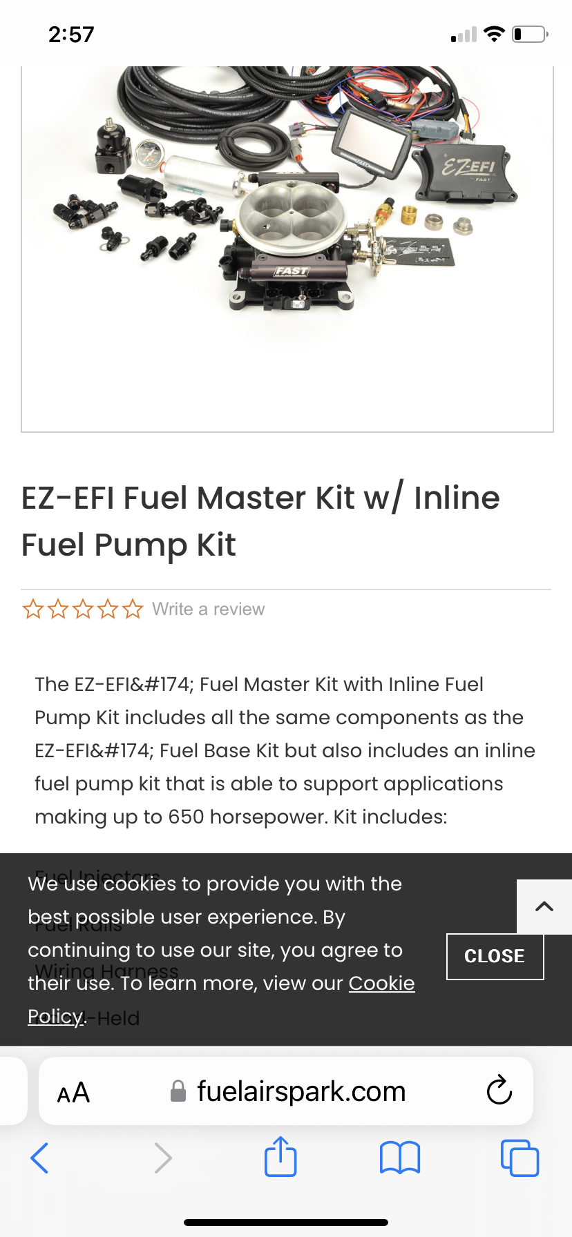

I am thinking I want to go EFI just for the convenience and yes for the wife easier for her. A buddy of mine is selling a fast kit brand new never used he changed his mind. Pretty good price. These are the part numbers have to figure out if it will work for my motor though not sure.
I have also been looking at the ACES fuel injection system wondering if anyone has used it?

I really like what I read and see on this FUEL brand EFI kit. Have heard good things with the FUEL brand and it’s self learning
