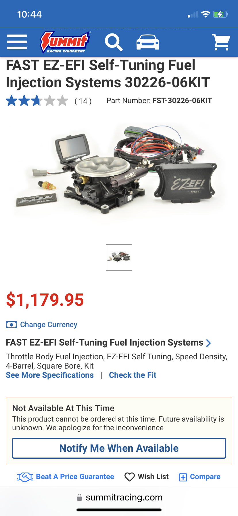

Hello all I just purchased my first Camaro it is 1978 Camaro Z28 with 383 Stroker and 4 speed. I would like to switch this to EFI and Electronic ignition. I Just don’t know much about the EFI stuff and what kit I need to go with so may out there?? My car is just a Sunday nice weather driver only. I have looked at this kit. Any advice would be amazing!!!

That is a nice EFI kit but it will not give ignition control. Your car original came with an HEI ignition, but the computer cannot control it. There are benefits to being able to control spark timing. If you add in a knock sensor you can protect your motor from bad gas and you can tweak a little more fuel mileage and power out of a motor with spark control. Don't get me wrong the car will run fine without spark control you will just need to be conservative with a higher compression motor.
The fast stuff is good and you want self learning.

If it's just a Sunday nice weather driver I wouldn't spend the money on all that,it's a nice kit but a lot of money for little gain if any.
Your HEI distributor (assuming it's still the OEM) is about the most reliable ignition you can get.
What do you have for a carb and intake? If more power is your goal there may be room for improvement there at far less cost.
If it's already got a nice setup I'd say don't fix what ain't broken and spend the money on gas driving it.
That's my 2 cts.

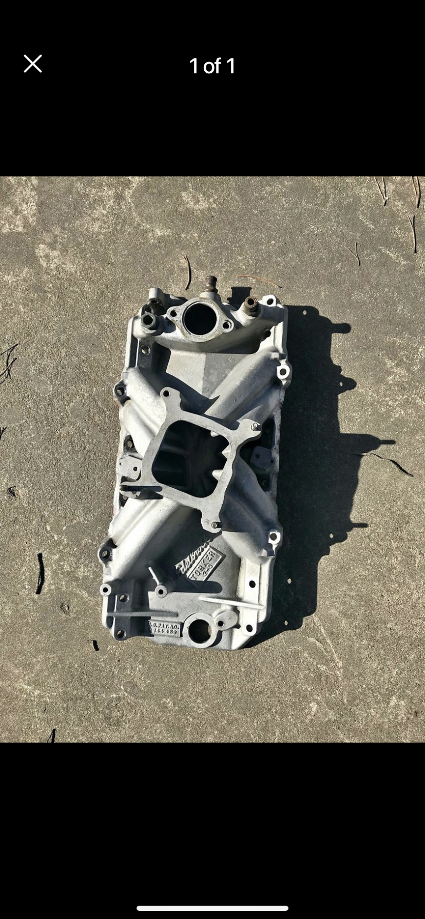

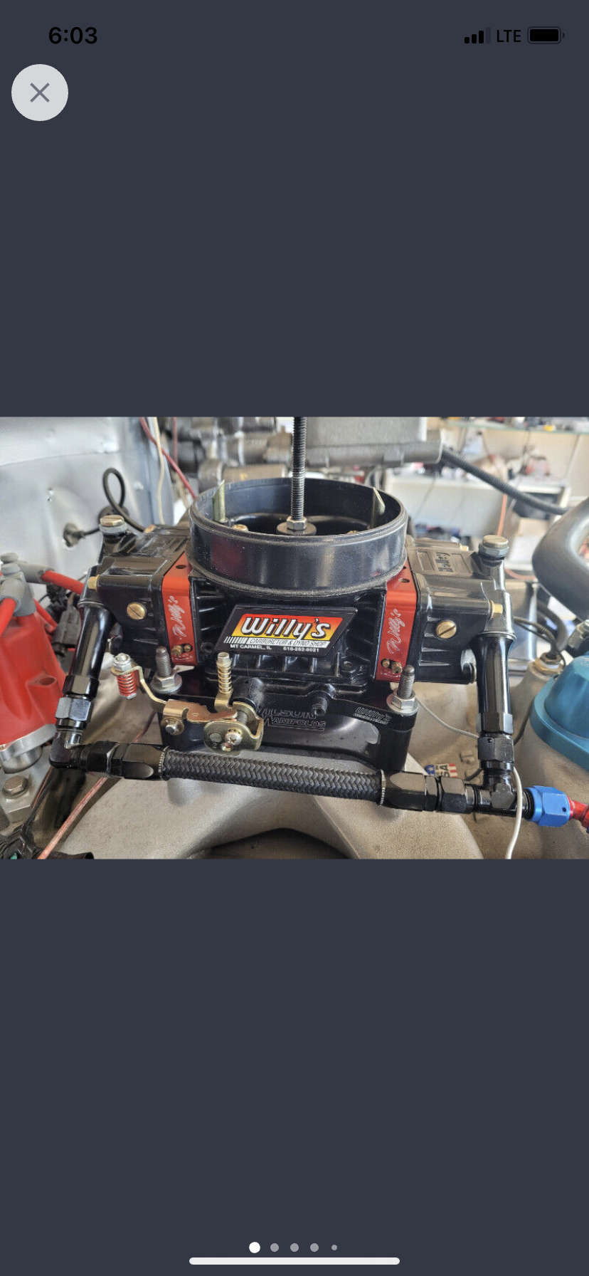

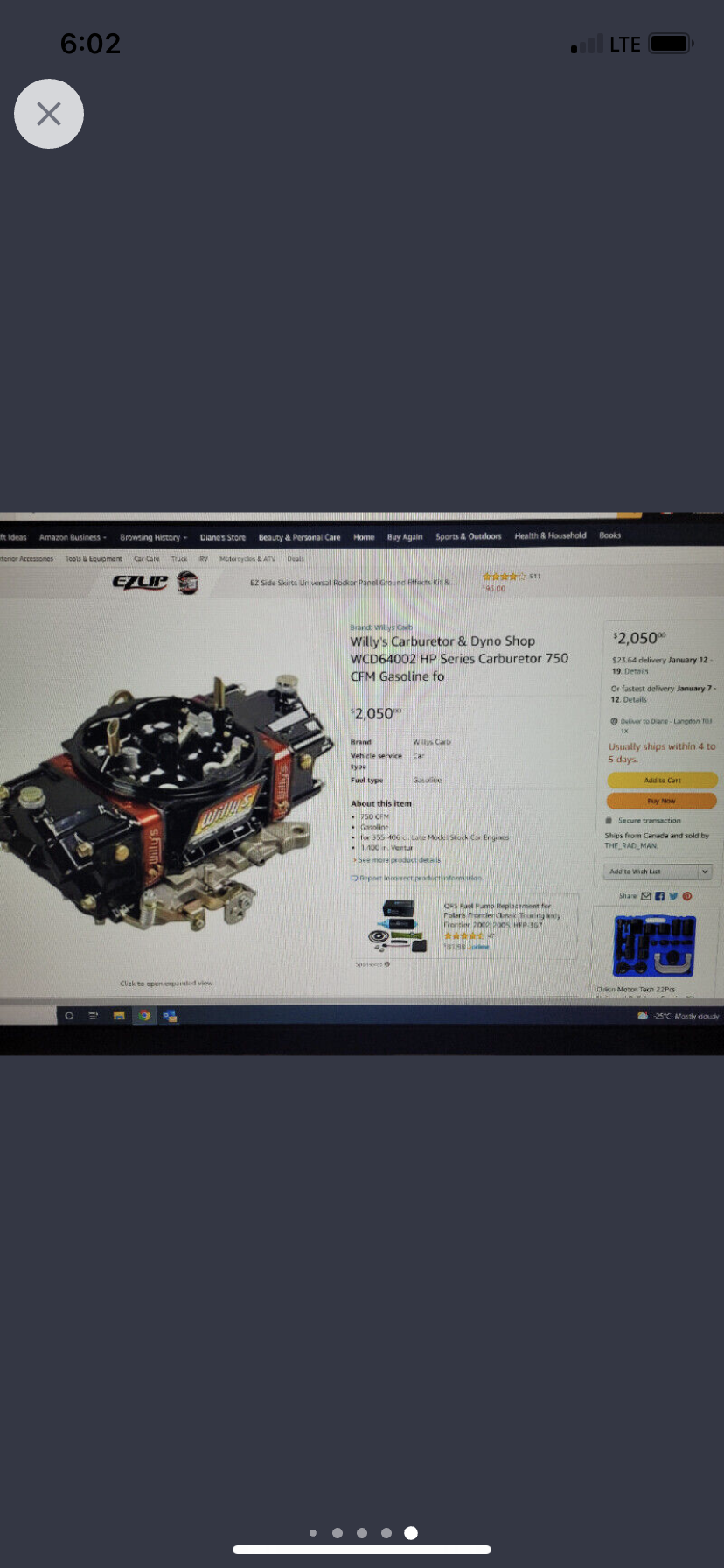

Hey as far as the motor being a build or crate that I do not know there is not a lot of known about this car and build. I have been working on trying to find the person who restored. It sure seems like they but some good parts in it and have done really good work. I would be interested in the intake and Holly double pumper you mentioned. I have found both the intake for 160 used and the carb for 600 basically new.

I believe this is a big block intake,I had one just like it on the 427 in my old '69.
I've never seen one on a small block,we called them a twisted Torker back in the day.
