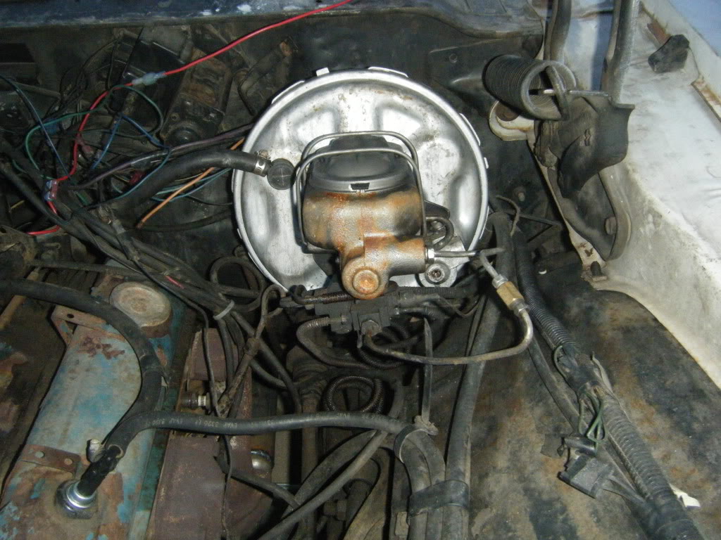

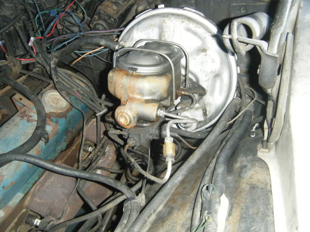

Angry pictures
here are some pictures of the new master and booster. instead of running a new brake line look at the mickey mouse crap, they did

Old Feb 16, 2010 | 10:25 PM
  #25
edog2's Avatar
May 2010 ROTM Winner
Joined: Sep 2009
Posts: 632
From: Harlem, GA
Originally Posted by Dj Aztek
wow
X2 for you.
Old Feb 16, 2010 | 11:03 PM
  #26
That's just plain nasty at any price!
do you guys think thats whats wrong with my braking problem.
Old Feb 17, 2010 | 08:41 AM
  #28
edog2's Avatar
Joined: Sep 2009
Posts: 632
From: Harlem, GA
Thats the front line so if thats good then its not the issue. Just evidence of sorry craftsmanship. That being said, I may do stuff like that to myself, but not if someone was paying me and if I did HAVE to do it I would at least explain why.
