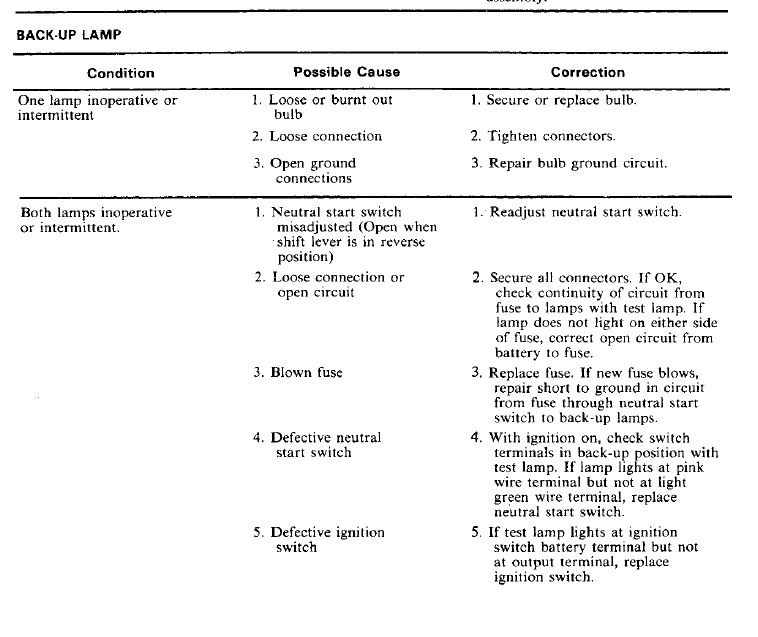

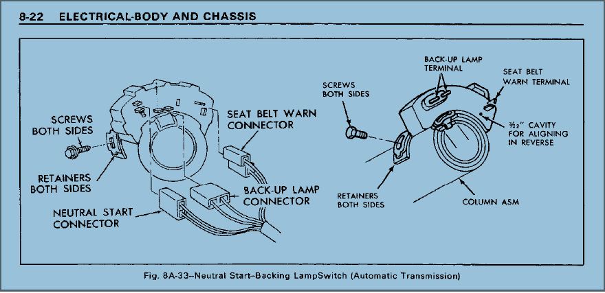

Sounds right. Here is a clip from my 79' service manual. I threw in some trouble shooting instructions for you too. The remove and replace instructions were about worthless, i didn't want to confuse you so I won't post them. I'm also giving you a link tthat has some good info on where the wires under the dash go. It a long thread but most of the stuff relevant to you is toward the front. Factory Gauge Harness Connector - NastyZ28.com
If you have issues with the little pin being sheared of or something let me know. I can e-mail the page from the book to you.
Switch

Trouble shooting

The switch in mention does more than backup lights. It's backup lights, neutral safety, seatbelt warning, all in one. Easy to replace, and adjust.

im still kinda confused though. the switch that i have only has one connector to it with pink and green wires. so would i just leave the other two not hooked up to anything ?

Pic? Plug everything in that can be. That may even be your issue. If harness isn't plugged into the switch.
Old Aug 10, 2012 | 10:49 AM
  #18
Or it could be that someone put a different switch in that isn't correct for your car. I'd also like to see the pic of your switch. Maybe it's wrong, broken pins, or???
I would definitely get the correct switch and plug everything in. I bet you've only got the neutral safety now.
