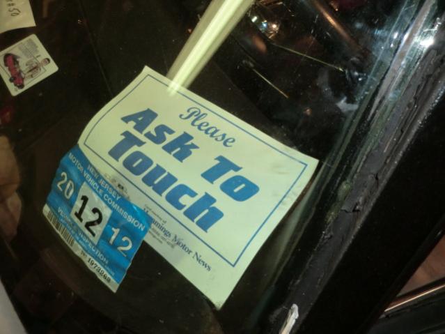

Looks like a good fit to me. I don't see an issue at the VIN, or did you fix it in this picture?
Old Dec 15, 2011 | 04:01 PM
  #42
rydeer's Avatar
Joined: Oct 2011
Posts: 527
From: so NJ
look at post 36 the pic at the inspection sticker show it off a little clearer. I did not get it any better this time. It is 1/2" from the metal of the dash and you can see the plastic of the dash pad.

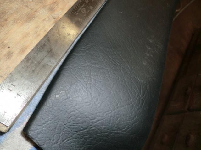

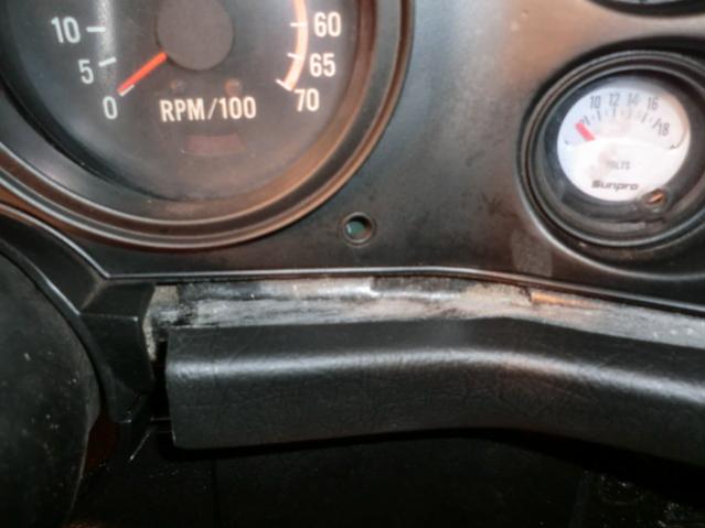

Heres more info from today.
Attached Thumbnails Dash Cap vs New Dash-004.jpg   Dash Cap vs New Dash-006.jpg   Dash Cap vs New Dash-003.jpg   Dash Cap vs New Dash-007.jpg   Dash Cap vs New Dash-016.jpg

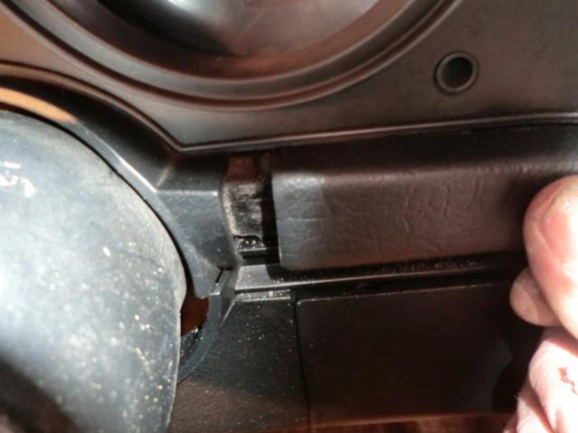

there is more drame to come. This how I will address the prob at shows.LOL It helps that NJ puts the insp. sticker right there.
On the right side under the inst panel the cover is a little short.
Both ends have a slight gap.
Left side under the dash fits good.
Sounds like I'm whinning a lot, I'm just trying to inform. My dash looked crappy. It does look much better and most of this stuff I'll be the only one who sees it. I'd give it a 7 out of 10 for looks. A 3 out of 10 for ease of install. Thank god for tilt wheel. And also that I had it all apart. Trying to install together would have made me nuts!

there was info type into post 45.. It is out of wack at the pen to the edge.
That is the mfg of the cap.
The last pic is of it glued in with the A pillar cover installed.
