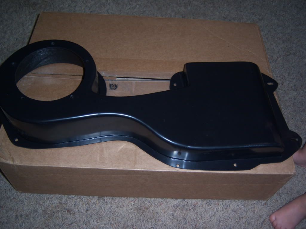

You can buy a conversion box that deletes the suitcase for about 100-150 bucks. I had one until I smoothed my firewall. I'll sell it for 75. Its still new.
And gee Mike it even matches you car color.

Its on the shelf. I offer it up for sale when people ask about deletes but I'm not actively trying to sell it.
