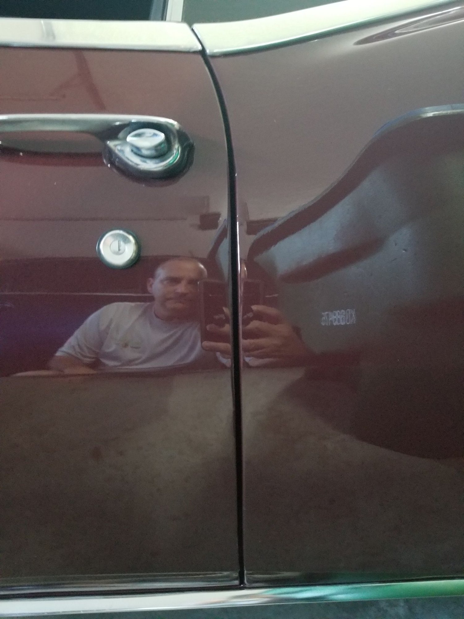

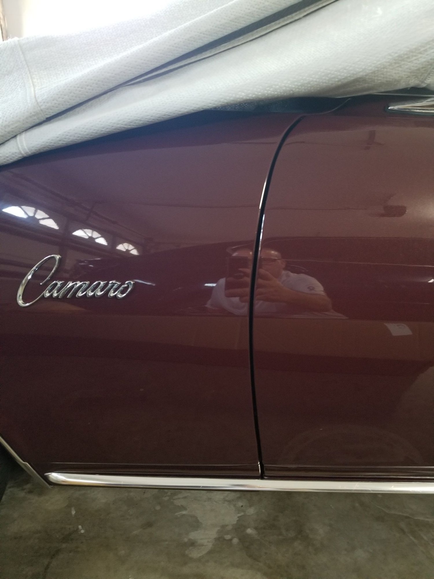

Thanks for the suggestions on where to look Everett#2390. The body panels are perfect, and I checked the subframe index holes (where the body has a hole in it to line up the subframe with a pin) and those are spot on as well. Ill experiment this weekend with adding a washer to one side or the other (or all 6 points if needed).
I appreciate the help and let you know what happens. sorry for the giant pictures, ill figure that out too.

Yes, reflections look straight.
Maybe drop/loosen column bolts and allow self-alignment then add/subtract shims?
