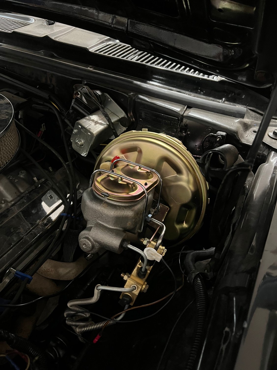

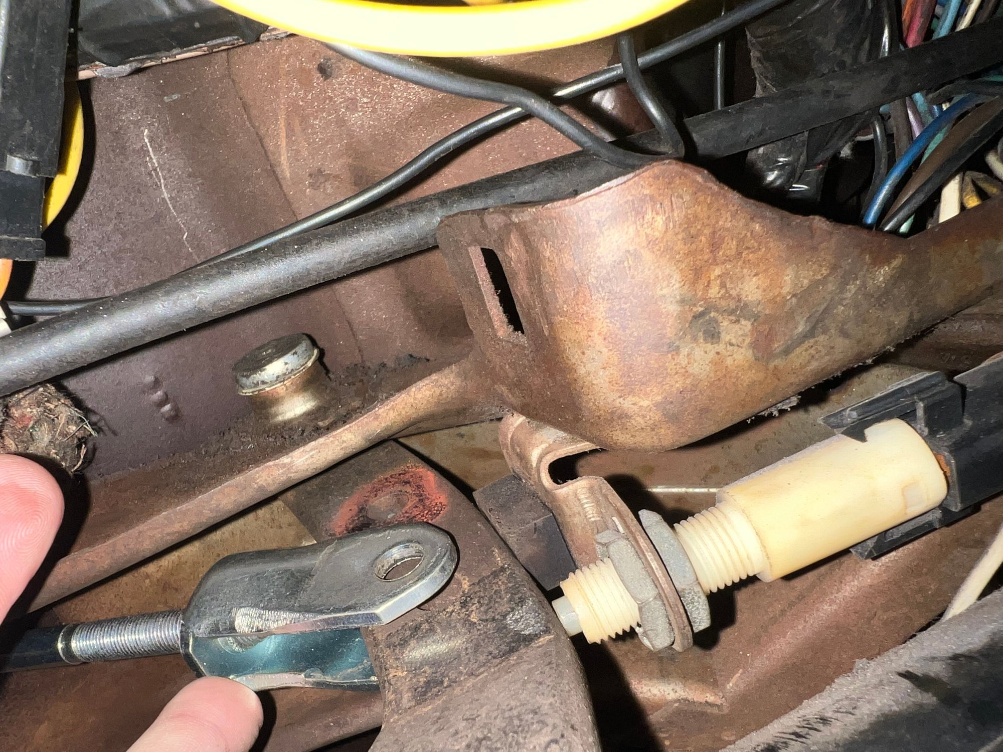

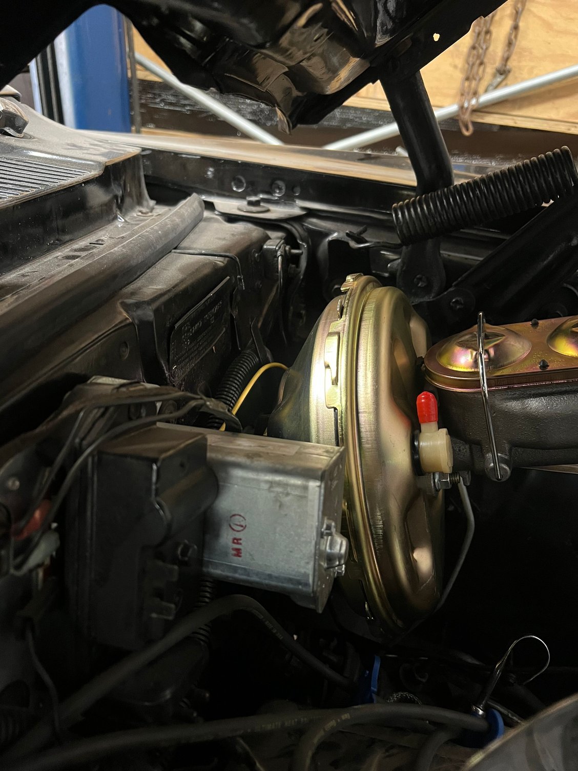

Hi,
I have a 68 convertible and did a right stuff disc brake conversion with manual to power conversion also. For the booster when it attached to the actual brake pedal. It is not fully going back to hit the rubber stoppers. See pictures. Did I mount it incorrectly? Or is there some modification that needs to be made? Also if I Try to push it up to the top hole on the brake pedal it doesn’t come close at all

Adjust the switch forward.
