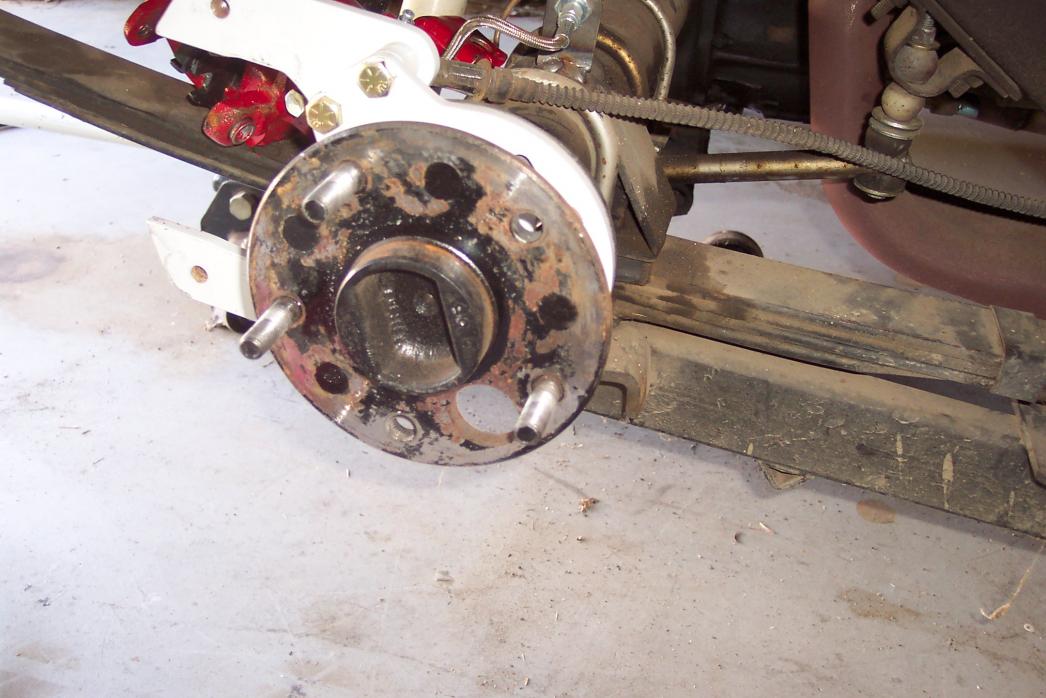

The brake brackets. I had to replace two wheel studs while I was in there.

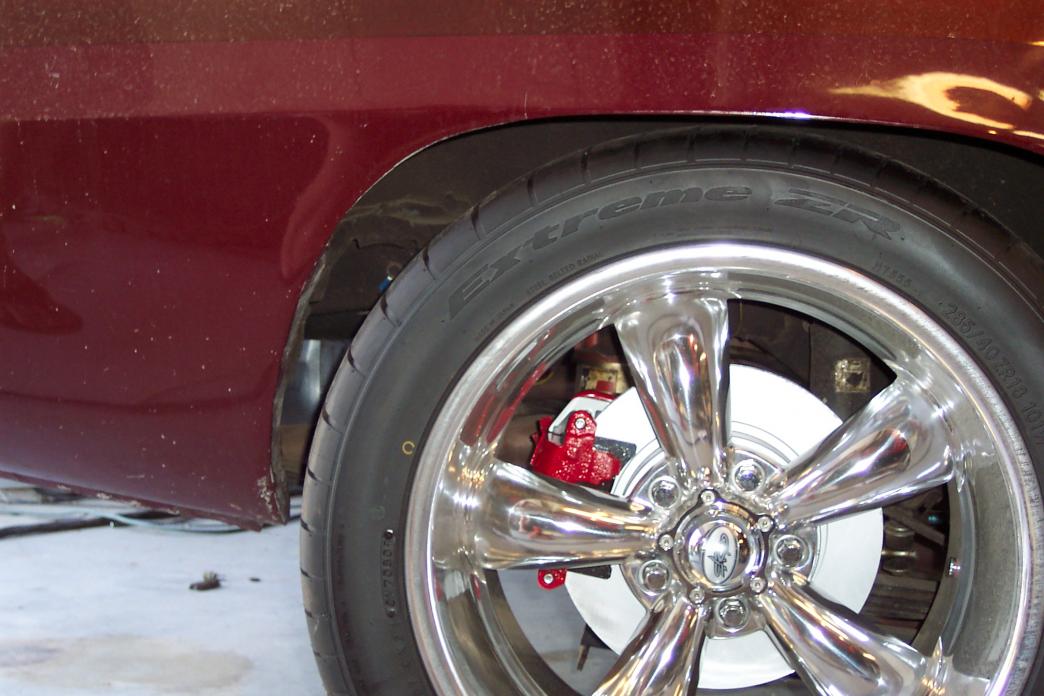

I painted them red so they'd show nicely behind the Coy's Wheels.

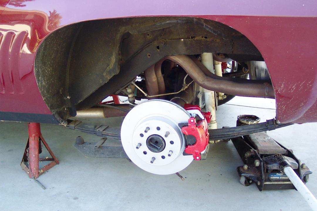

Assembled. You can see the stock parking brake cable hanging below the disc.

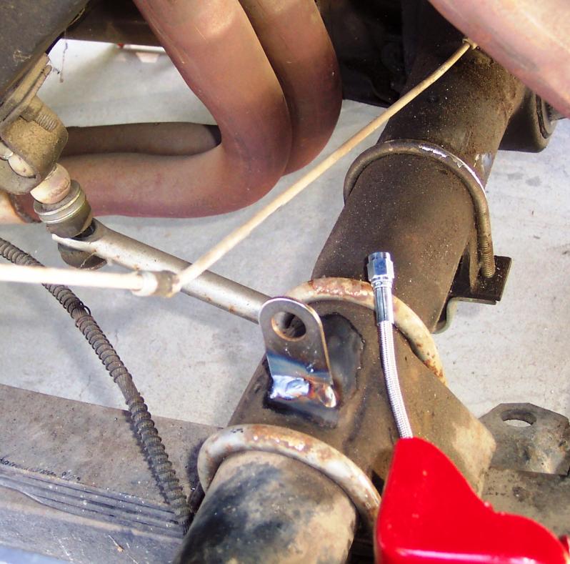

The brake line tab welded on the axle tube.

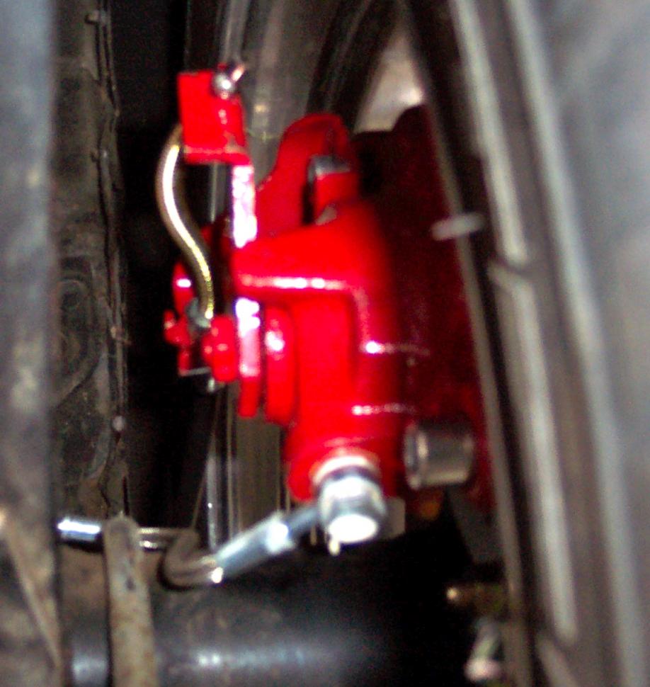

You can't really see it in this pic, but this is the adjuster for the Lokar cables. I somehow got them too tight, so the left parking brake was almost on all the time. An easy fix, but one to look out for if you do the same modification. The adjustment nuts are the ones you see on the ends of the black cable sheaths.
