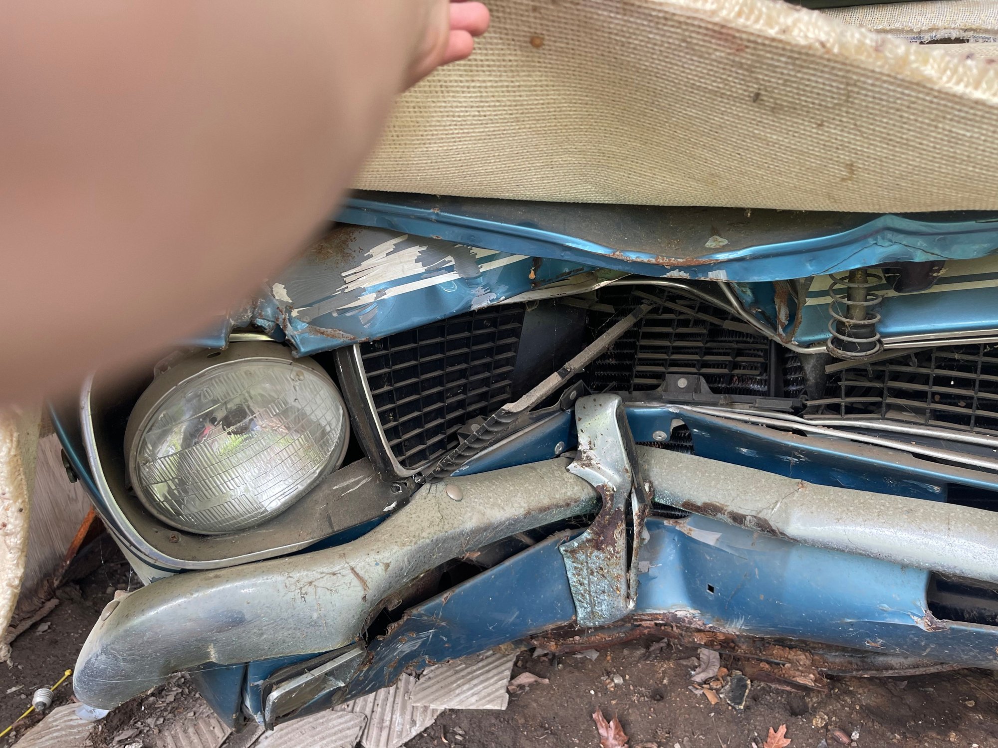

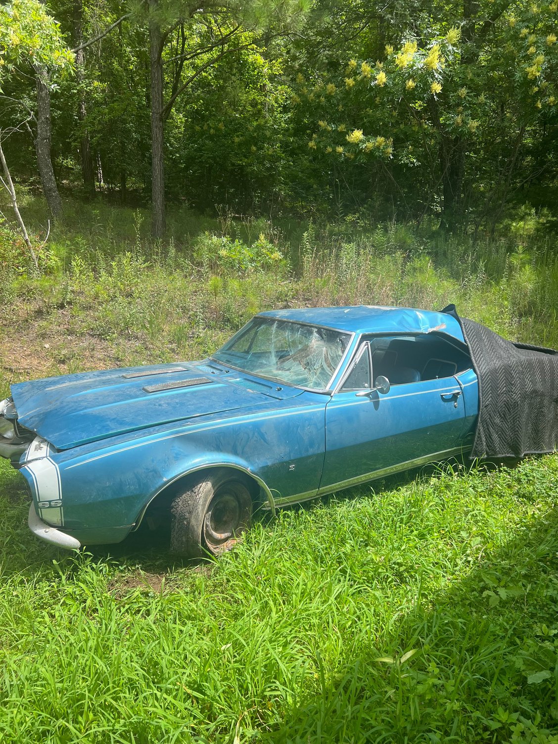

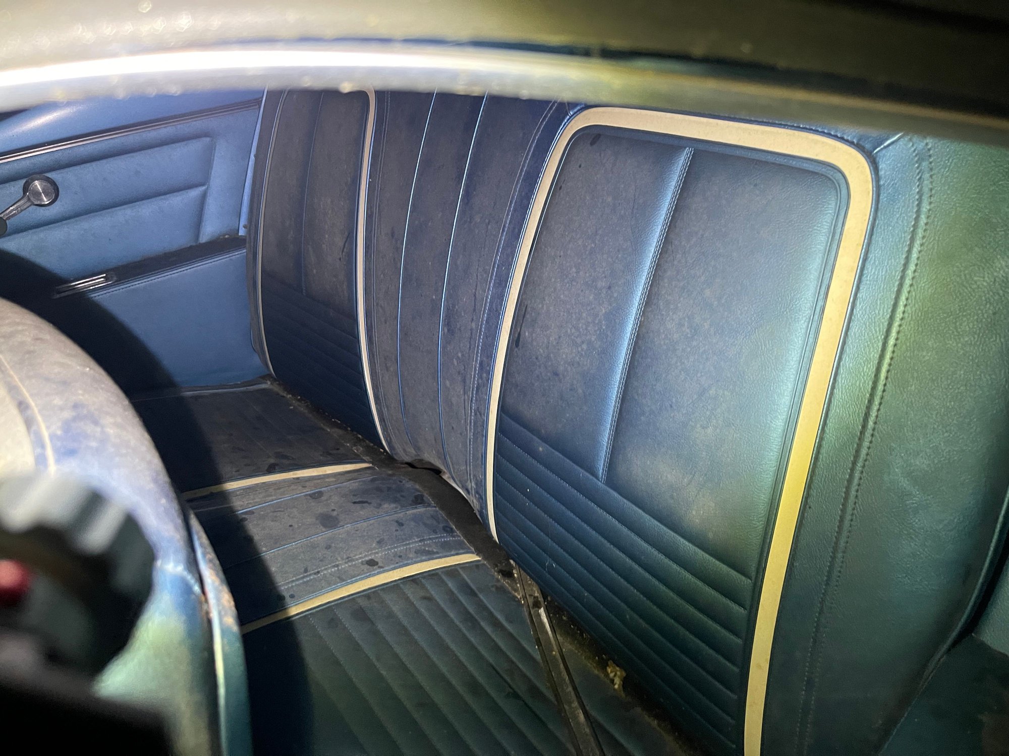

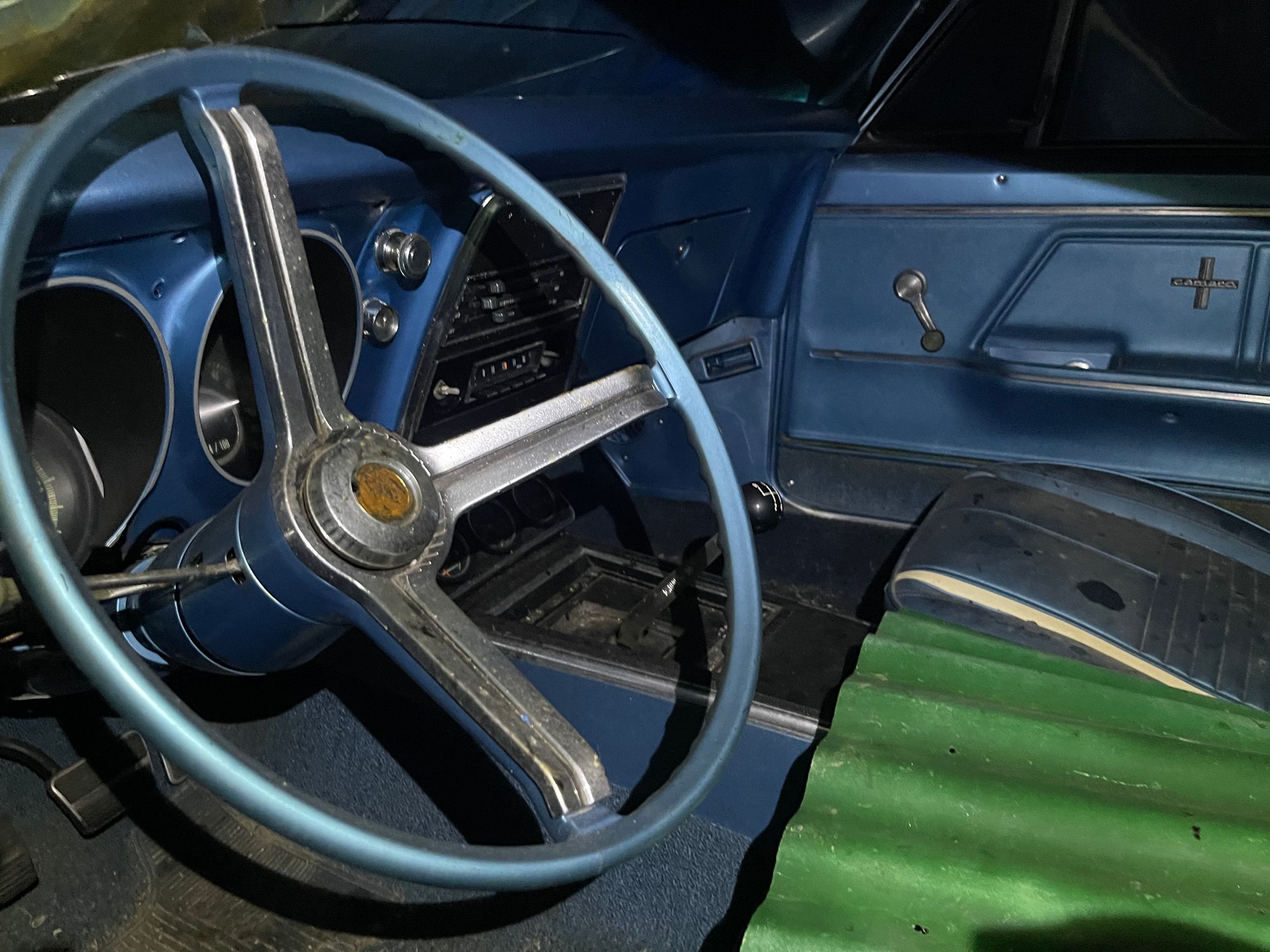

I have a 67 Rs/Ss that has sat for years. I found a restoration shop to use. I plan to daily drive the car. I do have front end damage. I’m sure shocks and everything under the car is original. I was thinking about just buying a frame kit with suspension brakes the works. It is 13k but could be worth it instead of piecing together everything. I was wondering if anyone has done this and their experience with it. I am planning on dropping in a crate engine 350 with 500 hp or 572 yes I know the 572 would be overkill but thinking of options. Hopefully going to keep trans after the swap. Interior and backend panels are still in great shape. So at least I have that going for me. I want to spend 50k or less but we will see what happens. There are so many options before I buy parts I’m wanting to narrow down a solid plan.

Is the existing frame straight? If not, it may make sense. What you call piece together I call make it the way you want it. Matching brakes and a well thought out suspension is more important than the easy of just slapping a new sub frame in there. What I am saying is if I was spending that kind of money I would be buying complete suspension and brake setups for the whole car not buying a complete front end then try to match that.
