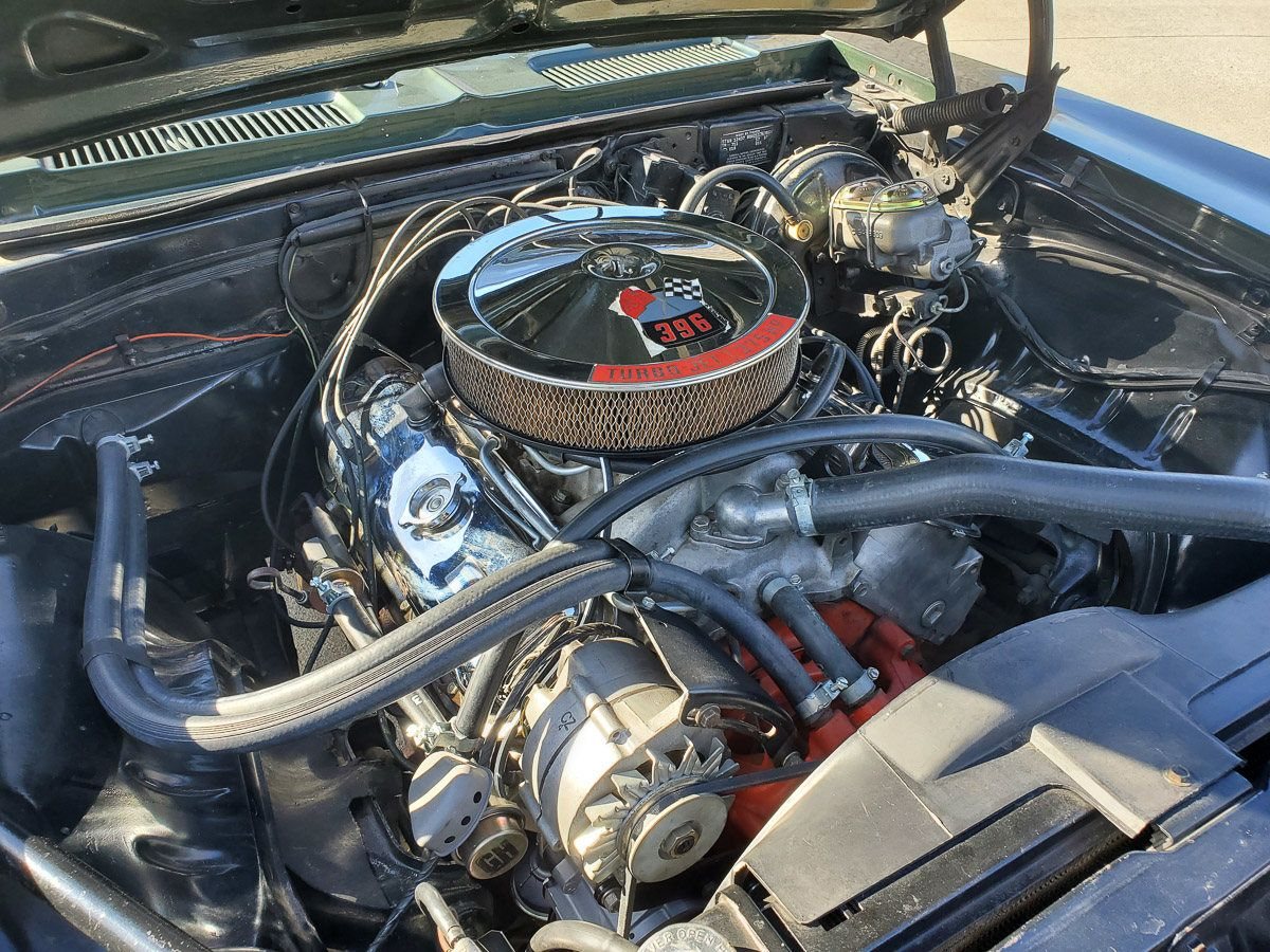

Well if you are going big block take note that you will need to change the heater core to a big block core.
The BB core relocates the heater hoses out closer to the fender to clear the bigger motor's cylinder head.

Thanks, while looking up parts I couldn't think of any reason not to just get the stock 6 cylinder core. Any other pointers would be greatly appreciated. Do I have to have the cowl induction hood? Will my powerglide transmission mount work?
Old Nov 4, 2023 | 07:14 PM
Well it's been over 40 years since I had my '69 that I swapped a 427 into replacing a dead 327 and I had a 4 speed.
Not sure sure you'll need the hood if using a stock intake and carb,I had an aluminum highrise intake and big Holley double pumper,the hood wouldn't close with an aircleaner on the carb so I had to swap it out.
I think you'll need a different trans mount and probably have to move the crossmember back for the T-400,hopefully it's a short tail trans,they come in two lengths so that's something to research.
Big block springs up front would be a good idea and multi leafs in the back is almost a must have.
You'll also need a big block radiator and fan shroud,some guys go electric fans but I've seen many posts where they didn't get it done,better to have a 6 blade fan and a shroud IMO,these big blocks do run pretty warm.

Thanks for the info. Trans is short tail. All the rest agrees with what I've researched. Where did you pick up the heater core cover on the firewall?
