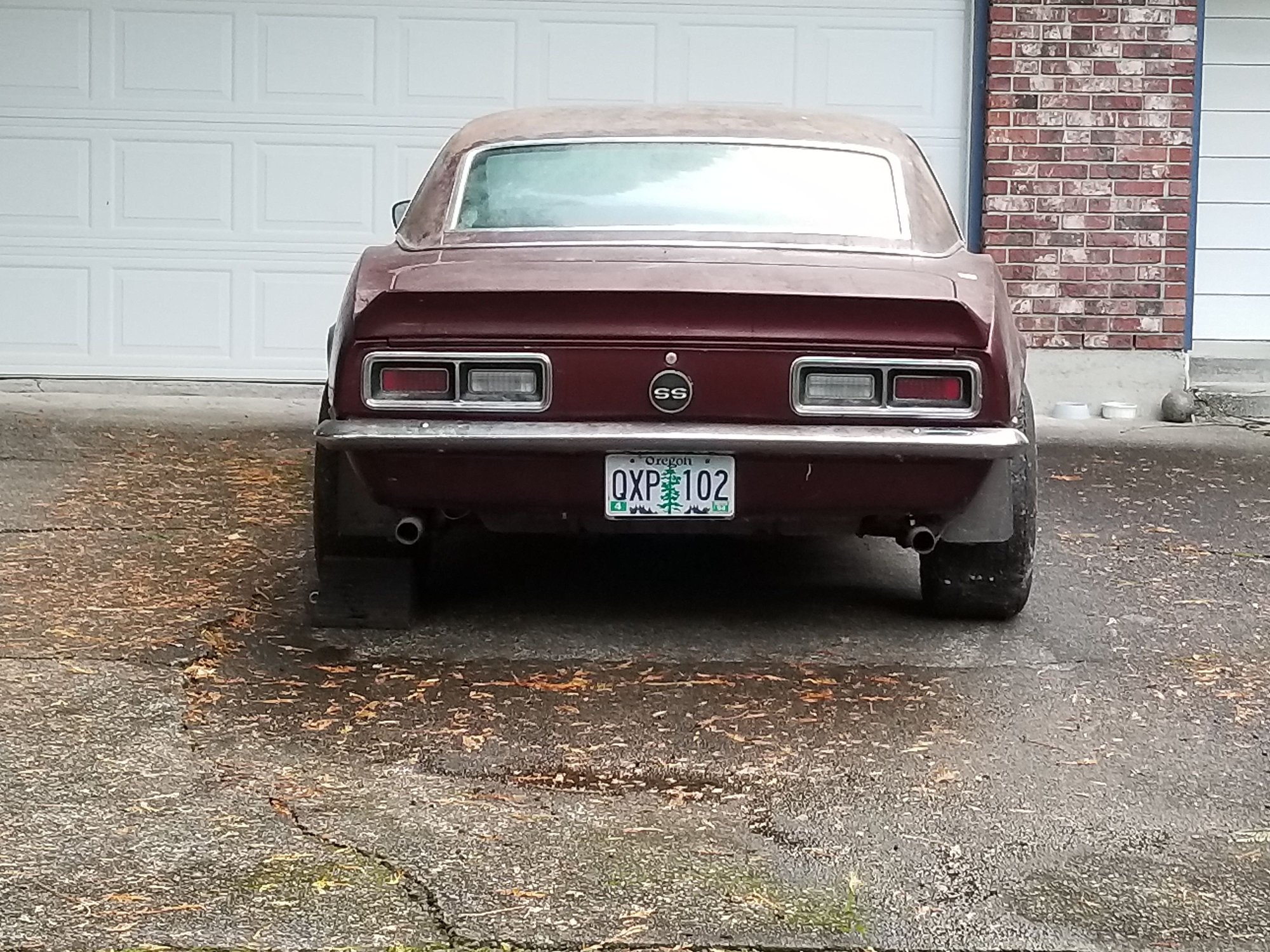

Boy, wide tires! Mine were (and will be) 245/60R15, which is slightly less diameter, and already fill those wheel wells! Here is a look:
I know I've said for years "if some's good, more's better" but I try to only say that where it's likely to be true. My rims are Centerline rivet models, and once upon a time, I measured them, but can't seem to find it at the moment, and they're 190 miles away. Anyway, I haven't checked to see what losing 1/2" in diameter does to RPM's but just sayin'... I know in my 4-wheeling days, we used to find that there is such a thing as too wide, in relation to the weight of the vehicle, and at least in snow or clay, fat tires were bad news.
