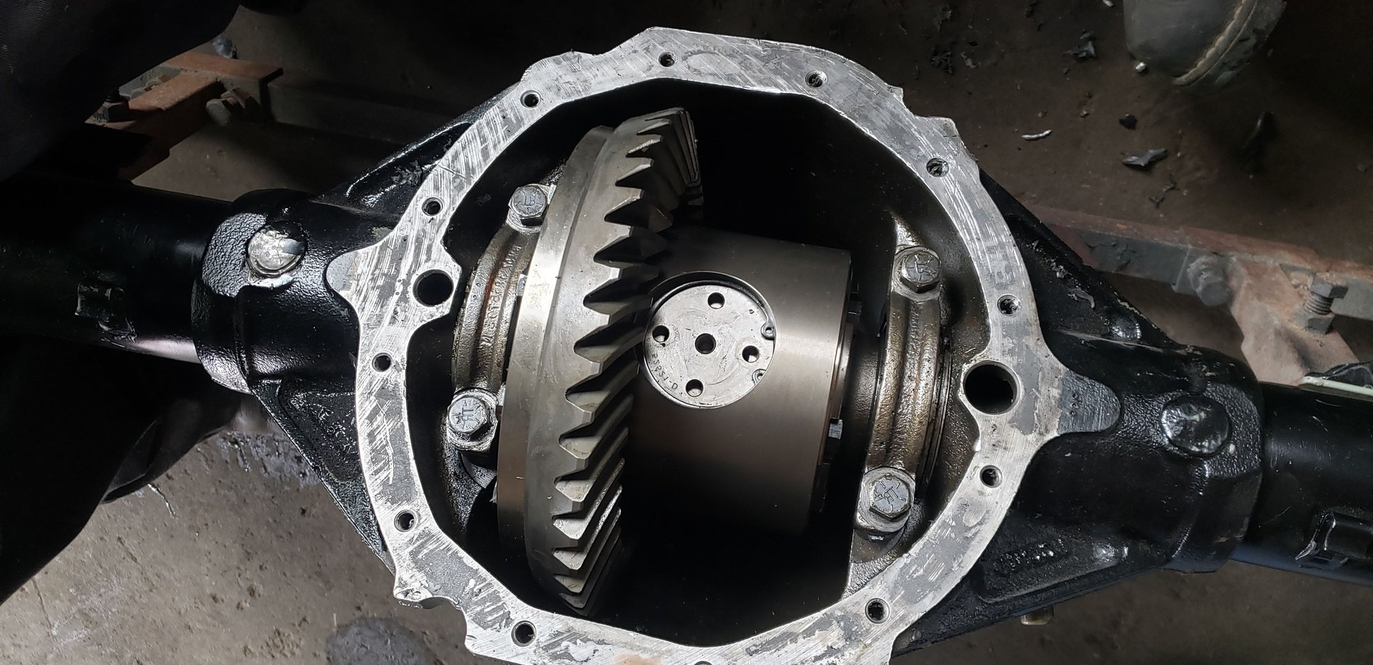

If you're wanting to cam it and make more power I'd consider swapping in a 12 bolt rather than doing anything with that 10 bolt.
Amen to that!!! 12 bolts rock, and every big block deserves one. I think I also remember you mentioning converting to a limited slip differential. I chose that route, and after a lot of research, went with Eaton's "Detroit Truetrac' unit. Spendy, but if you research how limited slips work, you will find that unlike most, this unit does NOT use clutches, or require special oil and maintenance. According to Eaton, it is also more effective in transferring torque to the wheel with the MOST traction. Be prepared to spend some money here. The result will look something like this:
Also, here is a link to a fairly good discussion about 12-bolts. https://www.chevydiy.com/camaro-diff...-step-by-step/
Good luck in any event. Regarding ratios, I chose to go the apparently less-than-popular route of 3.42 rather than more wheel-spinning ratios. With the rear tires I'll be using, this ratio results in around 3K RPMs at 70, and my 396 rebuild will give me substantial torque to overcome this rear-end ratio at an acceleration rate adequate to my tastes. I'm retired on a fixed income and can't afford to be replacing rear tires all the time... If my future years are similar to my past, a lot of miles will be spent on relatively straight roads at speed, while moments of back-road exhilaration will likely no longer be spent daring death to claim me...

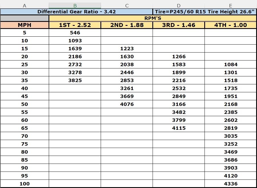

There are tools you can use to determine RPM's at the crankshaft for a given speed in mph. In order to use these tools, you will need to know some things. Specifically, you will need to know the gear ratio of each gear (or at least the final gear) of your transmission, the gear ratio of ring & pinion, and the diameter of your tires. Then, you can visit a site like this: https://purperformance.com/p-29669-rpm-calculator.html and plug in the numbers to determine velocity for any given gear and RPM. I used this and built a spreadsheet in MS Excel that looked like this for my 4-speed Muncie M20 wide-ratio:
If you don't know tire diameter, here's a good site to help: https://robrobinette.com/tire_diameter.htm
So, I used this to provide me with RPM's and made a choice between the two extremes of "burn rubber easily" and "reasonable RPM's at freeway speeds", and decided on 3.42 but also, my 396 makes good torque so I'm not as worried about acceleration from the line, plus, as I said above, I'm past the point in my life where I put myself in need of new rear tires on a regular basis, just to watch smoke happen.

thank you, this was very helpful! My rear tires are 255/60R15, so 27.1in Diameter. Playing around with your calculator has me 2nd guessing a few things…
I ordered the TKX 5speed with the following gear ratios 1st: 2.89, 2nd: 1.89, 3rd: 1.28, 4th: 1, 5th: .68.
They also have a version with a slightly more aggressive 1st and 2nd gear… 1st: 3.27, 2nd: 1.98, 3rd: 1.34, 4th: 1, 5th: .72.
If I go with 3.55 or 3.73 in the rear, the overdrive RPMs are pretty comparable, however, 1st and 2nd look like they could be a different animal. Is it going to be annoying redlining at 37 to 40mph out of 1st, 60 to 65mph in 2nd?
With the .68 overdrive version and 3.55 or 3.73 gears, calculator has me redlining 1st 40-45mph, and 2nd 65-67mph.
Given I’m only putting down 350-375hp, wondering if I go for the .72 overdrive version (assuming I can make the change since it doesn’t ship for a couple weeks).
With the .68 overdrive version and 3.55 or 3.73 gears, calculator has me redlining 1st 40-45mph, and 2nd 65-67mph.!
I have to confess I'm stumped. I have no insight into your driving style, but when I built my chart, my focus was NOT on redline RPM related to speed. I was more focused on shift points that I would use while driving normally, and also focused on freeway RPM's when going 70. I stayed with the Muncie so no overdrive, and I didn't want to be winding the revs for hours on end when driving a long distance, which does happen here on the left coast. Our states are BIG, as you well know. The alternative is to stop being in a hurry and just drive slower, but then you become a traffic impediment. I have been guilty of slowing down to check out some really cool old hotrod that was just chugging along on the freeway, and don't want that guy to be me. Of course, the other alternative is to stay off the freeways...
I charted both your rear-gear ratios, and found the exercise interesting. I don't tend to think about redlines that much because I am spending around $8500.00 on this engine, and while much of that money was to make it very stable at RPM (internally balanced, magnafluxed parts that were re-used, much is new, roller-rockers, etc), I have no desire to spend it again, and redliners tend to do that. Things happen really fast when you're blasting through the gears. While I personally consider 5500 RPM's to be a good rule for a 396, you can shoot right on by that when high on our favorite drug, adrenaline. Still, that's just me, and having scattered an engine once when I was young, I don't want to do that any more. Anyway, this is really your call, as only you know how you are likely to be driving. I predict I will be very happy at 3.42 with my healthy big block and wide-ratio M20.
I know I could build Ricky to go faster, but choose not to. I was visiting a friend down in San Ramon/Dublin, and he let me drive his very new very strong Corvette out on I-680, and when the way became clear, he suddenly told me "Floor it". It was an awesome moment in my life, because 100mph came and went while I was still trying to make sure we didn't hit the Jersey Barriers between north and south, and the sound... oh Lordy, the sound. At some point I remember thinking "how will I afford this ticket" but the interval from 'stomp' to 'let up' was incredibly short, and I came away from the experience realizing there IS such a thing as too much power. I guess that means I should not go into politics... Or make Ricky too strong. But have a good time with your restoration!!!
