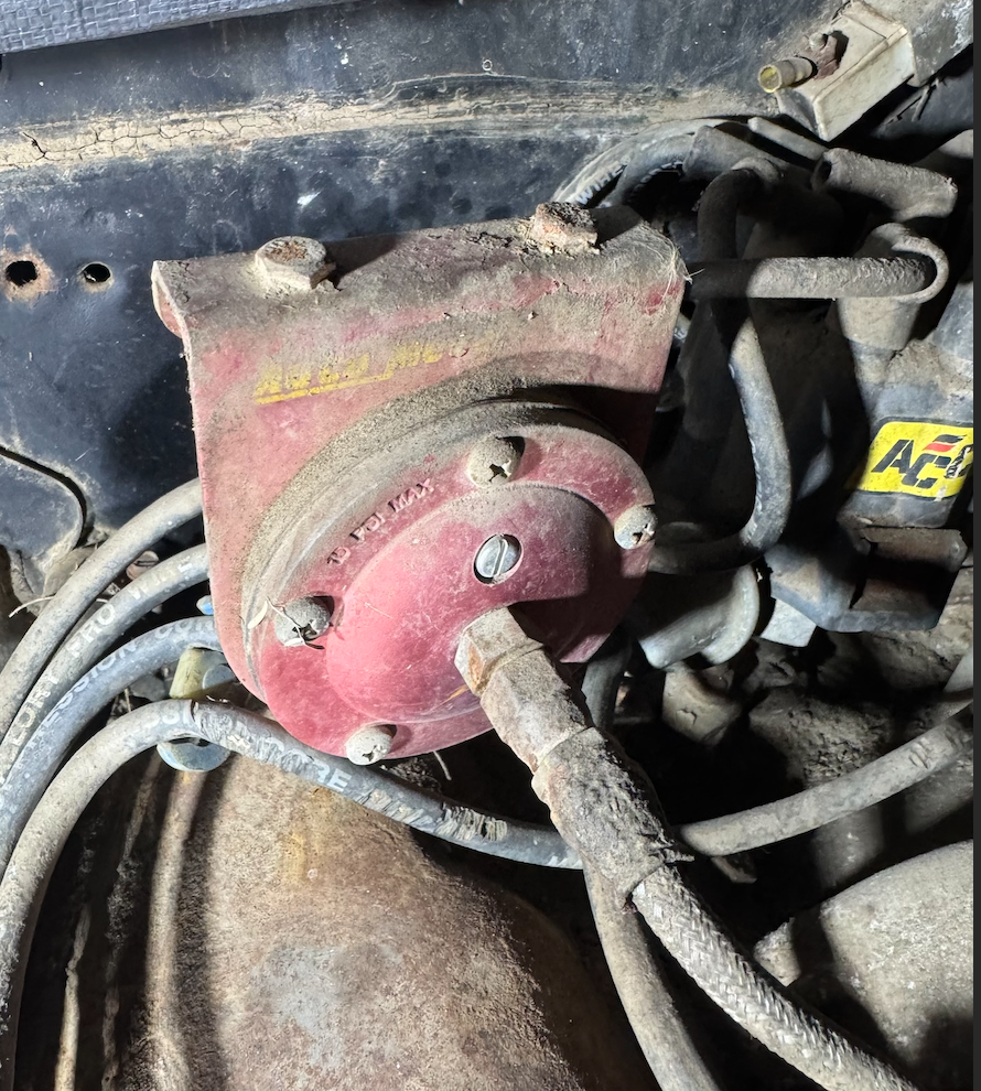

I also had a question about this part connected to the fuel pump. (attached below), is it related to fuel pressure?

Not sure on the fuel thing but it looks like maybe a pressure regulator for an electric fuel pump.
