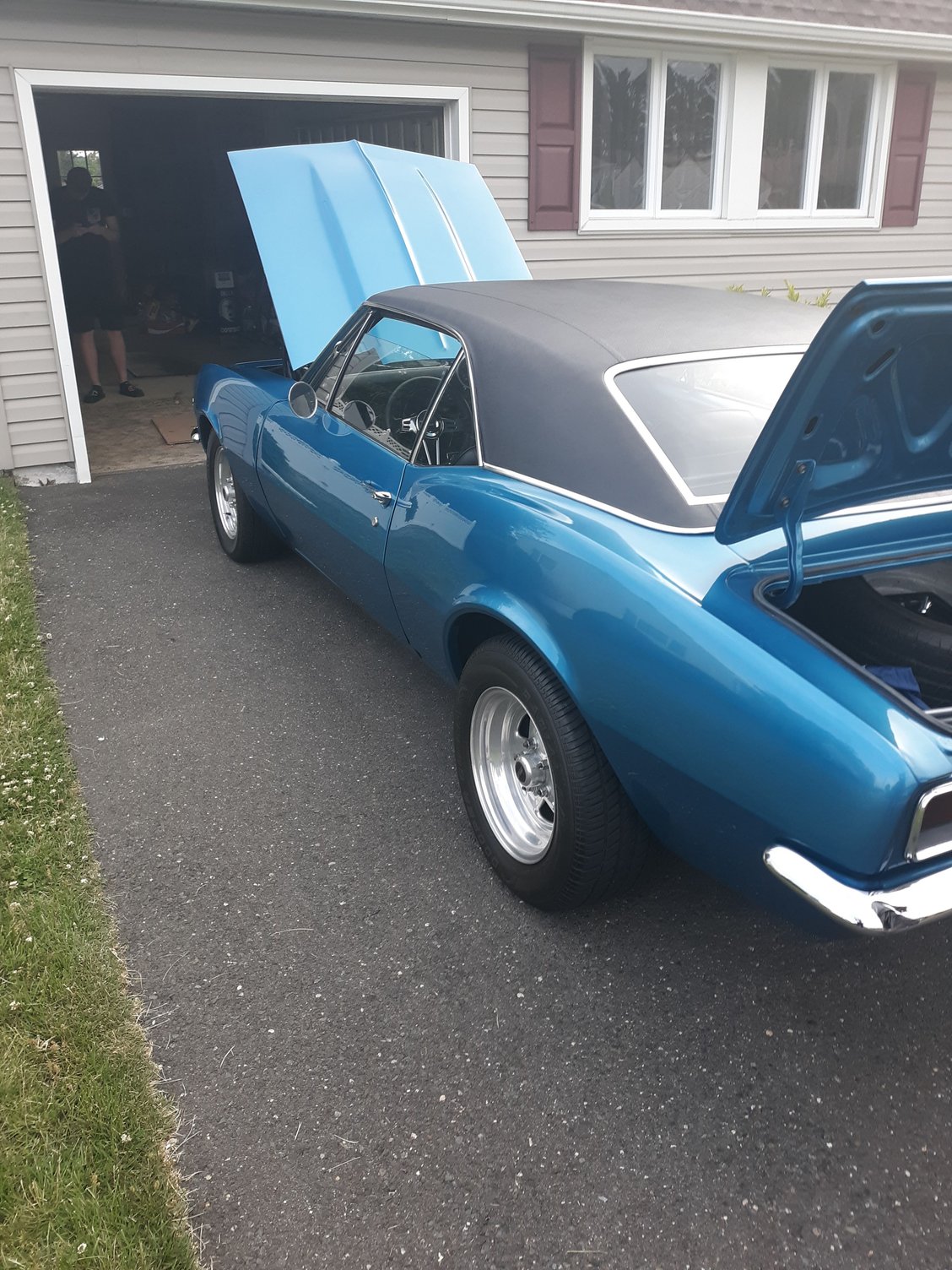

Bought a 67' camaro rs recently and seller listed as a 350 small block. Obviously not an orginal motor.
Looked up the stamps on the block.
Casting number is 3932388 which would be a 69' 350 small block.
However, right front block is marked as T0522HV which should be a 327 small block 1965 corvette engine produced in Tonawanda.
Anybody have a clue what I have here?
Thanks

I was looking at other information on the web today and it appears that almost 100% of the 1965 vette 327 blocks were made in flint Michigan. Tonawanda, however would sometimes support Flint. Being that and HV was produced in 1965, and with my casting numbers, I'm pretty sure it a 1969 350. Car is immaculate other than non matching motor. Painted Marina Blue which I used as my handle here. Lol....
