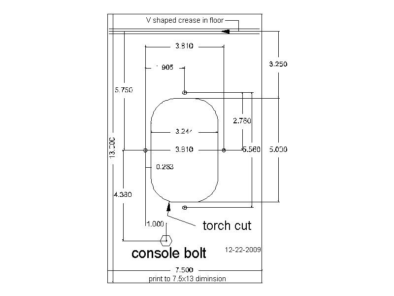

I am restoring a 69 SS Camaro and installed a new trans tunnel that doesn't have the hole located for the 4 speed shifter. I need the dimensions from the firewall or motor mounts to locate position. I am having a complete custom fiberglass interior kit designed for the car and will post pictures as we progress. Thanks in advance for the dimension help !!

Thanks for the quick response the schematic should be exactly what I need. I'll post pictures of the interior and console as they progress. Thanks again, very much appreciated.
