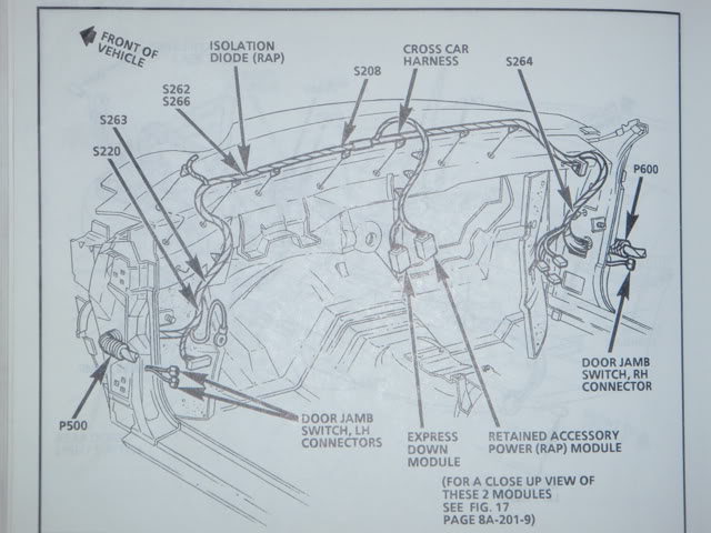

Has anyone found the RAP in another location on a 1994 Camaro other than the middle pocket under the dash (as seen in shbox.com)?

Old Jun 24, 2012 | 10:15 AM
Posts: 22,023

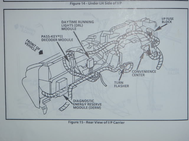

Old Jun 24, 2012 | 10:24 AM
Posts: 22,023

Thanks Craby, I appreciate the help.
That looks like it'd be right. He doesn't have power windows, so I don't expect to see the Express Down module. I'll pull the center console and see if I can look up under there to see if the RAP is near the center location. In looking up under from the drivers / passengers floor I can't see that it's hanging nor is it in the pocket.
