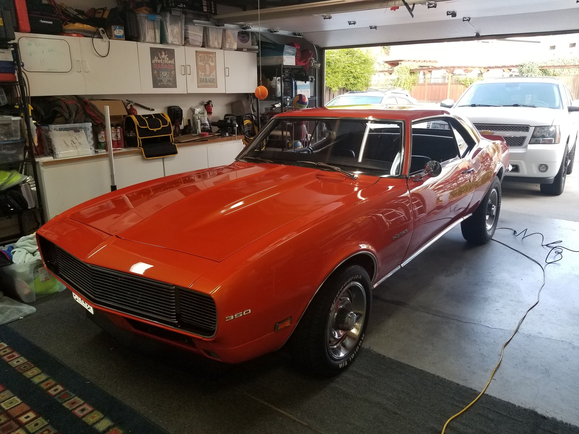

Looking good! I like your personalized black plate too. If it was mine, I would leave off the stripes below the rear spoiler on the back of the trunk lid. JM2C

[QUOTE=Jacouncil3;730946]I finally completed the vinyl stripes, looks good but not perfect.
How did you do the vinyl strip on the cowl with the vents? ]
Old Jul 7, 2024 | 10:10 AM
LastRS's Avatar
Joined: Nov 2019
Posts: 75
From: Victoria, BC
Once you get the body prepped properly, use painters tape to reference where you want the stripes (on the outside) then lay the stripes down wet so you can move them and squeegee out. Remove the painters tape and you are done.
