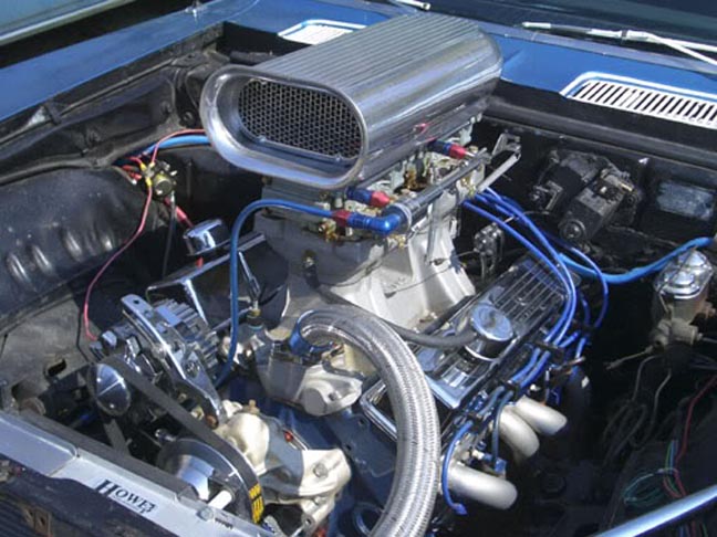

Gee I dunno, what kind of a nut runs 2 carbs?
Keep in mind, if you're almost lost with the concept of tuning one carb, two of them are going to make it three times as hard on you.
With that said, nothing beats the "ooh" factor when you open the hood, or in my case leave it open! I think you know my answer.

Didn't mean to mislead you Gorn, I threw mine out there for the fun of it. I'm sure he's looking at either the Offy 5253 low profile dual quad, or the 5694 high rise (not ram). Both are a divided single plane style. Not quite as good for bottom end as a dual plane, but not nearly as hi-rpm thirsty as my tunnel ram is.
Old Feb 22, 2013 | 02:15 PM
Oh yeah, watch your distributor clearance with that dual quad setup. Pretty sure the rear carb isn't going to clear an HEI.
